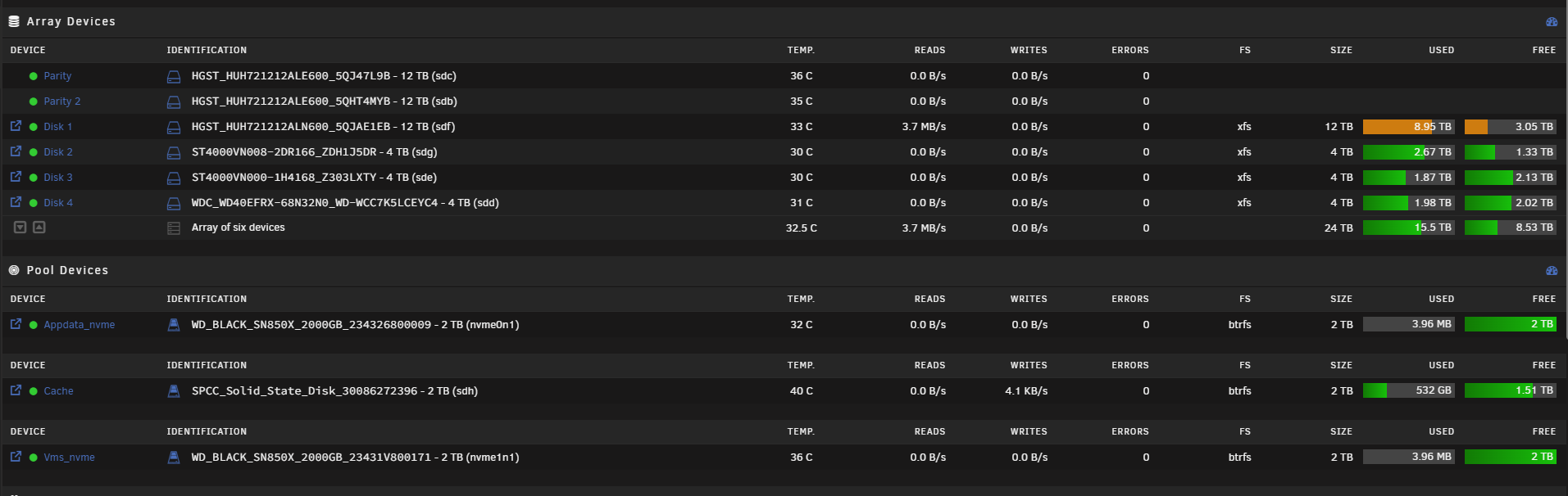

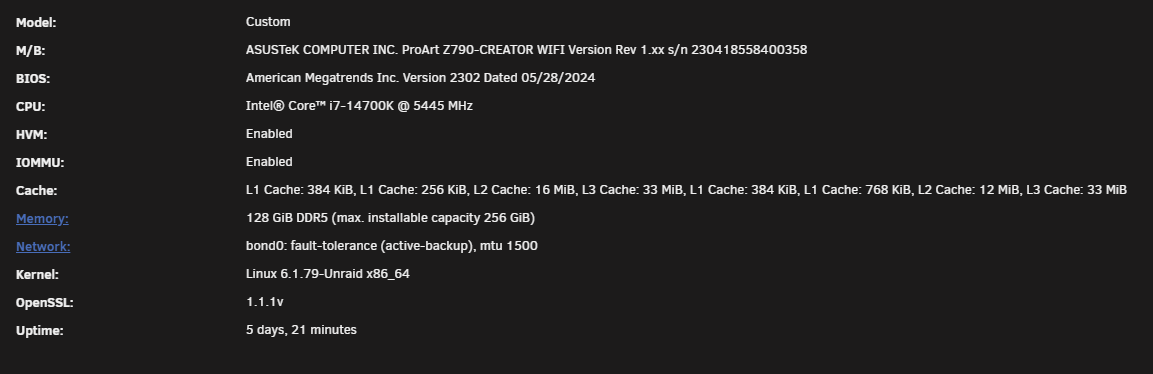

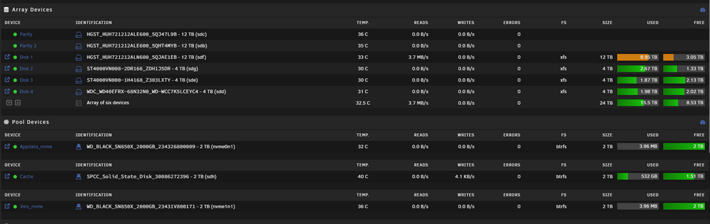

July 2, 20242 yr I have my server setup following SpaceInvaderOnes guides, I created a cache pool for my Appdata on an NVMe drive and for my VMs on an NVMe drive. This worked for awhile but I started notcing that my VM would stop running (go into the paused state) randomly, and then I would have to force stop the VM in order to start it back up. Occasionally I would also see that my docker images would stop working and it would lock up Unraid entirely and I would be forced to restart manually. I have tried unplugging and reseatting each of the NVMe drives with no luck, I recently moved all of the data off of those drives, and onto a standard cache SSD that I was using for my downloads share, and everything seems to be functioning normally again. Before I remove the drives, is there anything I could do to remedy the issue, or troubleshoot the issue? My build is as follows: Unraid 6.12.10 Any help would be greatly appreciated.

July 8, 20242 yr Author I performed a bios update, and moved the data back onto the drives, no issues for almost a week. Thank you for all of your help.
