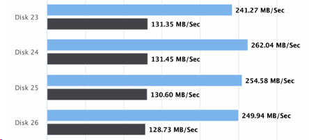

Disks 23 to 26 as well as your cache are significantly slower.
Is there something specific / different for those drives ?
These disks are bottlenecking when accessed simultaneously:
And looking and the diags, they appear to be connected to a second expander, please detail how the disk are connected in the enclosure(s)
I noticed the same thing too.   At first I thought - "oh these are the drives located on the back side of my Supermicro SC847 server case."   But the disk numbers from speeddisk do not correspond with the Drive numbers of my array.
I am trying to figure out my Drive Number vs Port Number vs Disk Number in Speed Disk.  I don't think they are the same.
