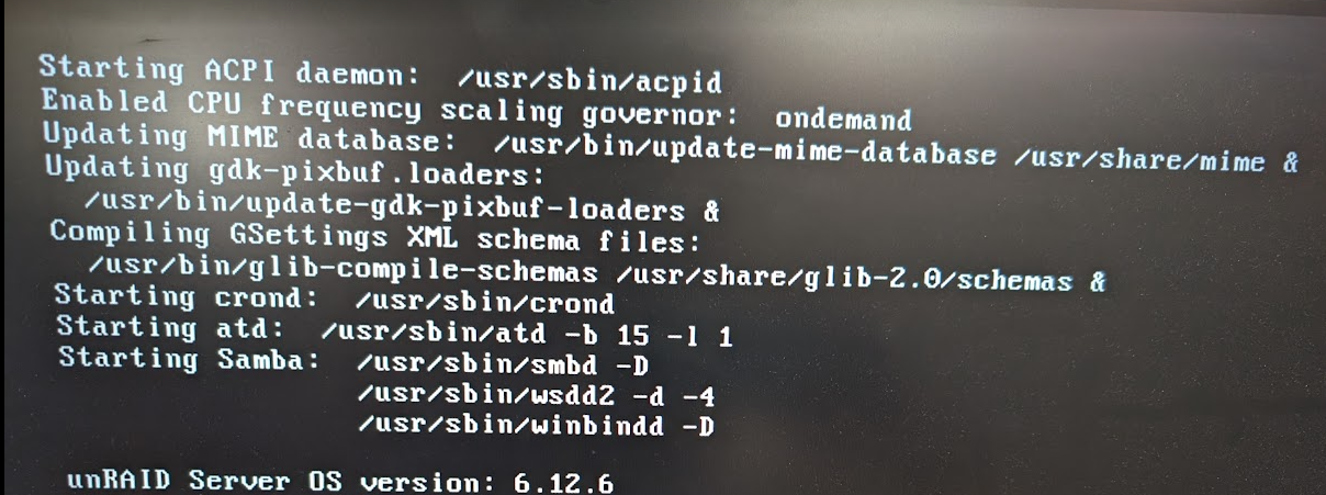

Do you have an attached monitor and keyboard?
I can attach a keyboard.  I have a monitor attached, but I have yet to see an interface.
Ok....I found a command line...

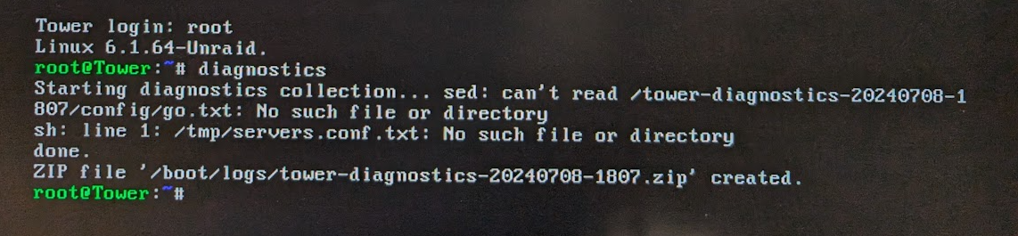

New Information
Edit - Attaching Syslog.
syslog.txt
Edited by Khadaji
Attaching Syslog

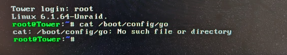

Diags are incomplete, you may be missing some files, post the output of:
cat /boot/config/go

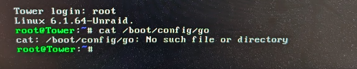

cat /boot/config/go
You are missing some files, including the go file, and the GUI won't start without it, if you have a recent flash backup restore it, if not, you will need to recreate it, then copy the setting you do have.
