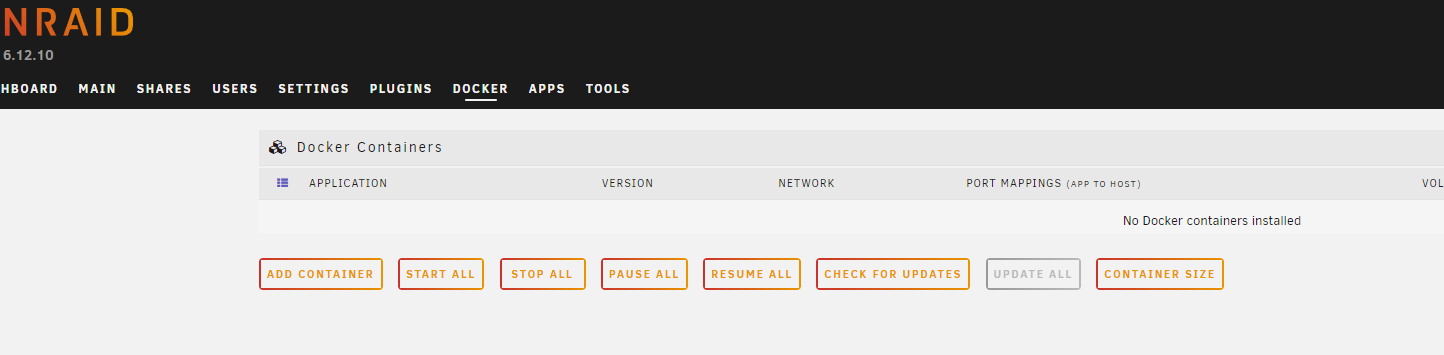

New Problem: Docker containers gone
Now I have no docker containers. (If I reboot, what will I be missing after the next reboot?
Today's Diagnostics are attached.
tower-diagnostics-20240711-2038.zip

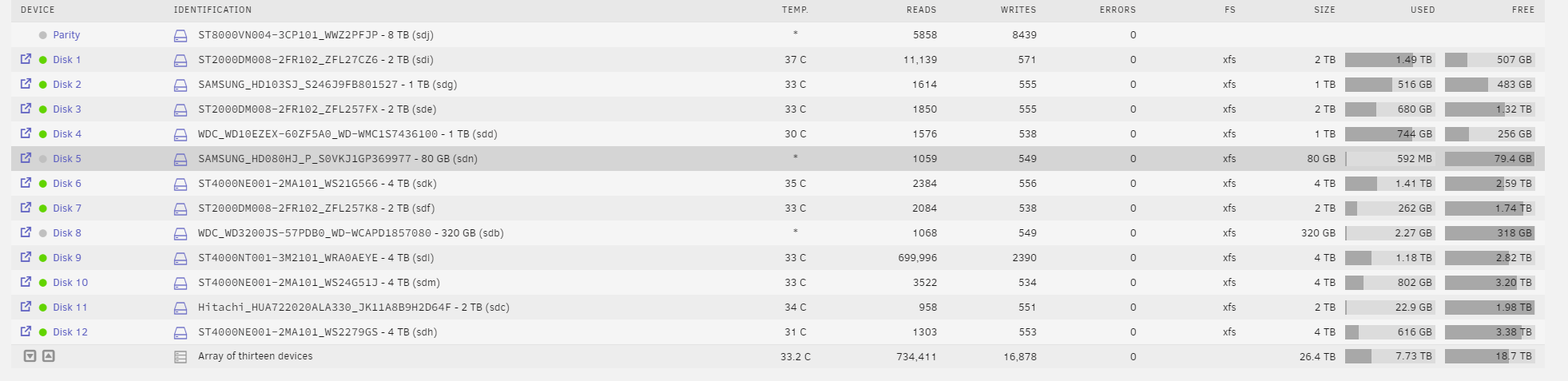

Most of you disks are far from full, including disks 5, 8 and 11 which are completely empty, is that expected?
JorgeB Is your implication that files may be deleted as opposed to being lost?
I do not remember my pre-incident drive consumption very well.
Drives 5, 8, and 11 are currently the least used in the array. Drives 5, 8, 11 are the oldest and generally smallest.
It's a possibility, search for a file or folder name, that should confirm
