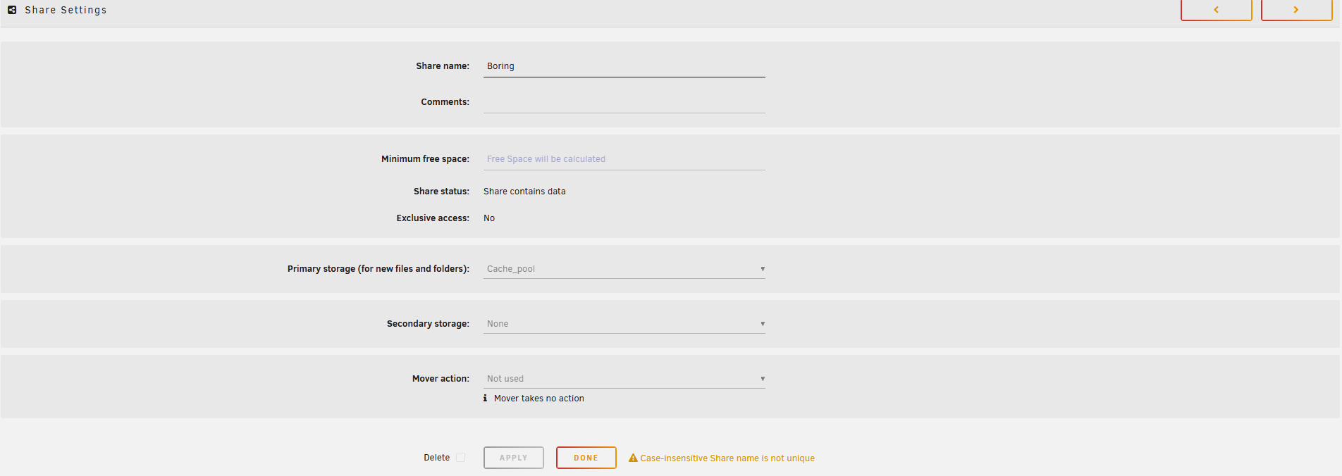

unRAID ver 7.3.2 Following migration from cache drive "cache" to cache pool "cache_pool" , Fix Common Problems reports... Fix Common Problems reports Warnings Found Suggested Fix Share Boring references non existent pool cache If you have renamed a pool this will have to be adjusted in the share's settings More InformationIn the share settings... Share Settings Share name: Boring Comments: Minimum free space: Free Space will be calculated Share status: Share contains data Exclusive access: No Primary storage (for new files and folders): Cache_pool Secondary storage: None Mover action: Not used Case-insensitive Share name is not uniqueNote that the drop-down boxes in the share settings are greyed out. See image. In the list of my shares, I do see "Boring" (capitalized) but I do not see "boring" I am having Docker issues as well but I posted that in a separate thread. https://forums.unraid.net/topic/200688-appdata-share-deleted-docker-service-failed-to-start-following-migration-to-cache-pool/ Diagnostics attached. tower-diagnostics-20260925-1323.zip
