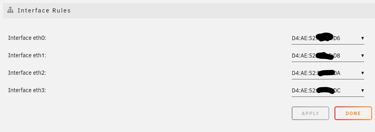

July 14, 20242 yr Author Community Expert 43 minutes ago, itimpi said: you need to set another LAN card as eth0. How would one do this? As my cards arnt connected (no cable connected) but its showing as Eth0 and I cant see any settings to switch them or change the mapping? Or would that be this section here? Also I would guess making this change would kill my connection I assume i should make these changes on the terminal? Can you start the GUI from the CLI in the terminal or does it need a reboot?
July 14, 20242 yr Community Expert 20 minutes ago, brent3000 said: Or would that be this section here? Yes, set the NIC you want as main to eth0, note that you have to reboot for the changes to take effect.
