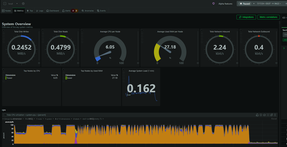

This has happened for a few nights now. My room is slightly warm and I am running an old AMD X2 that has does have heat issues when two or more people are streaming plex, or when streaming plex and transferring a large amount of files to Unraid.

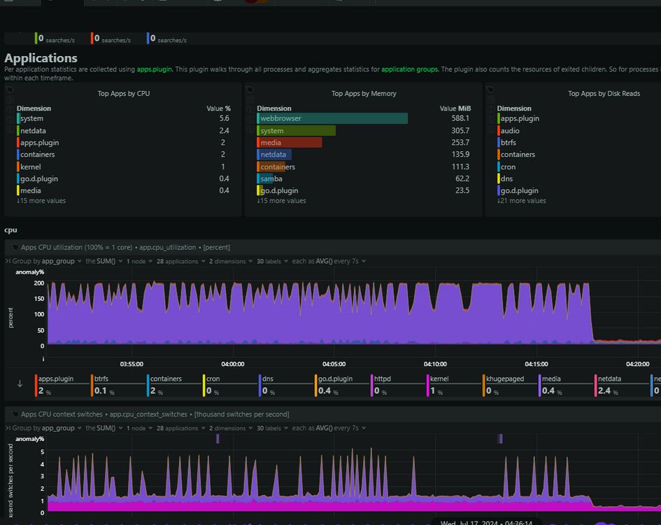

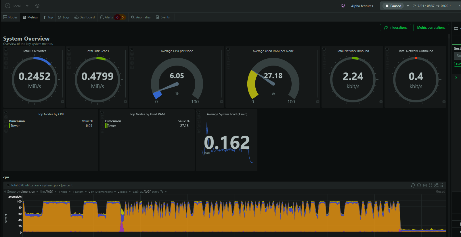

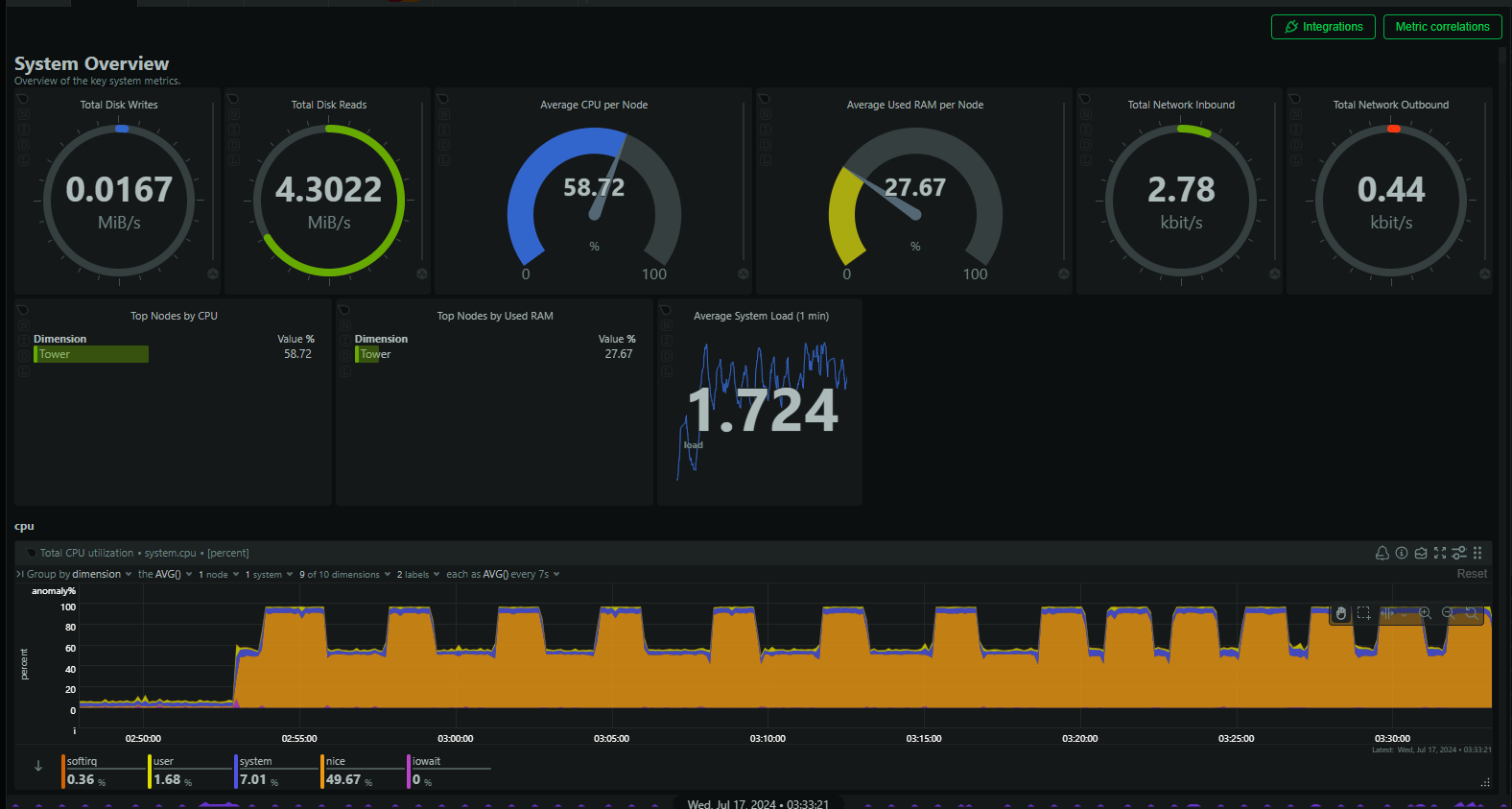

That being said, why is this 2am 100% cpu happening now? Three nights in the past 7 days. I have checked netdata and it states that the 'nice' process is running at 95%. Having troubles determining what this 'nice' process/dimension is. It's not being very nice.
system.softriqs also had a high usage of one dimension at that time, called 'RCU'
Network inbound/outbound was minimal, in the 10-15kbps range.
Disk reads were a little strange. Oscillating between 0MBps - 4.5MBps
I also checked 'plex activity' in the gui and no user attempted to reach the server

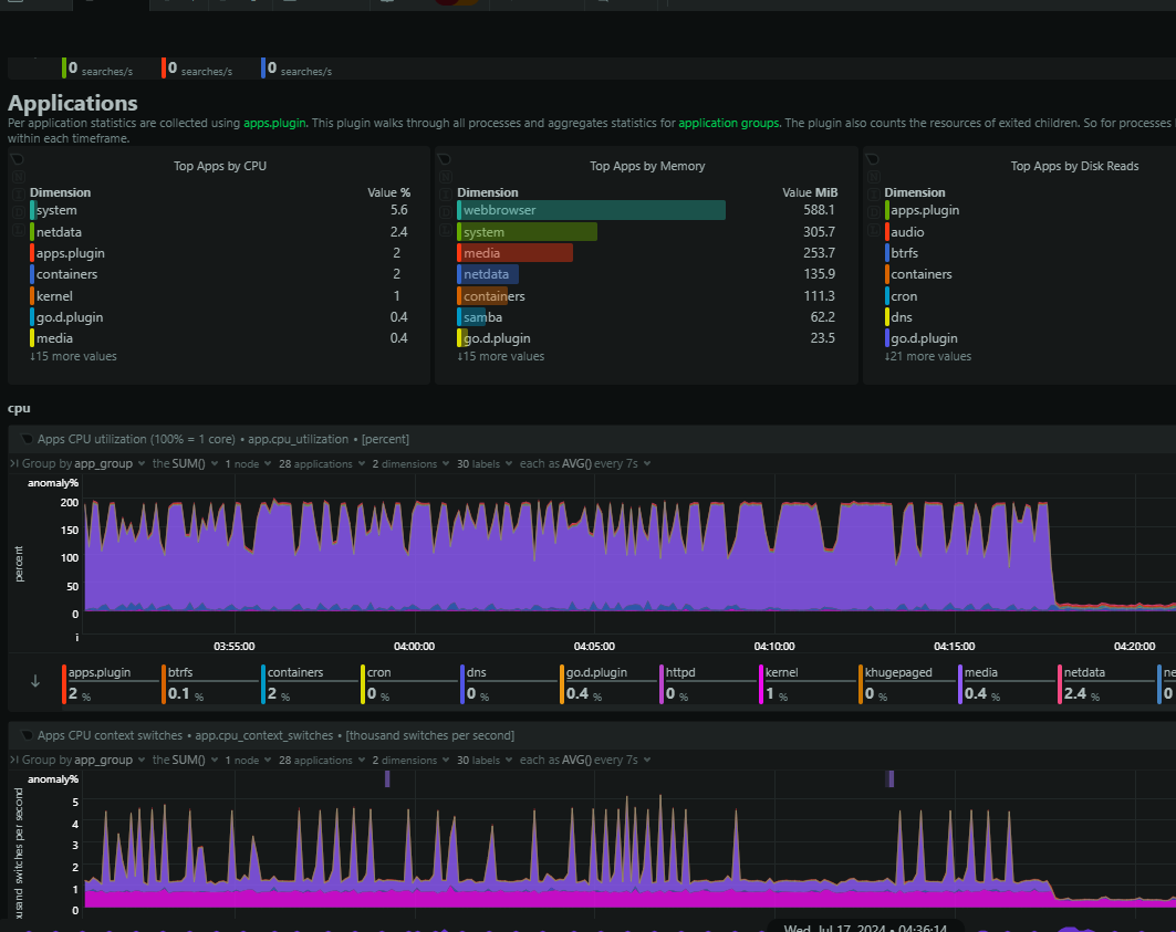

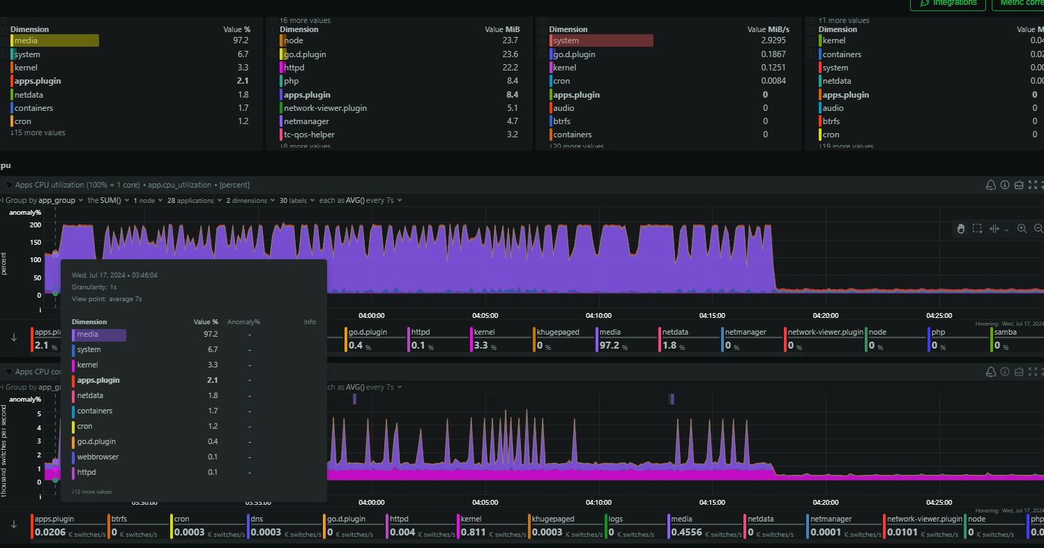

Application found! Wtf is Media? Also, the user 'nobody' was running at 90% during this time as well, I assume Media is owned by Nobody
How do I know what 'Media' did and why?

pictures and new evidence
Something in the scheduler?
"nice" is not actually a real command, just a starter shell that modifies the task priority and launches the real job.
So you need to find out what process is started from nice.

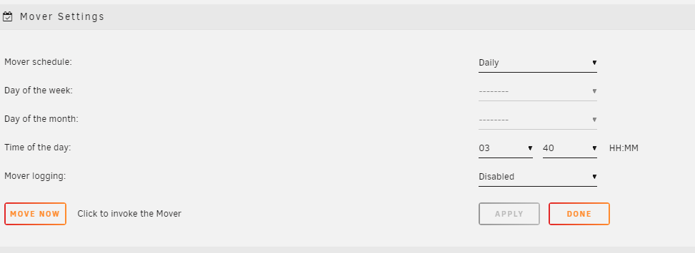

I just edited my post but also checked the scheduler.
There is a mover, which I don't know what it is or why it's there but the time does not add up. My high CPU started at 2:53 but this scheduler is set for 3:40
Edited by sanfark
If it's happening at the same time daily, that makes me think some sort of scheduled event.  If not scheduler, perhaps a script, or something within a docker container or a vm.

Well, it happened again last night. Woke me up at 4am with cpu heat alarm going off. I logged onto the server and found Plex was detecting intros to a library! I restarted the plex service to stop it. Not sure why it's doing that every night though.

I am curious as to why Plex was 'detecting intros' in the middle of the night. This does not seem normal to me and come to think of it, this has happened a year or two ago as well and just stopped.
Im surprised as to why the alarm is set on something so low as 60 degrees
Well, usually you do maintenance at night cause, the typical human being tends to sleep at that time and thus does not interrupt any playback that happens during the day. Just disable the shedule in plex and youre good, lol
I didn't realize there was a plex maintenance at night that scans your libraries. I never set that. Will dig into the settings and find it. TY.
