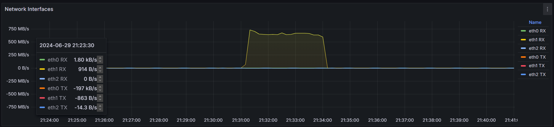

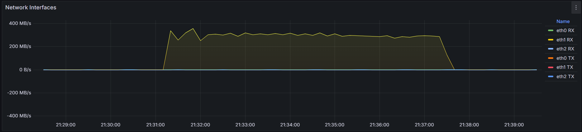

July 29, 20242 yr Hello. After an update to the 6.12.11 I got an issue with slow SMB share speeds. For example, I have a nightly backup of my Windows VM, it's about 100 gigabytes. On the 6.12.10 it took about 4 mins every night but after an update it always took 7-8 mins. Which a lot slower than before (NVMe to the NVMe transfer, 10G network). Average speed is about 300 mb/sec, before it was 600+ mb/sec. I had this issue on the 6.12.9 as far as I remember, but after an update to the 6.12.10 it got resolved somehow. Any ideas why this is happening? No hardware or software, network, etc configuration update was made. Iperf3 result is 9.4G in both directions. Here is the network graph on the 6.12.11: Graph on the 6.12.10: Edited July 29, 20242 yr by SuberSeb

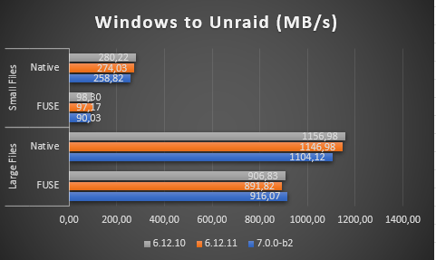

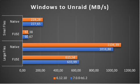

July 29, 20242 yr Community Expert With the beta I did test, vs 6.12.10 which was the most recent v.612 release at the time, and didn't find any significant difference:
July 29, 20242 yr 17 minutes ago, JorgeB said: With the beta I did test, vs 6.12.10 which was the most recent v.612 release at the time, and didn't find any significant difference: That's promising, shows it just my config that might have a small hiccup somewhere.
August 3, 20242 yr Community Expert As promised, I'm now back home, ran some tests and I don't find any significant different in SMB speeds for 6.12.11: Which NICs are you using? I have Mellanox COnnectX-2, 3 and 4 P.S. I redid all the tests, to also include the new beta and to make sure they were all done using the same devices/settings.
