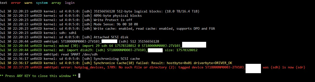

Here is a new one. The start of the array just kept spinning at starting so after a while i had to reload the interface... "SDH", "SDI" stayed offline so this does not feel great..
Edited by DigitalLF

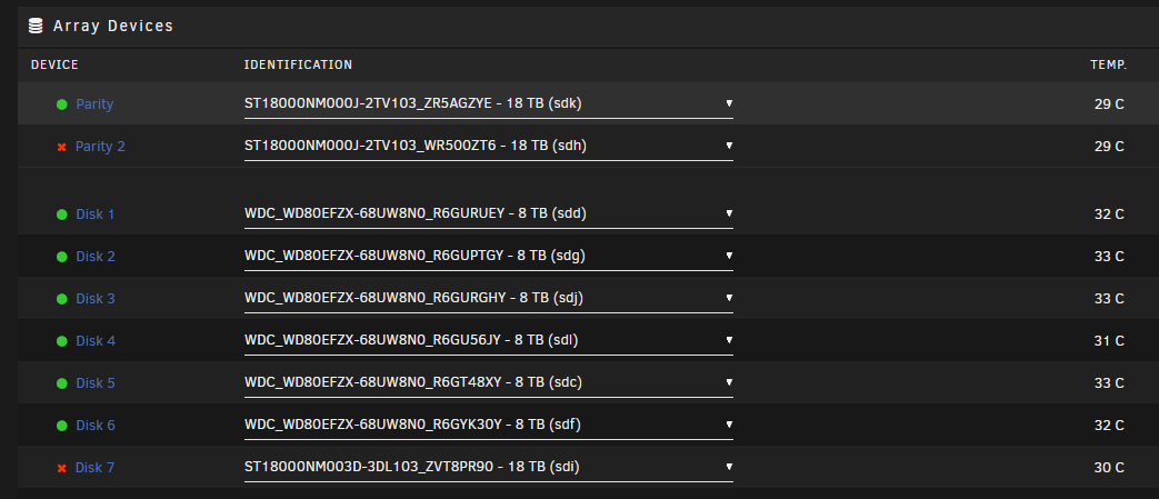

I don't seen any errors in the syslog, you now have two disabled disks but that was expected, post a screenshot of main.

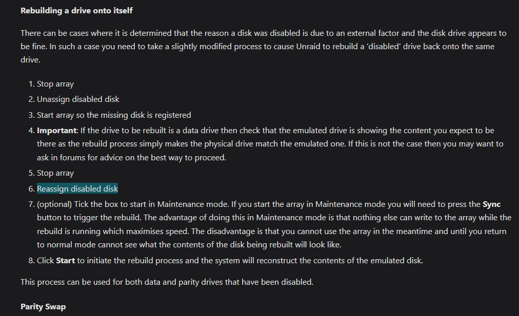

2 hours ago, JorgeB said:
Yep, same as they being currently disabled.
And here in Step 6 should i reselect both the data drive and the parity drive?
Yes, you can do both at the same time, since they are already disabled there's no extra risk.

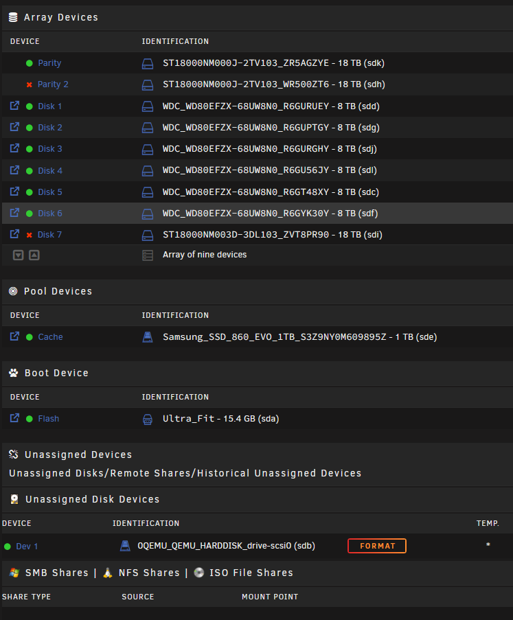

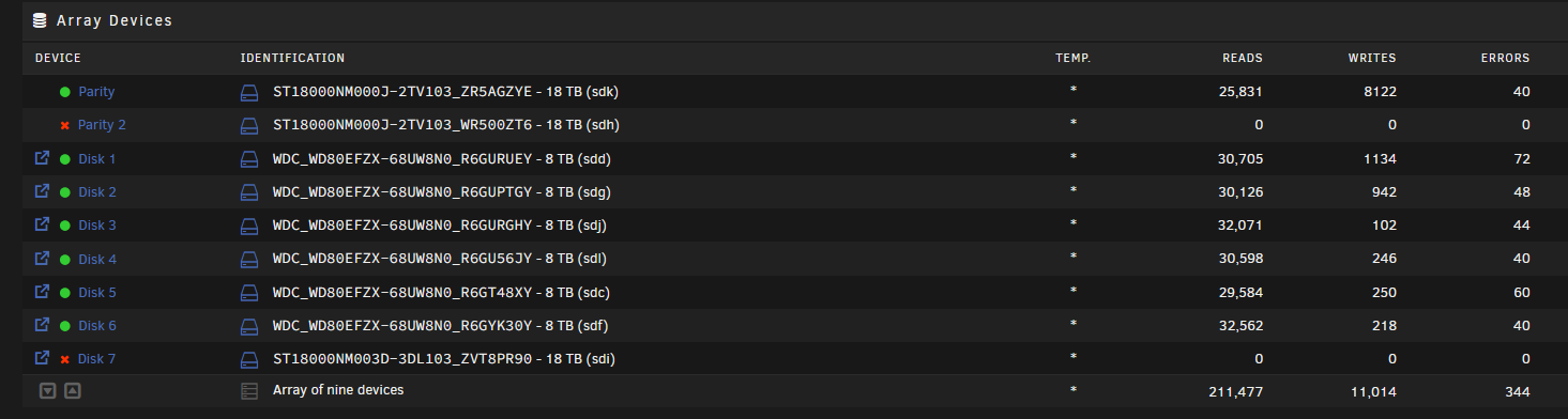

While just browsing the array now i get more error emails sure its just 8 errors so far but something is bad... should i buy breakout cables and try without backplane? Any thoughts on what the next step would be?
Edited by DigitalLF
I don't see errors in the diags, but probably the same issue, but disk7 ws still mounting, which is good.
It's worth a try, and I think there's no point in trying again without changing something.
Good to hear! just while typing the last thing i wrote errors per drive increase by hundreds.. You can see it in the screenshot..
I will order 2x CBL-SAST-0948 cables to try to see if it is the backplane or what..
