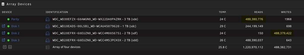

I confirmed that LOTS of writes to the disk in question were being performed, and I thought I was off to the races.
I monitored it for a few minutes, and I started to get hot all of a sudden when I noticed that although there were lots of writes, the disk wasn't getting any fuller.
Be patient, the UI just might not be a proper reflection of things.
Next morning... my disk usage is the same as it was when the rebuild started (despite the writes) and I seem to have lost all the data that was on the disk.
