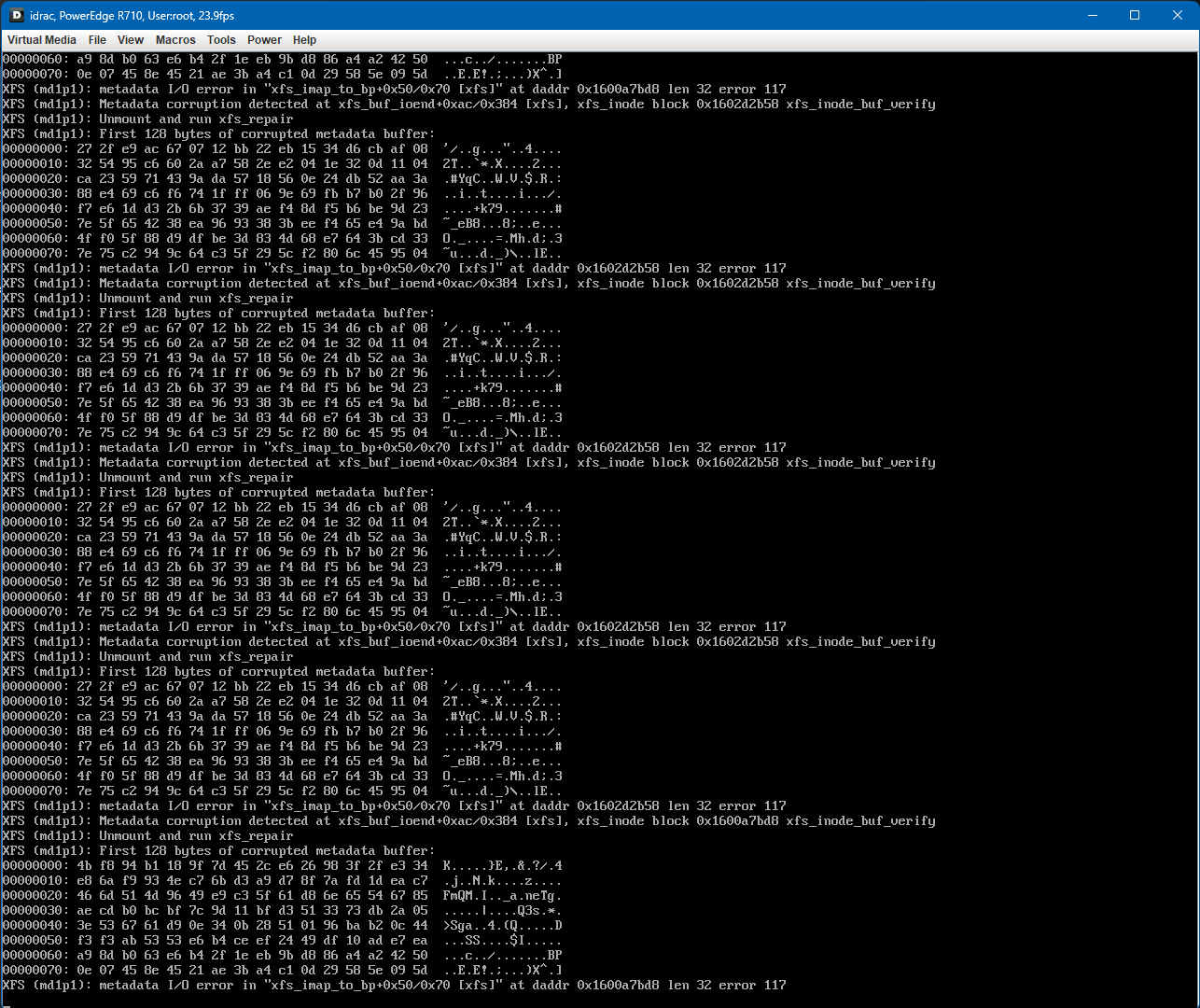

I have been struggling with this for a while now, and am finally doing the last resort... actually asking for help.

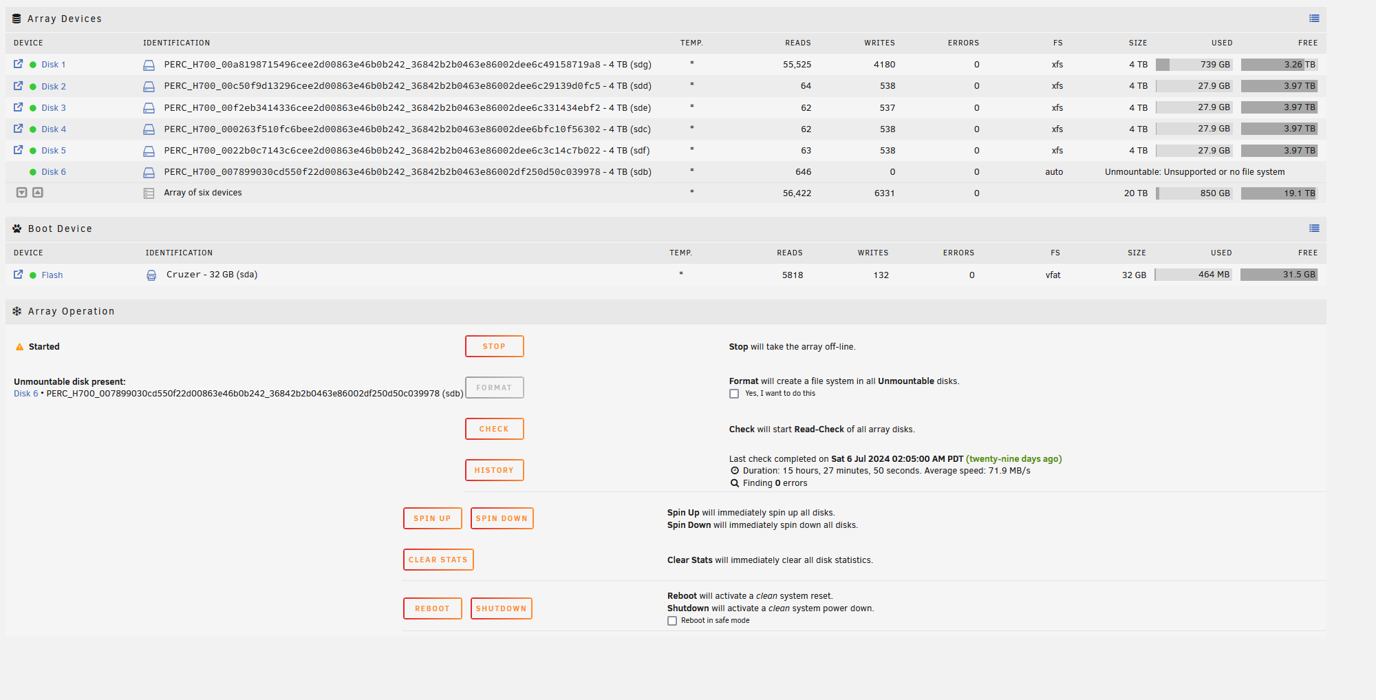

Whenever I try to access the data in a folder I have, I get this in my server's console. The array has been unprotected because I haven't for the life of me been able to get parity working, and every time I try to do a SMART check (I'm probably doing it wrong, would love some direction) it doesn't work.
Here is what I'm looking at in my array:
The amount of data that's "used" matches up with what I'm missing. To be honest, I'm very new to NASes and RAID in general. Servers I have a bit of knowhow on, though. Would love some input on this...
If you need me to upload any logs or anything let me know! I want my data back and this thing to be protected :D
Solved by JorgeB
I should note that before taking this screenshot I moved the parity disk (that was disabled and couldn't be enabled) into the disks, that's why it says unmountable.

It may just be a filesystem issue, though like mentioned RAID controllers are not recommend, but check filesystem on disk1, run it without -n
THANK YOU!! I thought it was all gone because I put all my eggs in one basket... I won't do that again. As for the RAID controller, I'll get a software specific one that can go into IT mode, because I still want to have the server in a rack configuration. Thank you, again.
