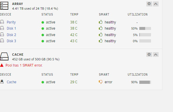

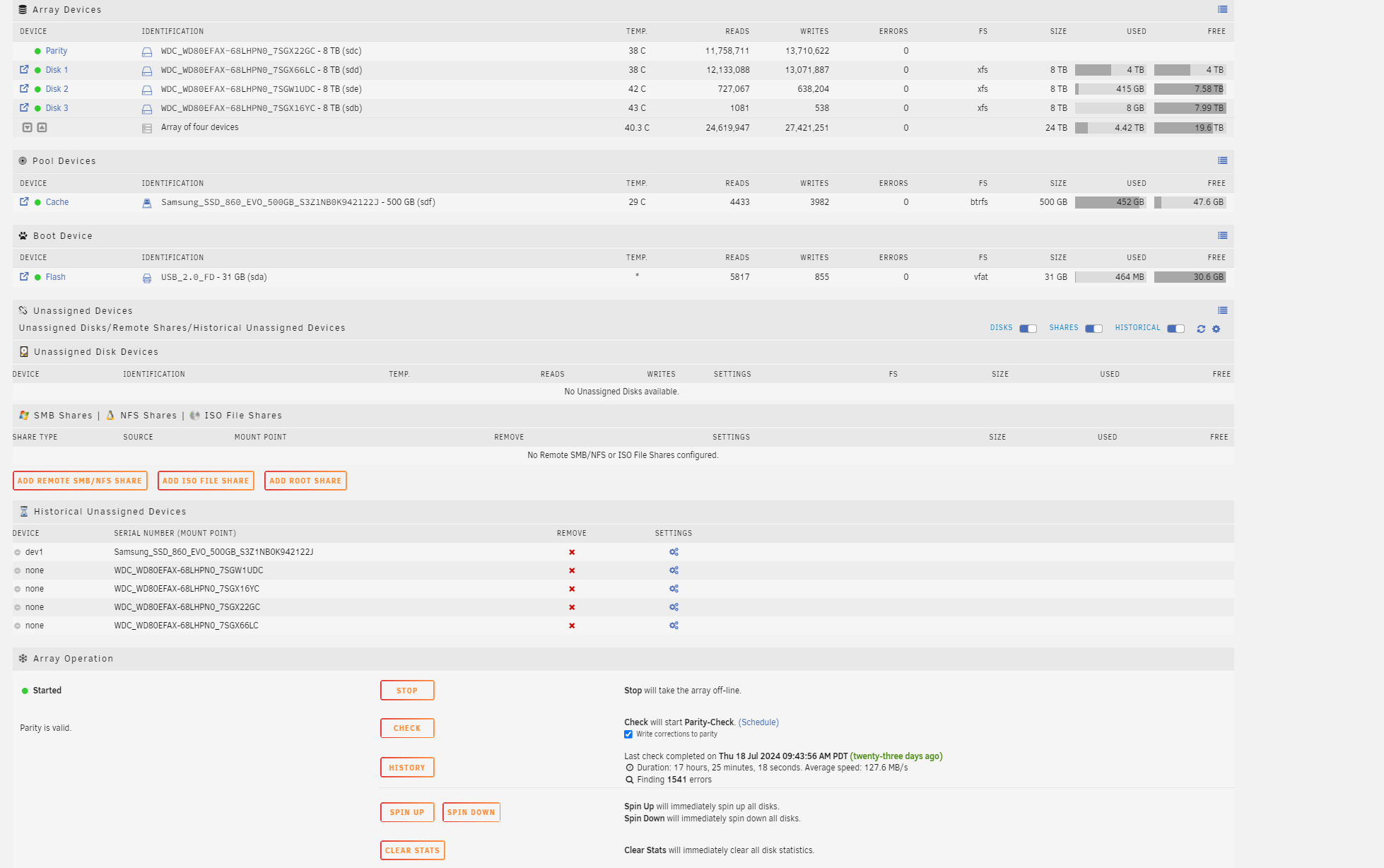

I use unraid but I am absolutely no expert.  Recently my USB corrupted so I had to replace.  Now I see on my main share the following.  I am worried about errors.

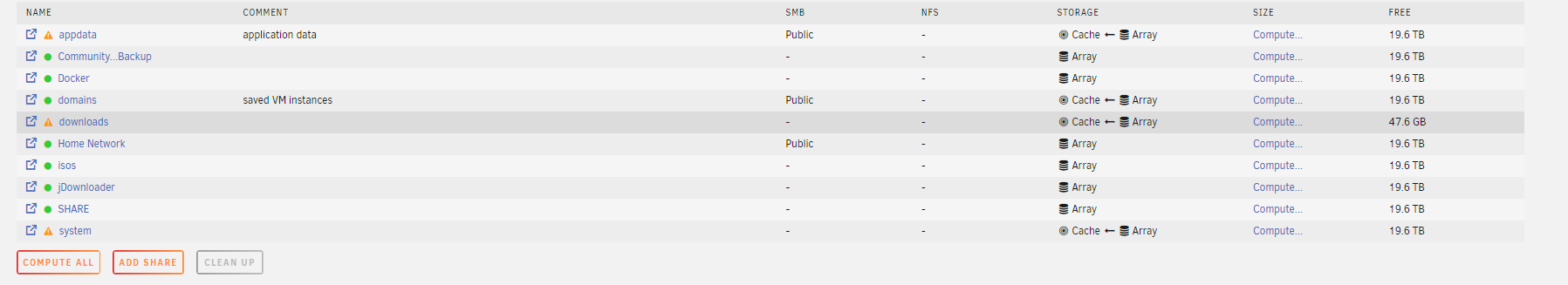

I know my cache drive looks almost full.  I think I have some old stuff writing to there I need to move that I stored in App Data (2nd screen shot plz let me know if that looks wrong).
For the errors how would I stop getting errors?/  Is a drive going bad?
Is my cache causing the errors???/  My log is full of Cache is full entries and this:  Aug 10 04:50:01 Tower rsyslogd: [origin software="rsyslogd" swVersion="8.2102.0" x-pid="817" x-info="https://www.rsyslog.com"] rsyslogd was HUPed

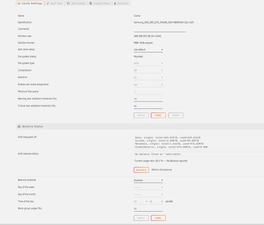

Ahhhhhh.... Is this the issue/

You should post your system's diagnostics zip file in your next post in this thread to get more informed feedback.  It is always a good idea to post this if your question might involve us seeing how you have things set up or to look at recent logs.
attached
I can't figure out what is using all that space either.  Maybe the casche drive is stgraight busted??
It looks as if the 'appdata' share is using up that space - is it too big to fit onto the 'cache' pool?

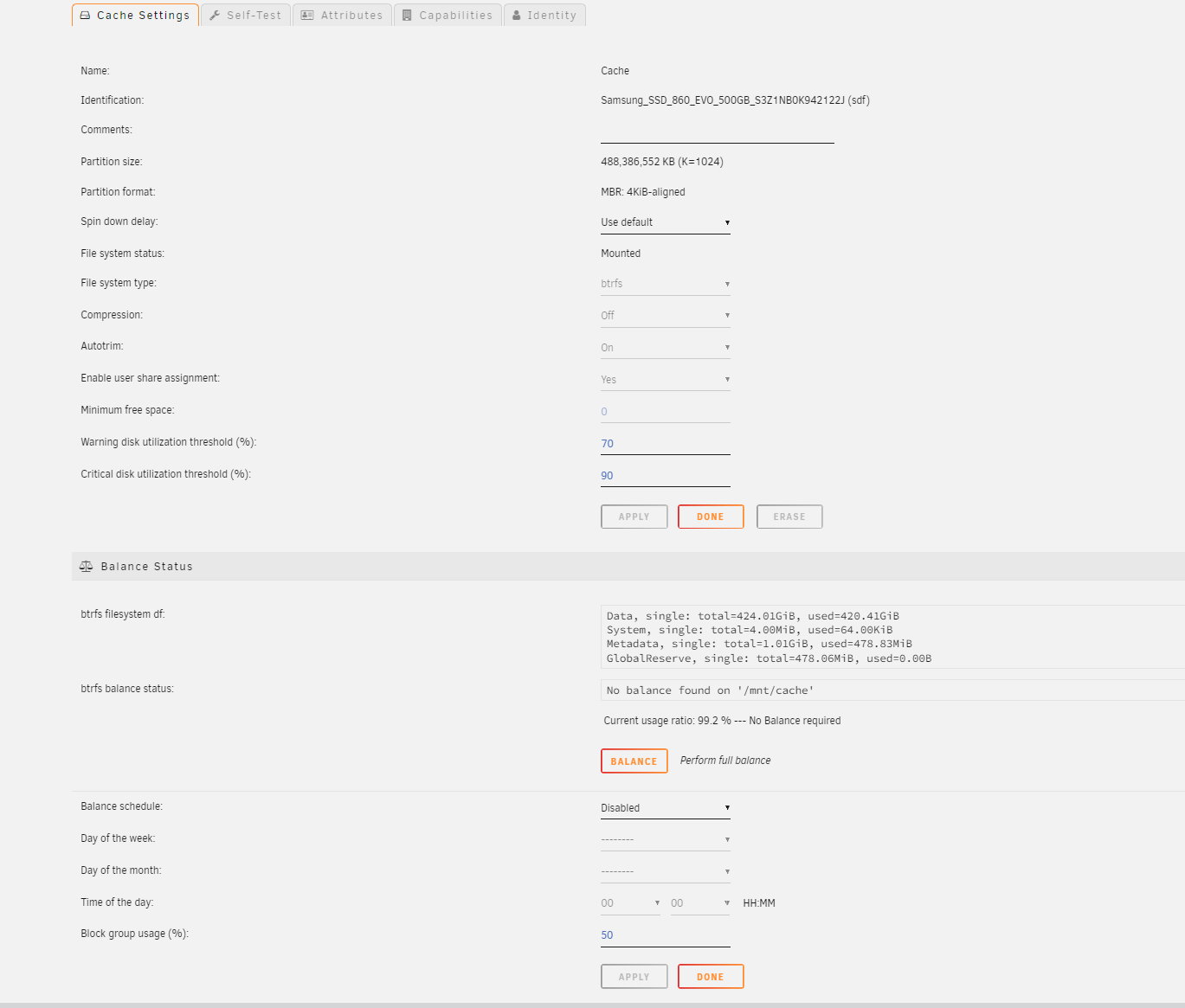

You should also set a Minimum Free Space for the pool to avoid it filling up too far (at the moment you have this set to 0).   This should be set to be larger than the biggest file you expect to be cached.

Yep I did that.  there is 50gb free but it will hit up against that limit.  If I have a smart error on the cache should I just replace it?  Maybe that is where all myt errors are coming from?
As always thank you so much in advance.
Weird I thought I set it to 50 and it is hard coded to "0" and I can't edit it.
