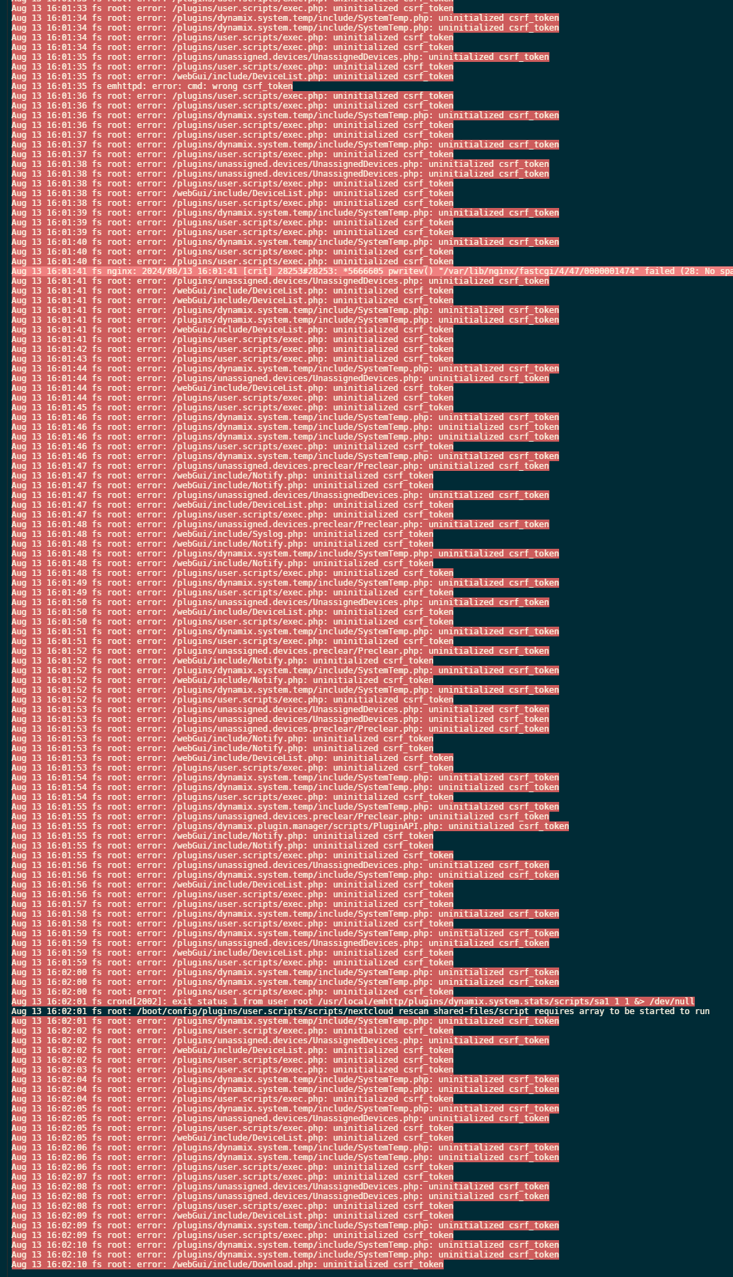

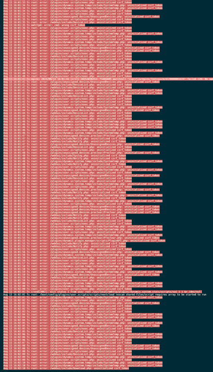

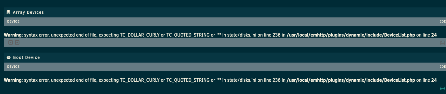

Just went to get a drink and when I get back it says array offline and undefined. wtf is going on?!
I can't view diagnostics or normal system log. I can still see files via ssh but it says the array isn't started.
In ssh I get this error all the time:
_zshz_update_datafile:print:57: write error: no space left on device
Edited by cinereus
Is it something to do with the dropbox mount? Or rootfs being 100%
Edited by cinereus

rootfs is full, reboot to fix it, but if it happens again you need to find out what is causing it.
