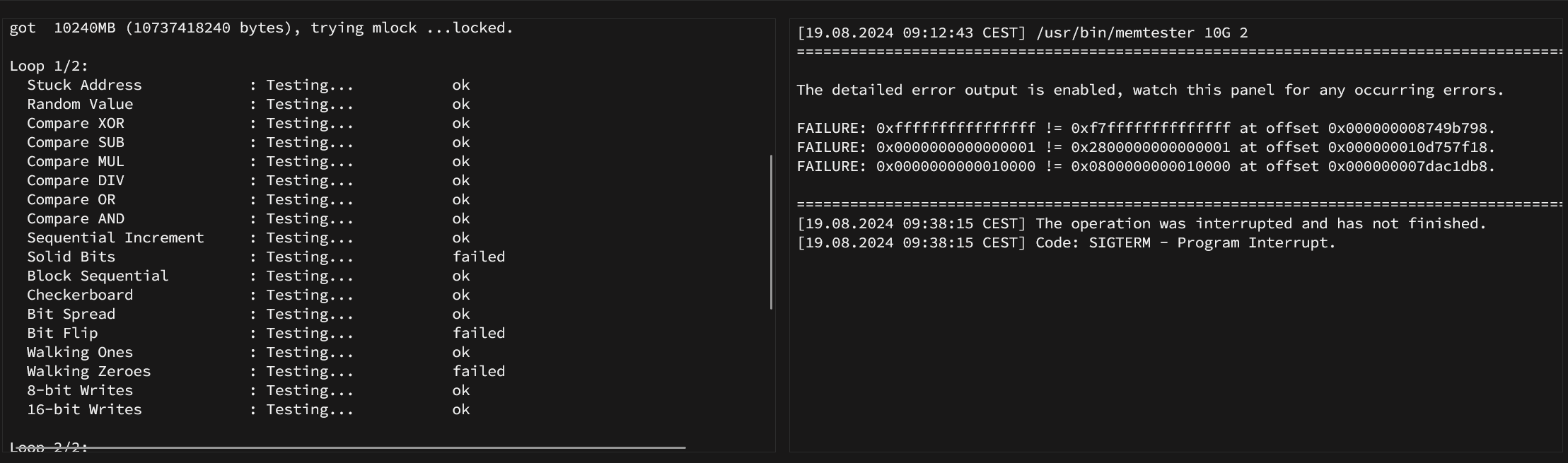

I will not have physical access to the server before end of August, so I used the "live memory tester" plugin to perform some tests, and I guess the results are not good, right?
No.  Even one error is too many.   Having said that the Live Memory tester is relatively new so we do not yet know how reliable its output is, but I think it is unlikely that it gives false positives.
You should check that you do not have the memory overclocked (e.g. using an XMP profile) for your motherboard/CPU combination as this can cause instability.
By "the results are not good", I didn't mean it was a false positive, but that the outcome of the tests were not good for my NAS ;-)
I'll cancel the parity sync and turn off the NAS until I can check the BIOS settings or replace the RAM.
Thanks for your help!
