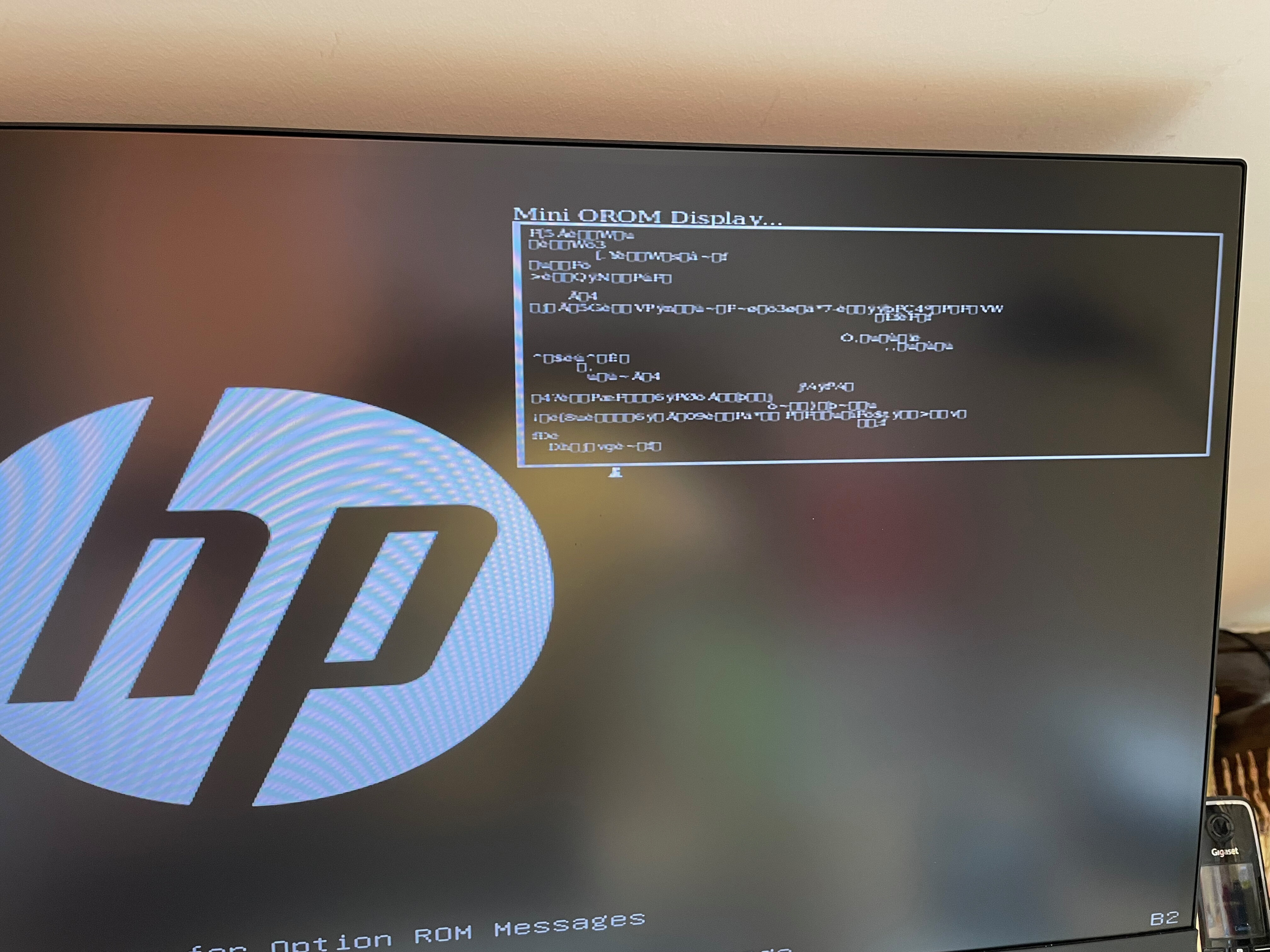

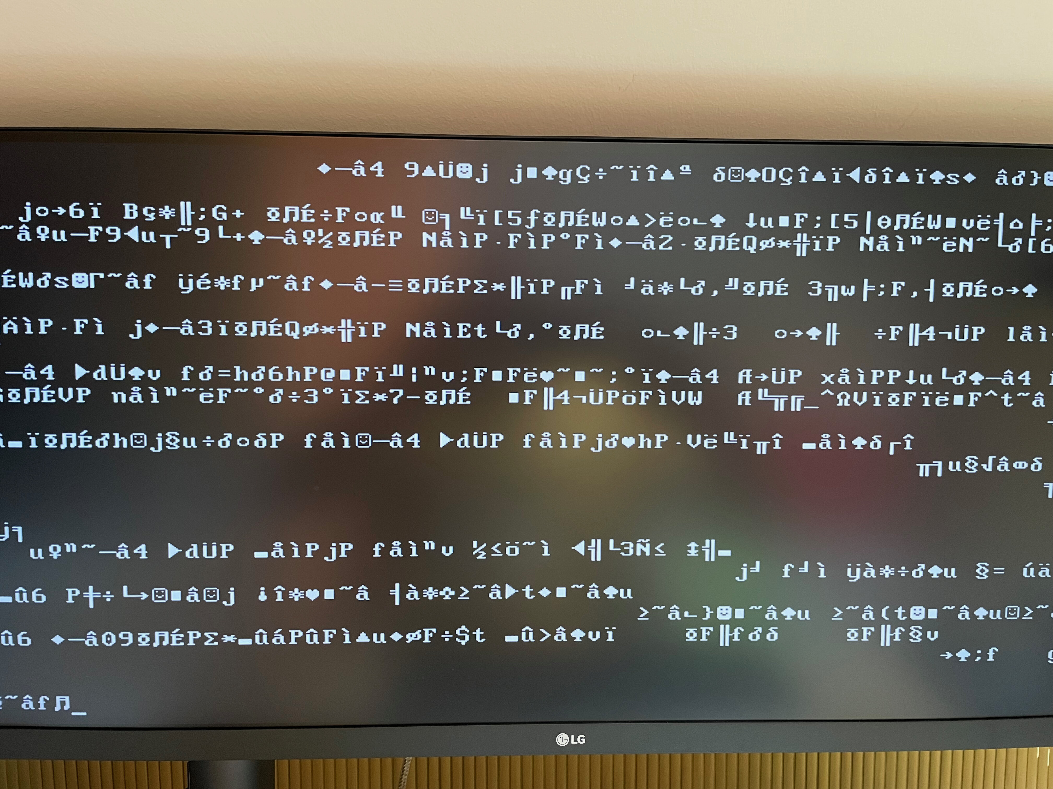

Hello,
This morning i wanted to start my backup server.
As i did not seen it on the network i plug a monitor and a keyboard.
First image is when i do nothing.
The second is when i hit keyboard at startup.
If you have an idea of what is wrong....

it boots when i unplug lsi hba (9207-8e). I modified some bios settings and it wasn't booting at all.
After a clear cmos it booted but as soon as i plug the hba i have the weird display.
Do you think the hba is dead ?
It is the same hba since the setup of the server 5 years ago. It has 20.000.07 it firmware if i remember correctly and has not been reflashed since.

Is there another port on MB to try hba in?

Without the hba the server boots normally.
I tried another pcie port for the hba  but no luck. I repasted the hba chip as the pad was completly dried but it still doesn't boot.
There has been no hardware or software changes.
What a dead cmos battery would do ?
Is there a way to reflash the hba ?
I will probably buy another hba. Any recommendations for a hba which doesn't heat too much ?
