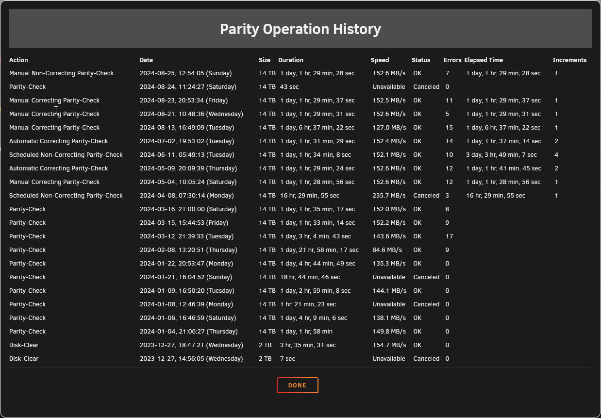

Every time I run a parity check I get a different number of errors each time (never 0). I dug through some earlier posts of people having similar issues and have ran a correcting parity check followed immediately by a non-correcting parity check and it gave me a different number of errors.
Please see attached for Diagnostics, screenshot of my parity check history is also attached.

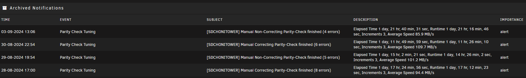

Alright, so according to my archived notifications (which I believe is correct) I have run a correcting parity check, non-correcting, correcting, and non-correcting (each with a different amount of errors each time).
2024-09-0316_01_29-SDCHONITower_NotificationsArchiveMozillaFirefox.thumb.png.30ed32851f6a003b02cb1983bc5ff933.png

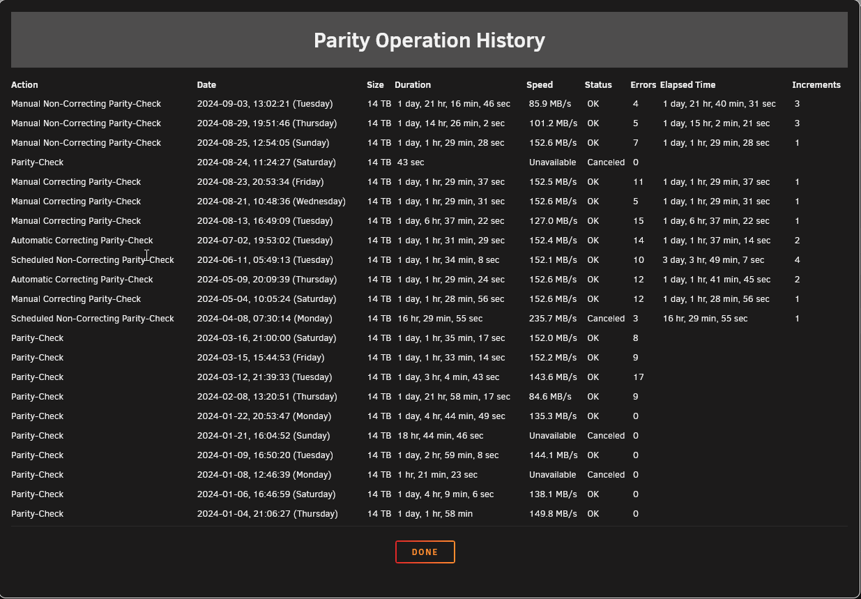

According to History, I have run 3 non-correcting parity checks?
2024-09-0313_37_29-SDCHONITower_MainMozillaFirefox.thumb.png.0953177b40d2c28cdc997af70ee061ab.png

You can ignore the notifications, there's an old bug, history should always be correct.
Diags only show one check, possibly due to mover log spam, but since the last three found a different number of errors, there's a problem, RAM would still be my main suspect, since you have 4 sticks, I would remove two, run a correcting check, then a non correcting one, if the latter finds new errors repeat with the other RAM pair.

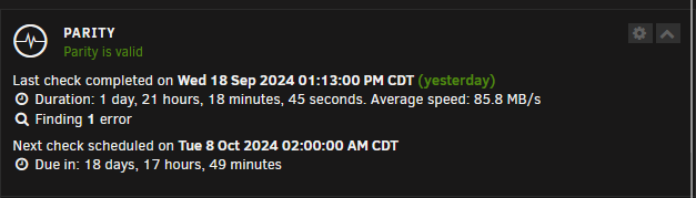

I put all 4 sticks back in and I get errors again (more specifically: I ran a correcting parity check and got  1  error2024-09-1908_10_30-.png.b7b7aacef9c209d9c80481b1b183595e.png

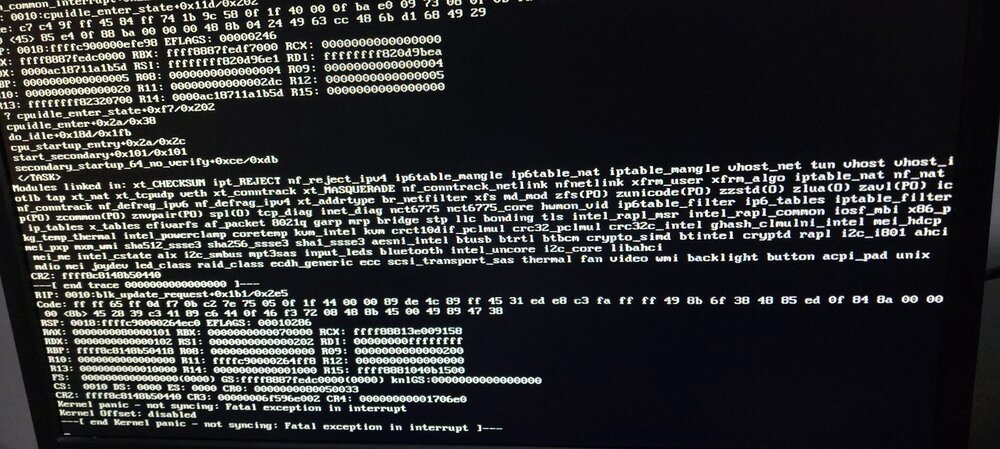

, ran a non-correcting parity check and the kernal crashed

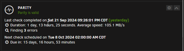

, and ran another correcting parity check and got 3 er
rors)
