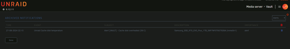

I've got 12TB unraid with a 1TB Cache NVMe up and running and seeding. Mainly using it to seed and as a media server currently.
However, my NVMe keeps showing warnings for temperature overheat. (my HDD's are around the 30 ~ 40degree mark)

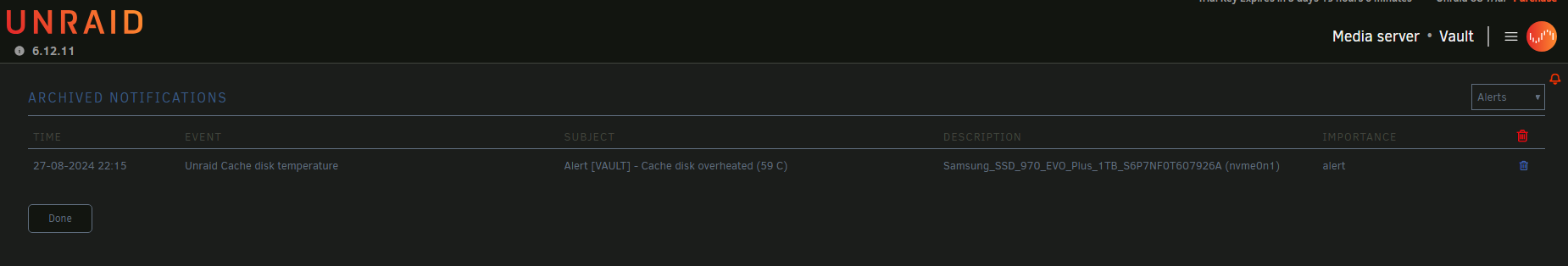

this is the highest it's gotten so far (usually while idle it's around 10degrees hotter than my HDDs):
I'm assuming it getting this hot is bad... and I should action this now to ensure it doesn't die prematurely.
Would the best thing I could do be get a heatsink for it?

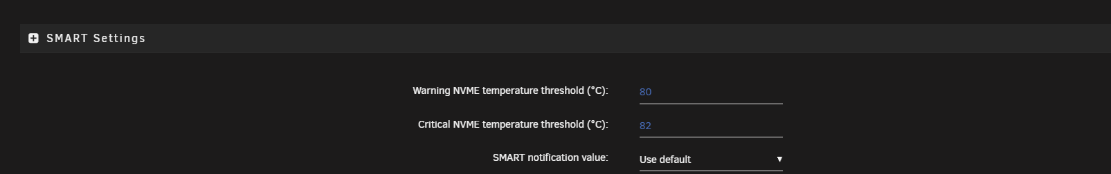

If you run this command you will see the temps for critical and warning on the device.
root@computenode:~# nvme id-ctrl /dev/nvme0 | grep temp
wctemp    : 353
cctemp    : 355
root@computenode:~#
Values are in Kelvin so -273 so will be 80 and 82C
If you click on the driver in main you can change the settings. In 7 it will set these to the values on the drive in 6.12.x you will have to change manually.
70C is a recurring number for max temps on various nvme drives, but as trurl states, best to look it up from manufacturer.
