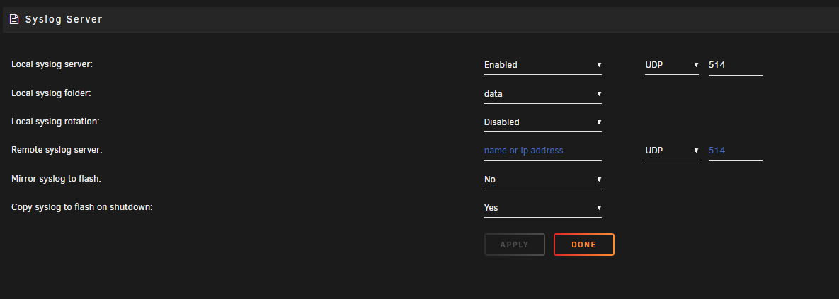

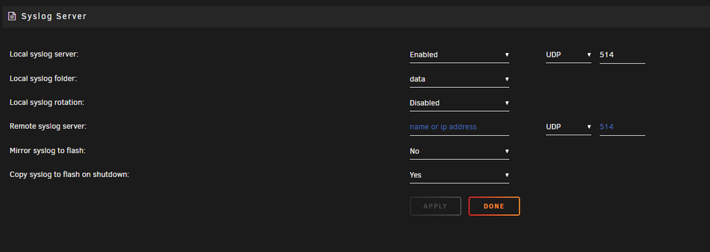

Do i need to do anything other than these settings?
In the event of another crash, what information should i provide?
As mentioned in the syslog server link you need to get something recorded you either need to set up the mirror to flash option, or put your server’s IP address into the Remote Server field.
The mirror to flash option is the easiest to set up, but if you are worried about excessive wear on the flash drive you can put your server’s address into the Remote Server field.

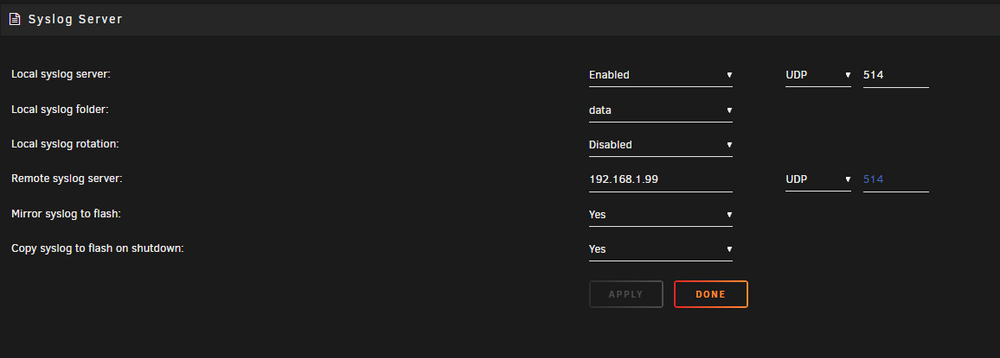

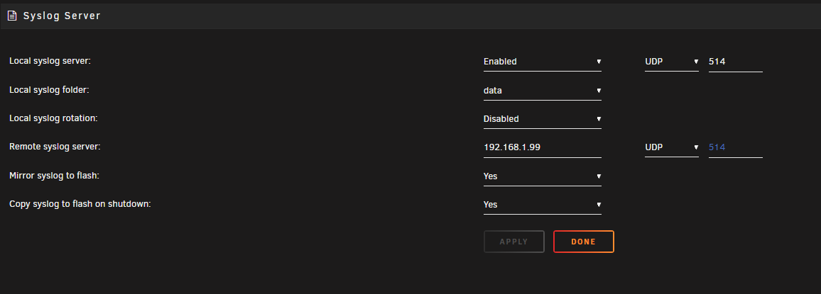

i might just do both.  Is it an insane amount of writes to the flash?
look about right?
