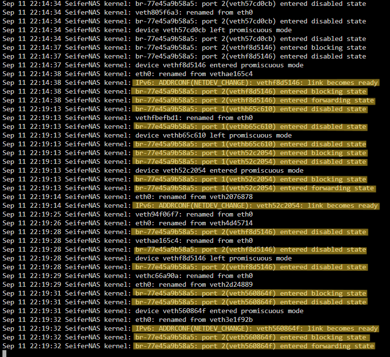

I have checked the port on my docker, and 2 of them had the same port, so I fixed it, it has runned smoothly for some hours and it crashed again, but I have been able to access the GUI so I performed a clean reboot but before that I downloaded the diagnostics file.
I have been able to access the log while the crash was on going, and I kept an eye over the syslog, and I notice when the following lines appeared, this have caused the crash, so I think it is network related. Is it?

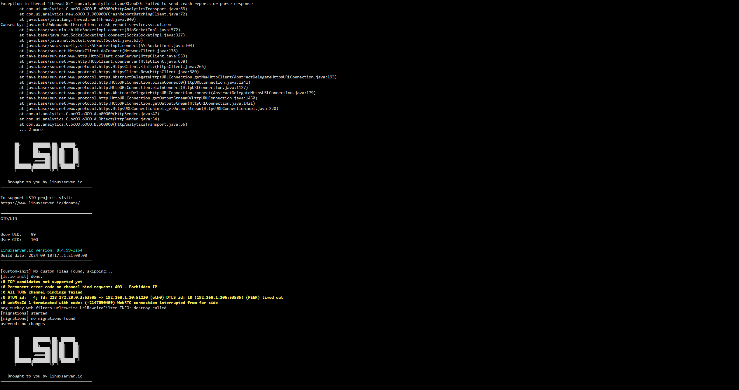

I noticed also that in my Unifi Network Controller Docker, these lines appeared too :
syslog.log
