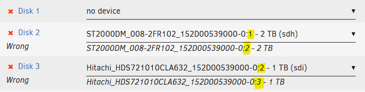

I thought the system needed to go through a "data shuffle dance" (Stop/Unassign/Start-in-Maintenance-Mode/Stop/Re-assign/Start) - but to my surprise, I found the disk/device IDs had changed on me, in the form of the very last "suffix" - screenshot of the ID change below:
I have two questions:
a. Why did this suffix change?
b. What can I do now to re-start the array? Is there a way to solemnly promise to unraid that these are the exact same devices inspite of this (involuntary) name change that I didn't even trigger?
I have a strong suspicion/hope that a reboot may set that last :suffix back to it's original value, but I don't want to do that yet, as I'd rather understand why this happened first, as well as because I don't want to lose any possible diagnostic logs that may still exist on the system.
Note: The drives are attached via a media-sonic bay over a USB connection - is it possible the system is randomly attributing these suffixes to devices in the bay?
Are you using USB?
Yes I am indeed! Does that cause this sort of behaviour?
Yep, one of the reasons we don't recommend USB, you can do a new config to correct the issue, but it may happen again.

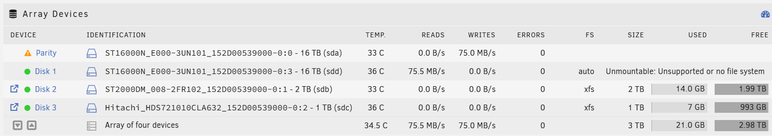

So I tried to do this, and was greeted with an unpleasant surprise, my main media drive (Disk 1) is being reported as "unmountable". What is the recommended procedure for recovery here - given that there is almost nothing else on the other two disks?
a. Should I wait for the parity to build, or is that pointless now?
b. What recovery avenues should I pursue?
c. Is there a recovery path from within unraid, or should I mount the disk on an external Linux OS and try to search for xfs salvaging tools?
Are you sure you didn't swap disk1 with parity? They both show the same serial because of USB, so you need to be extra careful when assigning them
That's an excellent question - I will double check and confirm. If I had done that, then of course the data on the media would now be toast of course.
