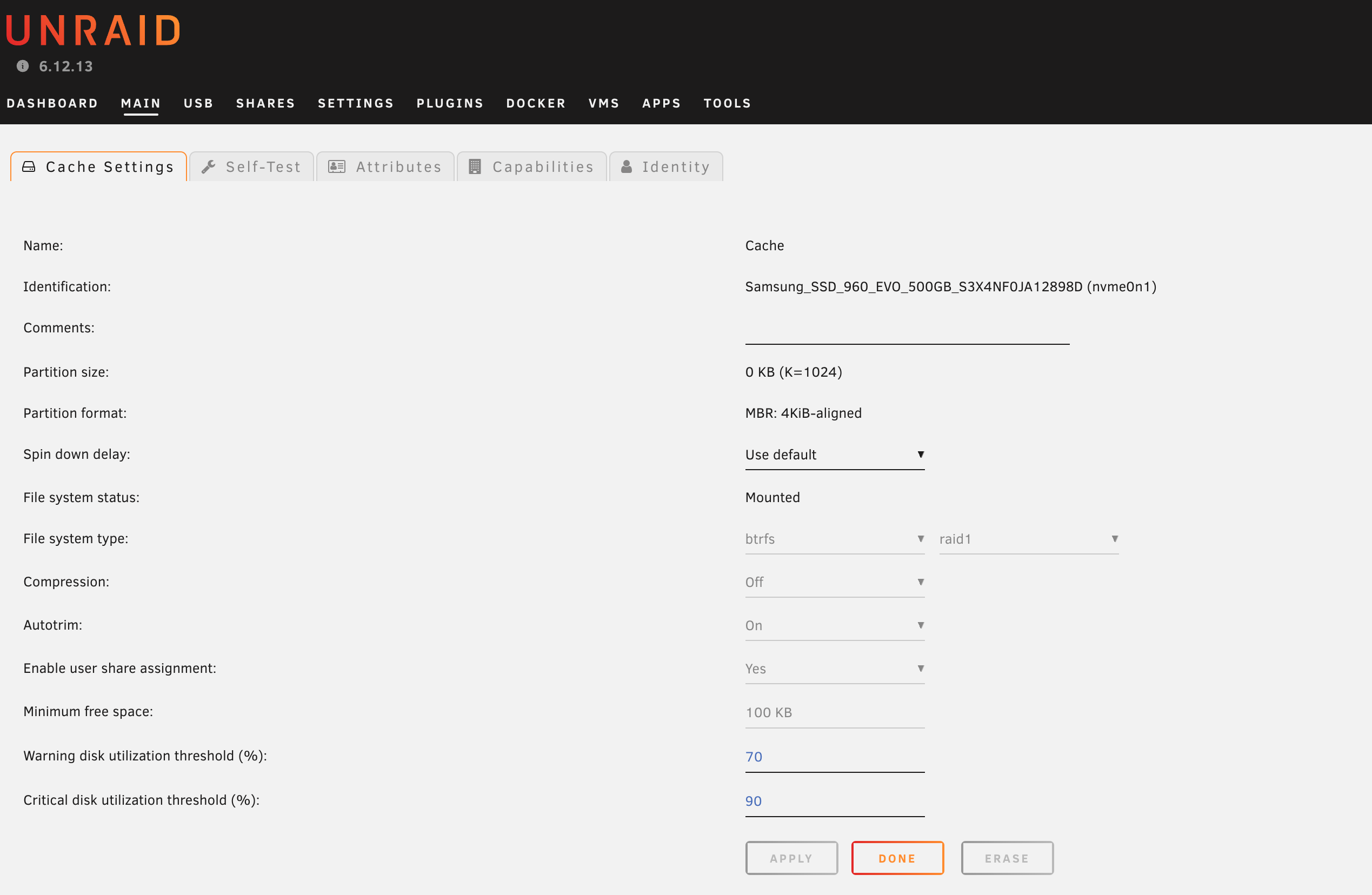

September 11, 20242 yr Community Expert The "UnRaider shfs: cache disk full" messages will be because the free space on the 'cache' pool is less than you have set for the Minimum Free Space setting so is informing you that a file is by-passing the cache.

September 11, 20242 yr Author 8 hours ago, itimpi said: The "UnRaider shfs: cache disk full" messages will be because the free space on the 'cache' pool is less than you have set for the Minimum Free Space setting so is informing you that a file is by-passing the cache. Thx @itimpi! I checked this setting for my cache and it's set at 100KB and I currently have 69GB free?

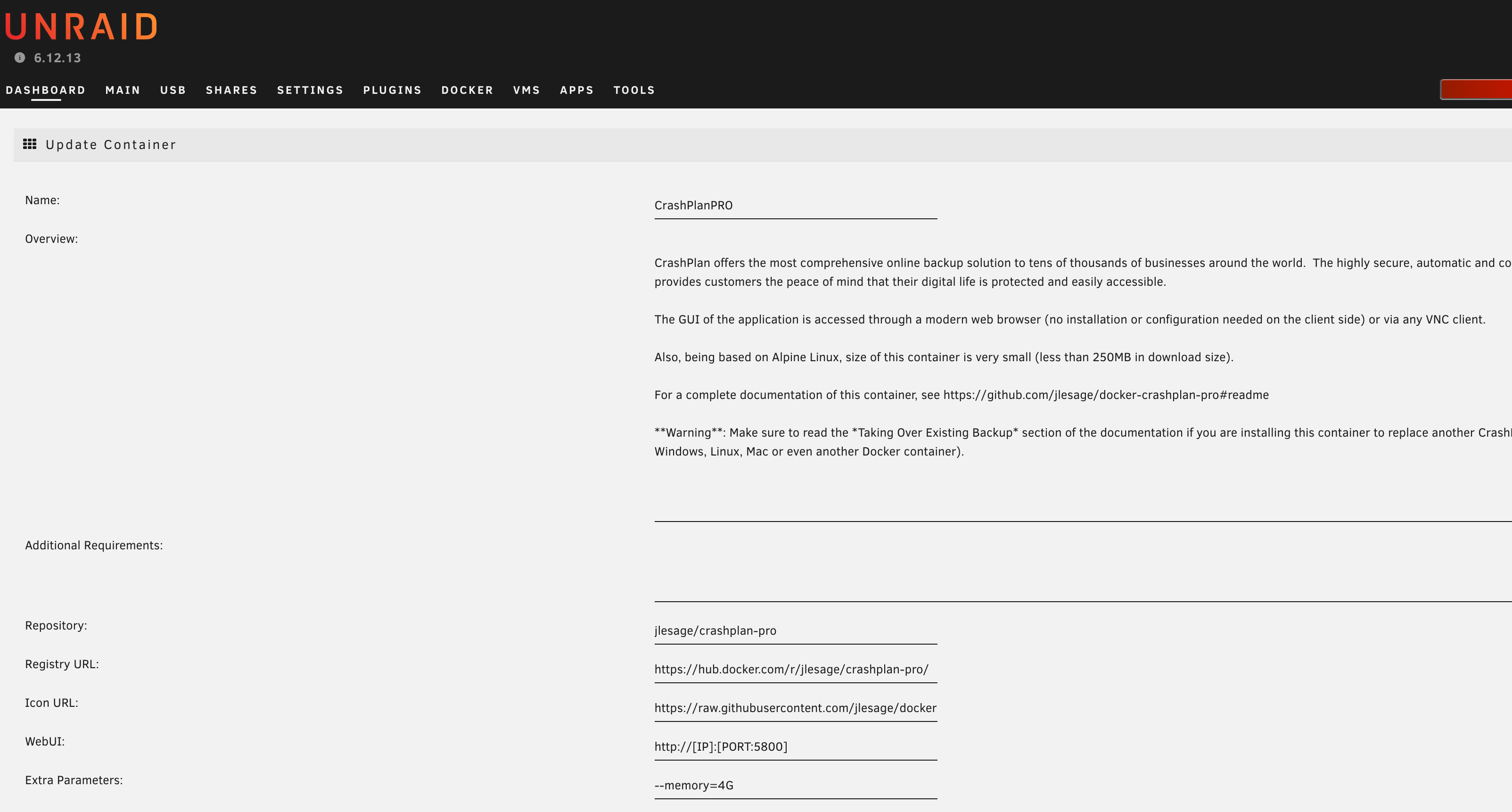

September 11, 20242 yr Author 6 hours ago, Michael_P said: Crashplan is running the host OOM, check its config and/or limit its RAM usage. Restart the server to clear the log or FCP will continue to warn you about the past events. Thx @Michael_P! I checked my container and reduced the max memory from 6G to 4G (hopefully that's still enough). Although I've had it set to 6G for years, not sure why it's complaining now - perhaps other containers I've added have led to maxxing out my memory?

September 11, 20242 yr Author 2 hours ago, Michael_P said: Crashplan was using ~11GB when it was killed Whoa, that’s crazy! Do you know how the container was able to exceed/bypass the 6G limit I added to the extra parameters? Is there another way to enforce the memory used?
September 12, 20242 yr Community Expert 14 hours ago, unRaide said: Do you know how the container was able to exceed/bypass the 6G limit I added to the extra parameters? No, I don't know how docker determines when to enforce it or not - you can force docker to do it instead of the kernel with the --oom-kill-disable flag, but use it cautiously as it's highly likely to bring down the entire system if docker doesn't do it right. https://docs.docker.com/engine/containers/resource_constraints/ Your best bet is to figure out why crashplan is running away and change its config to prevent it.
September 15, 20242 yr Author On 9/11/2024 at 12:10 AM, itimpi said: The "UnRaider shfs: cache disk full" messages will be because the free space on the 'cache' pool is less than you have set for the Minimum Free Space setting so is informing you that a file is by-passing the cache. Thx @itimpi! Not sure if I'm still misunderstanding how this works but stopping the array and changing my Minimum Free Space to 4G instead of the 100KB is was seemed to do the trick. I felt as if the original setting should've worked but perhaps something else was going on 🤷♂️.
