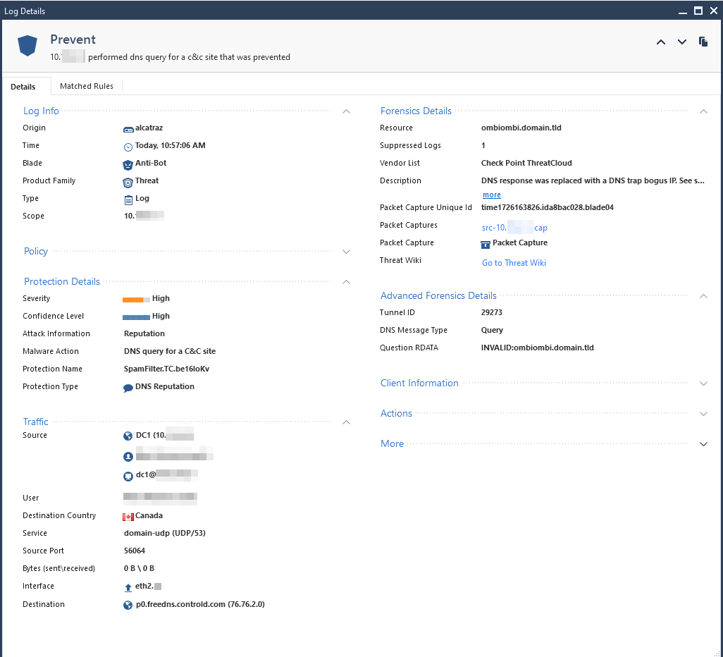

September 12, 20242 yr It would appear that two of my dockers are continually trying to query a domain that has been categorized as a C&C site. I would like to stop these queries, or sink hole them, but I'm not sure of the best way. The docker container is querying my internal DNS server, which is then querying my forwarding DNS servers and being flagged/prevented at my firewall. The domains are unifi.domain.tld and ombiombi.domain.tld. I don't want to put an exception in my firewall, I just want to blackhole or stop the requests. Or understand why they are there in the first place. Can anyone offer advise or suggestions? Also what is odd, I am not running Ombi, but Overseer. I'm assuming that the ombiombi query is from Overseer. I'm also assuming the unifi query is from my Unifi container.

September 14, 20242 yr On 9/12/2024 at 2:16 PM, UncleStu said: a domain that has been categorized as a C&C site Where did you see that?
September 14, 20242 yr Author 2 hours ago, caplam said: It looks like a default setting in conf file of an app. Where could I look for these? I looked through the Unifi and Overseer webUI's and didn't see anything. I looked through the settings for Docker as well, thinking that maybe it was something nested into unraid itself. Nothing. You're correct that the domain doesn't exist. I didn't look to see if it did or not. Could possibly be a false positive from my firewall. Still interested in stopping/changing the queries if I could find out where they are coming from. 2 hours ago, JonathanM said: Where did you see that? The log details screenshot from the first post shows this. But the data could be wrong if it is a FP alert.
