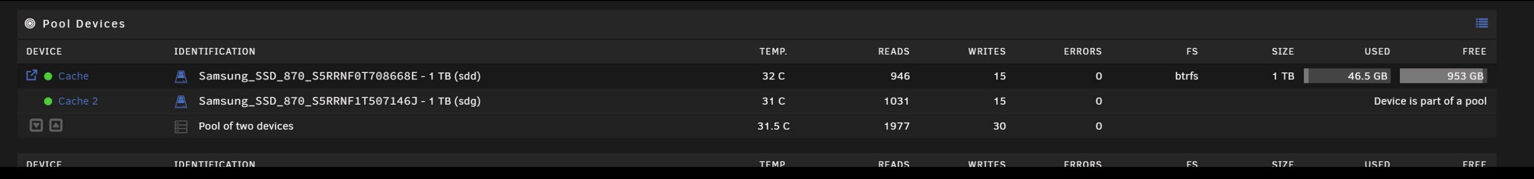

I have a pool of 2 Samsung SSDs.
But i want to use the slot for a 18Tb drive.
The pool is ONLY been used for downloads. Nothing critical.
Can i in a easy way split the pool or deactivate the pool?
I want it to be the cache drive like it is now but only with 1 disk :)
Thanks!
