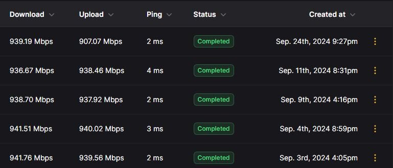

Just had a fiber line installed (3g internet symmetrical) and I put in a new 10g switch and had a new ethernet cable ran from my router to the switch. It is plugged into the 10g port in the router. I installed a 2.5g card in my unraid server (originally purchased a 10g card but did not have a pcie port left in my server for it) and the unraid gui says I am running at 2500 Mbps.
The problem is I am only getting gigabit speeds on my docker. I am using the speedtest tracker docker to test my speeds.

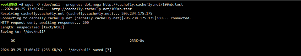

Post the output from this:
wget -O /dev/null --progress=dot:mega http://cachefly.cachefly.net/100mb.test

Don't know what to tell you. Ive run that command many times and Im getting the same output. I seem to be getting that Length: unspecified [text/html] error that is not in your output.
🤷‍♂️ That always worked for the people I asked to do it, though, there's haven't been many yet.

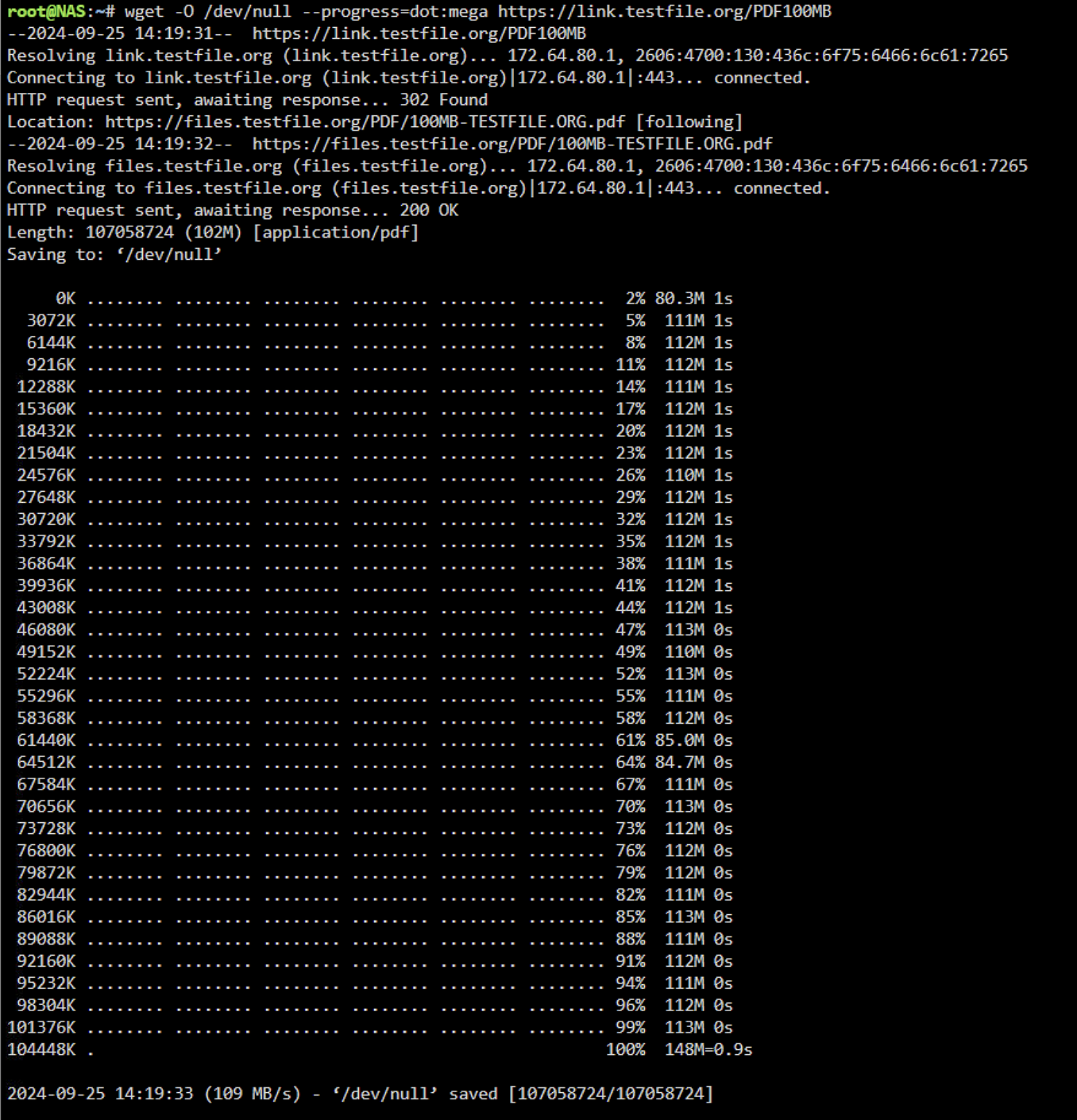

I found another random test file.
So looks like the WAN is limited to gigabit.
