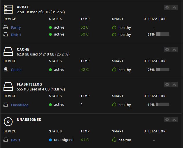

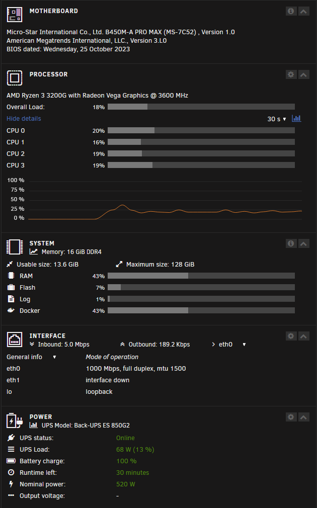

This is usually how my system info looks:

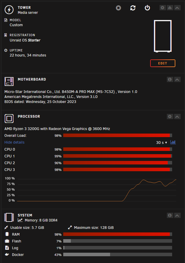

I just experienced another crash this morning which appeared to be somewhat odd. From my phone I could access the login screen of one of my docker apps. Then when I went to my PC to check the dashboard, it froze like this immediately while loading the page:
I successfully accessed the login screen of one of the docker apps at Oct 1 10:10:00 approximately, though I don't see it in the logs. Perhaps it was just cached?
I have attached the log again, but I assume these are the relevant events. I believe I determined that the dashboard has frozen around 10:22:00. I pushed the power button of my NAS at 10:35:51. It did not power off. So around 11:22:00 I held the power button to shut it down.
