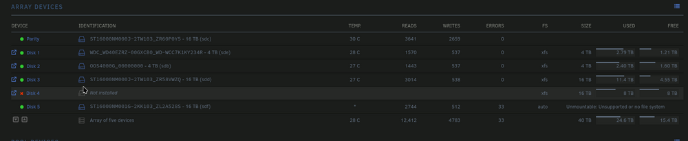

I had to buy a new HBA because my old one was defect and the drive connected to it kept disconnecting. I properly turned off my Array, shut down the server and put the new stuff in. Now both of the old drives (just connected to a new controller) are showing "Unmountable: Unsupported or no file system".
How to I rebuild this at best without data loss?
This is what it looks like right now:
bkn0vmx3jcrd1.png?width=1813&format=png&
Do I just format them both and let it rebuild?
Really not sure what the best way to fix this mess is.

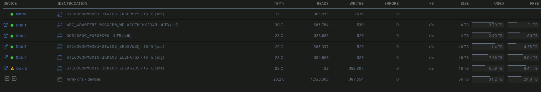

Disk4 mounted and it's showing data, so that's good, check filesystem on the emulated disk5, run it without -n
    Phase 1 - find and verify superblock...
    Phase 2 - using internal log
            - zero log...
    ERROR: The filesystem has valuable metadata changes in a log which needs to
    be replayed.  Mount the filesystem to replay the log, and unmount it before
    re-running xfs_repair.  If you are unable to mount the filesystem, then use
    the -L option to destroy the log and attempt a repair.
    Note that destroying the log may cause corruption -- please attempt a mount
    of the filesystem before doing this.
Should I just run it with -L then?
Yep

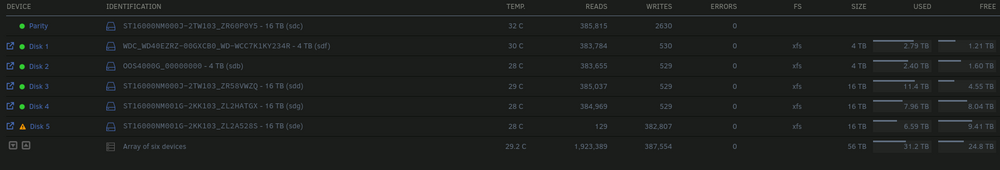

Well, that's looking better now:
I'm gonna let it rebuild for now.
Edited by Yasuman

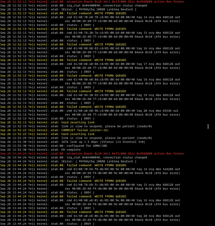

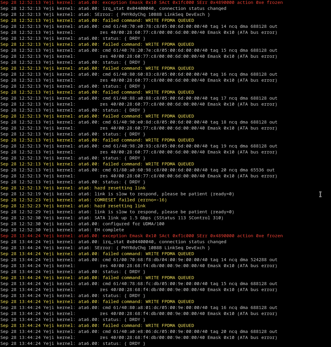

Check the syslog for errors with disk6, if they still appear now, or when reading the data after the rebuild, you may need to replace it.

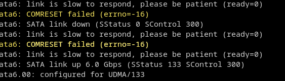

I still get quite the amount of errors, but so far it is still rebuilding:
I think you will need to replace that disk.
I should be able to replace it and just restart the build process, right? It dropped down to less than 1Mb/s now and that would take years to build.
Yes.
