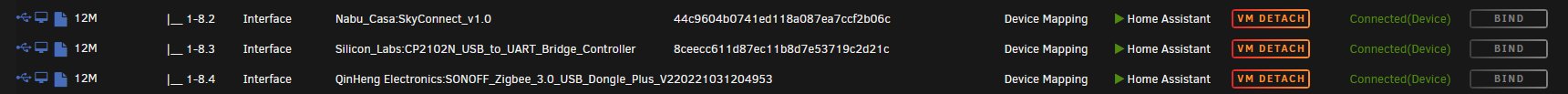

Are you doing device or port mappings. With duplicate devices id serials are not unique I would use port mappings. Any thing in the logs?
Looks like device.

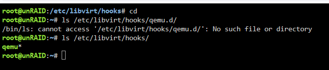

Do you have the USB Manager file in this dir
root@computenode:~# ls /etc/libvirt/hooks/qemu.d/
ArcReset  Notify*  USB_Manager*
root@computenode:~#
root@computenode:~#
Doesn't look like it.

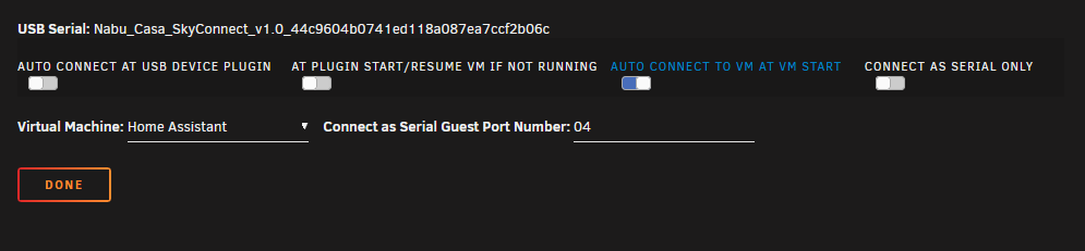

Reinstalled the USB Manager Plugin and now it looks like this:
And now the USB devices are attaching after a reboot.
Thanks!
