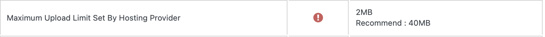

I'm new to the world of unraid and trying to launch a wordpress server on my unraid server. Unfortunately I'm having issues with file uploading because the host (Unraid server) is currently set to 2M. I've had a look around the terminal using "cd /etc" then nano php.ini and there's no options to update the upload_max_filesize. Can some help/suggest where within the terminal I might look to update this.

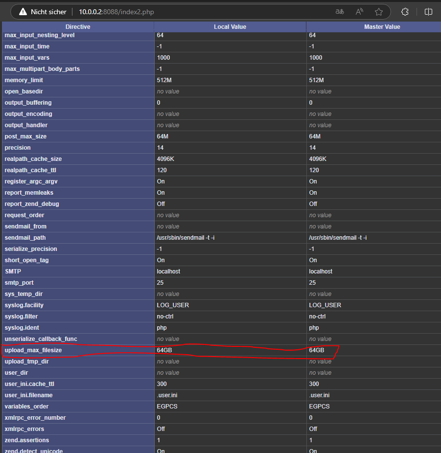

The image below is the Upload_max_filesize for the unraid server, within the PHP settings within the tools tab.
And this image is the warning coming from Wordpress about the 2M limit from the host.

It's not, no web traffic to your WP container will be going through unraid's webserver. It'll only be either the php server in the WP container or anything in the chain put in front of it (reverse proxy, tunnels,...).

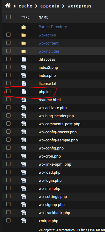

All you need to do is create the php.ini file in /mnt/user/appdata/wordpress/ and then restart your wordpress container.
php_ini.thumb.png.5ead728ea8b71198e485f0efe05a727e.pngphp2_ini.thumb.png.4f3c897a7e743111cb520ce84be1969c.png
and thats it.
