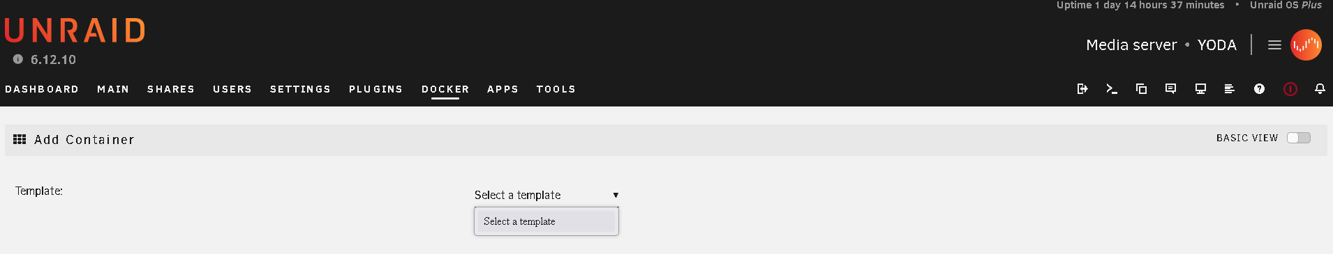

I've had Unraid for some time now, and I'm on Unraid OS 6.12.10. I just added a 1 TB cache drive, and just enabled Docker and VMs. I want to install a docker from teh Community Apps, however, when I get to the add container, there's a drop down menu for templates and there's nothing there.
What am I missing? Attached are diagnostics if you need it.

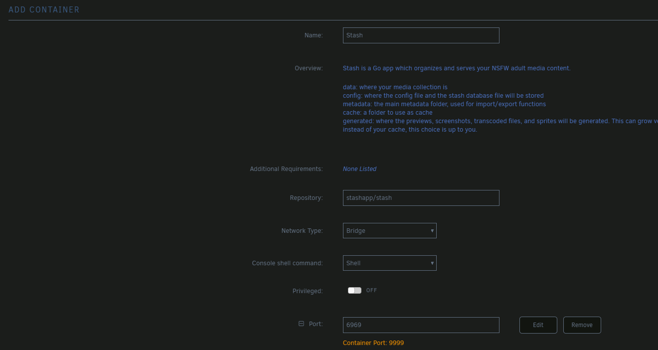

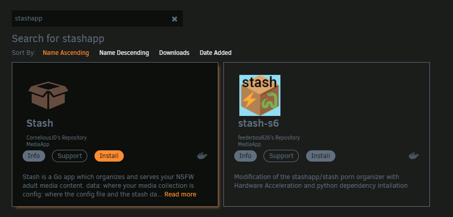

I'm trying to install the Stashapp however, when I try to do so, I get the screenshot attached.

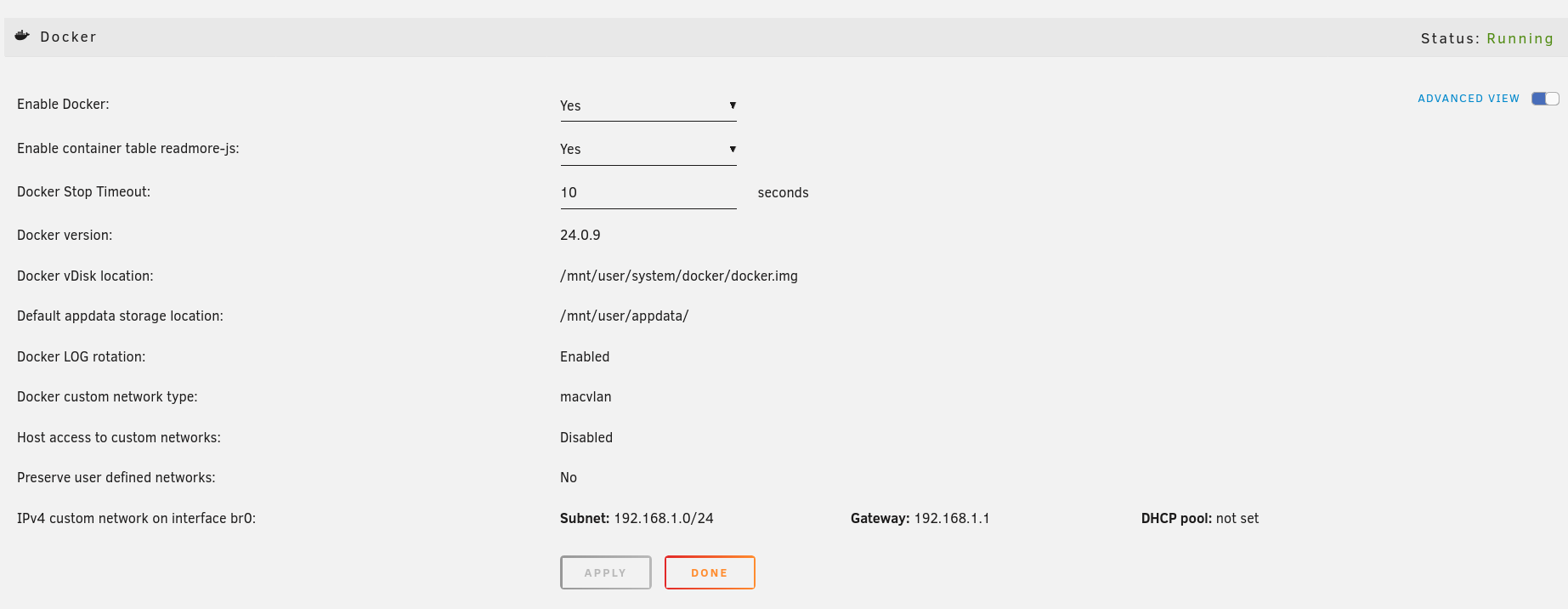

You haven't any network interface attach to docker service, pls post settings -> docker screen dump for ref. ( turn-on "Advanced View" )
Edited by Vr2Io
Screen capture look normal, I also try install that app in CA, are you click "Install" ?
I hit install, I am then taken to the add container page, where my select a template dropdown menu has NO templates.
What am I doing wrong?

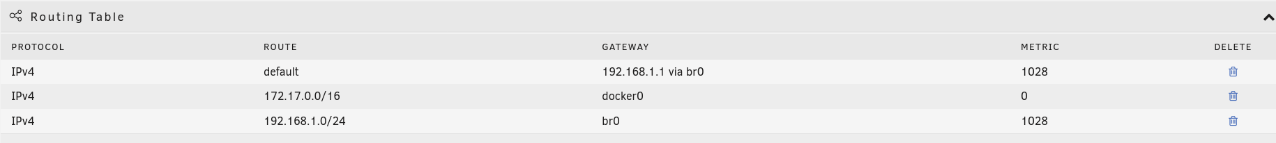

Is it possible that I set up the IP stuff incorrectly? I see a default route, a route labeled with a docker0 gateway, and a route with br0.
Not sure that, pls provide a photo for better understand what those are.

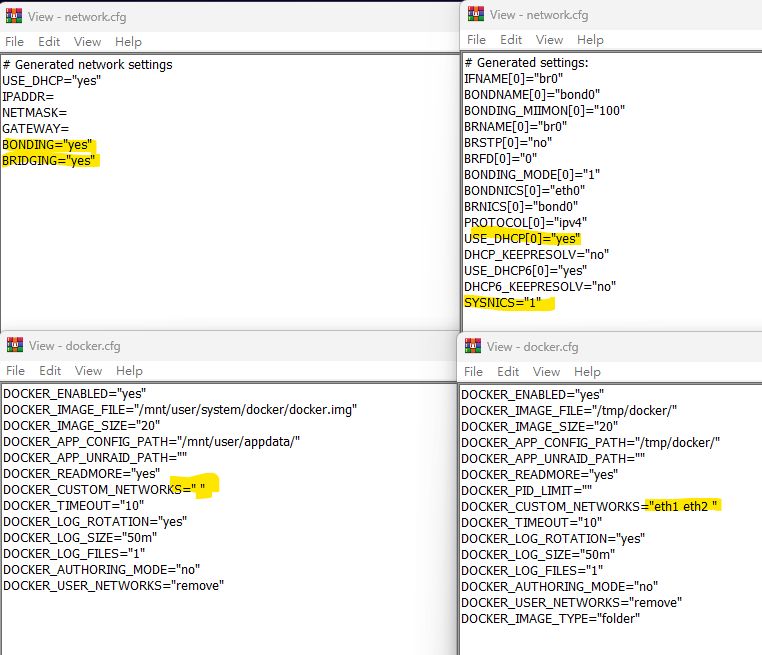

But as my first reply, there are no NETWORK found if according docker.cfg in diagnostics. Pls also post new diagnostics again.

This no abnormal, the only abnormal was your diagnostics haven't network-rules.cfg file and network.cfg and docker.cfg both have something abnormal.
- network.cfg missing many parameter
- dockr.cfg missing interface at NETWORKS
Pls try delete network.cfg and re-setting the network part. You don't need manual create anything / modifying those config file.

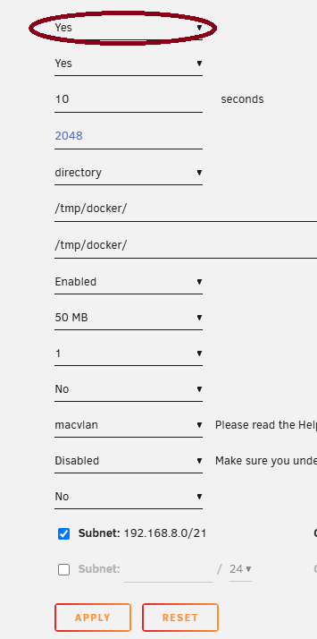

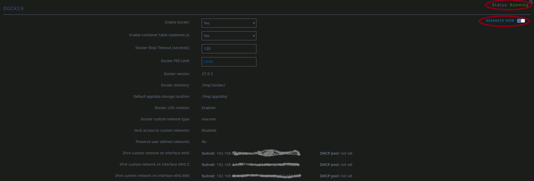

Pls also in docker page, setting it "Yes" then RESET and APPLY.
Very strange issue, never seen it before, could be some flash drive config issue.
