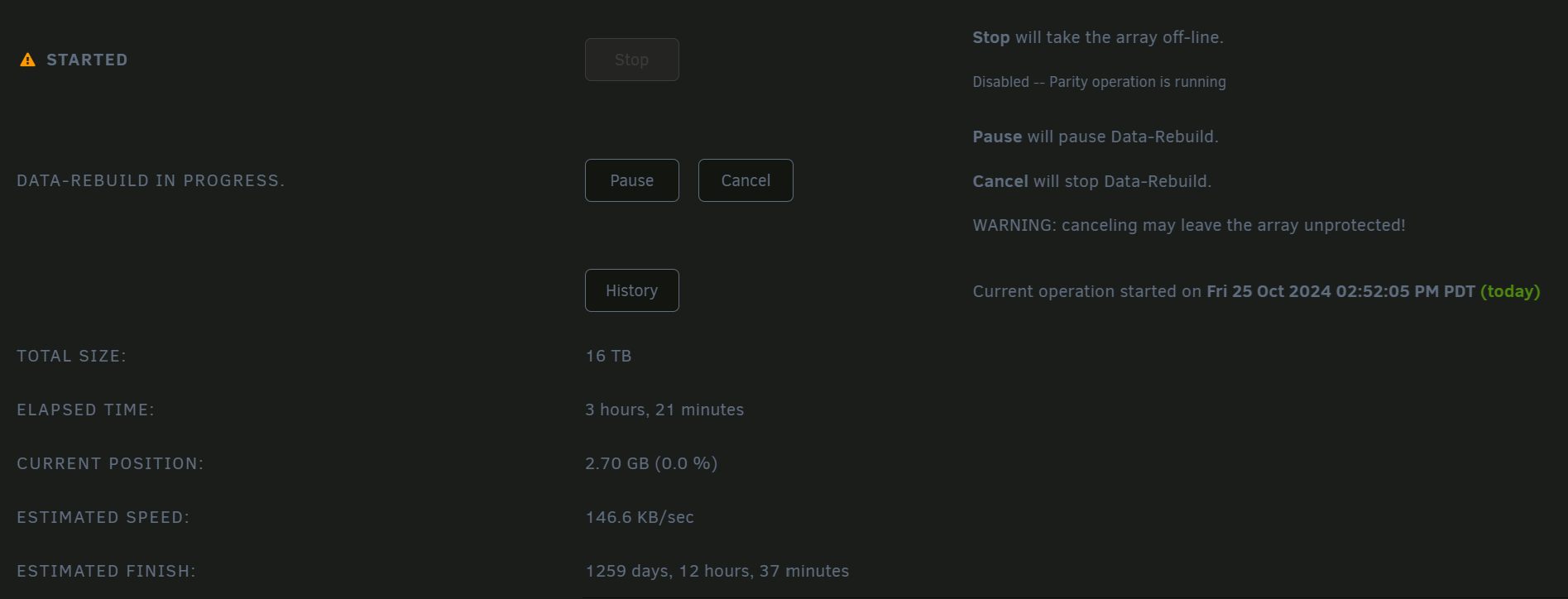

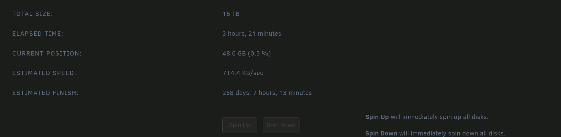

Slow rebuild speeds. Version 6.12.13

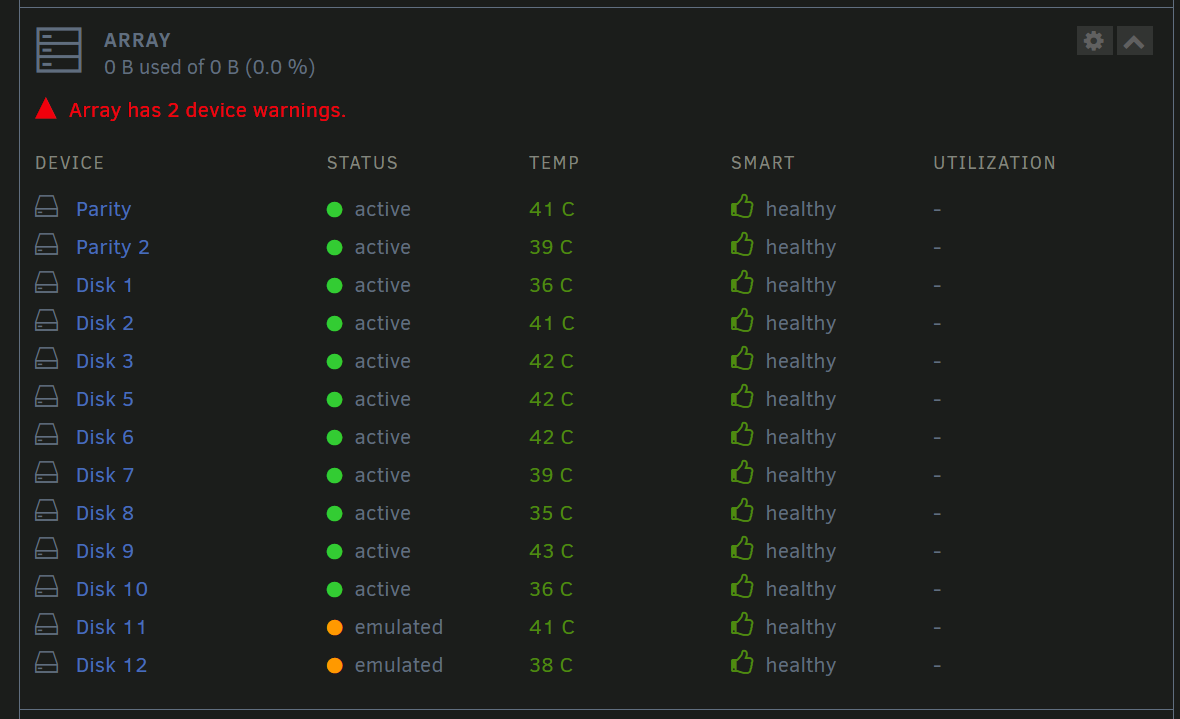

Two of my drives needed to be repaired because they became disabled, and I just had to remove and re-add then to queue the rebuild.
The drives are practically brand new and even when I replaced them with another good drive, but they still had a slow rebuild speed.

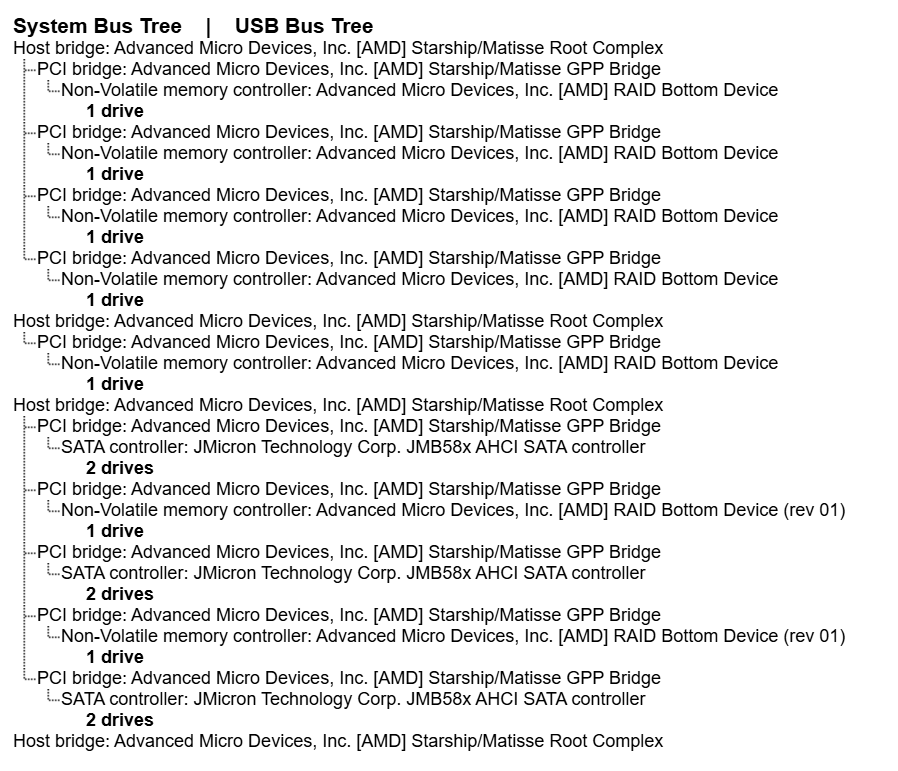

I know in the past there was some approved sata cards that I added to my setup, but I wanted to make sure I did not have something in my setup that is not good. So here goes:
I have two of these: image.thumb.png.84c560611296f937db31b73aa81fd157.png
and two of these:

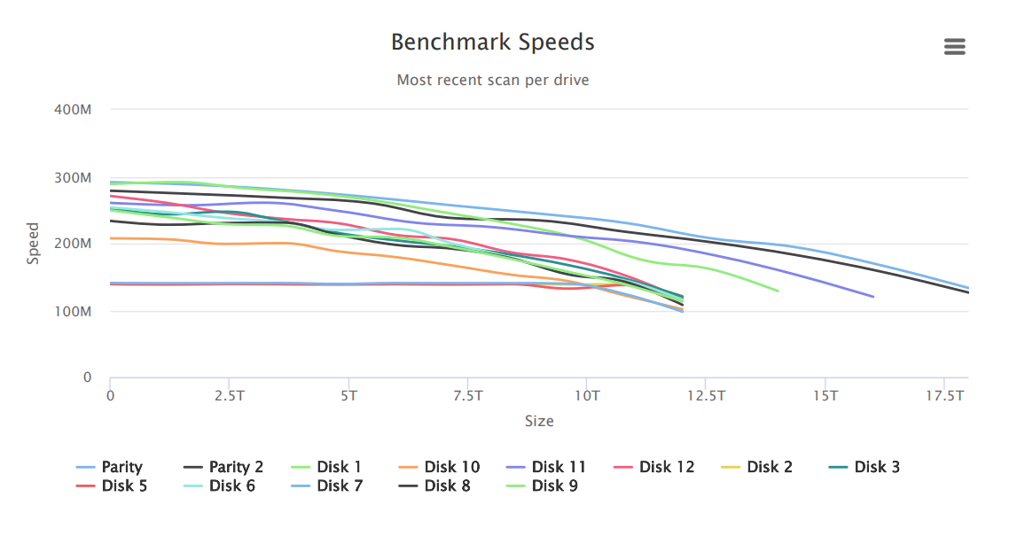

Benchmark docker also shows the following:
image.thumb.png.6d33ee86dfa64fa0fc4d52e52b03249e.pngimage.thumb.png.685916a9920b706ca6649708b9927294.pngimage.thumb.png.32799156d7cf7320b024f06589f174f9.png
