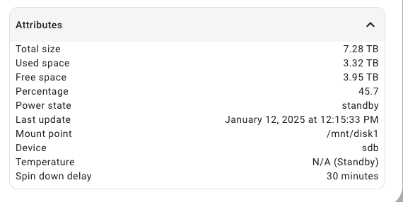

could you somehow make it possible to read HDD temps? i would like to use HDD temp readings to turn on an room-exhaust-fan in my server closet. awesome plugin!
Yes you can, if your disks are on all the time then you should see the disk temperature attributes under disk usage and disk health sensors. In my case my disk spin down after 30 minutes of inactivity and temperature readings shows N/A (Standby)
You can use the temperature attribute in your automation to trigger Fan or AC
ohhhh awesome thanks a lot! thats fantastic! really great integration you wrote there man. Dankeschön
