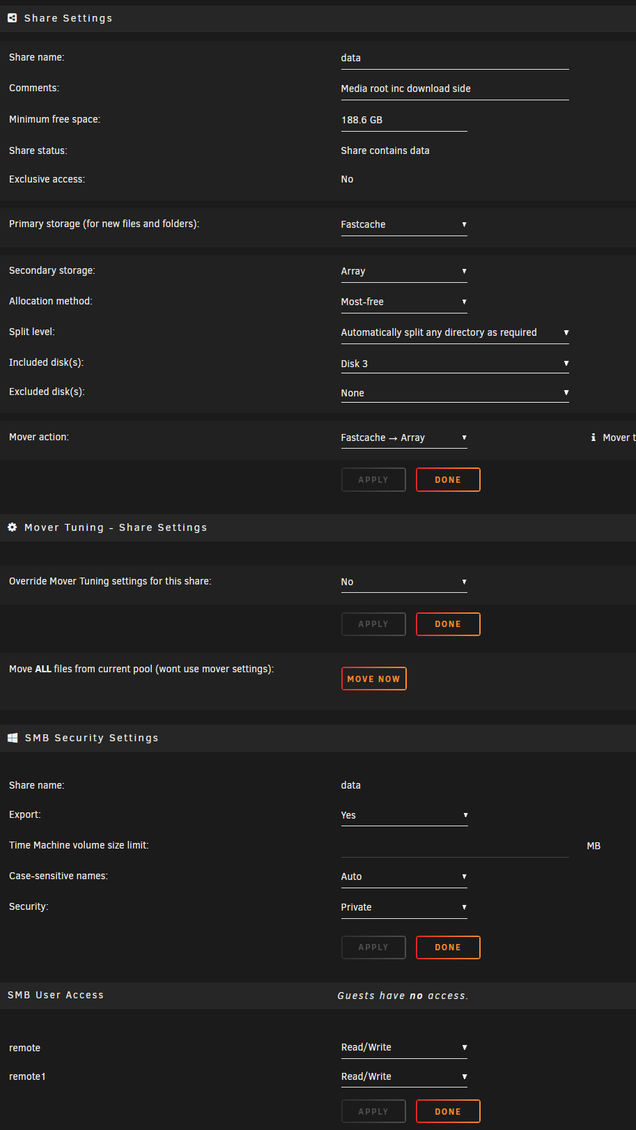

Share settings attached. The file is on my cache drive at the moment. Not sure if this is relevant or not.

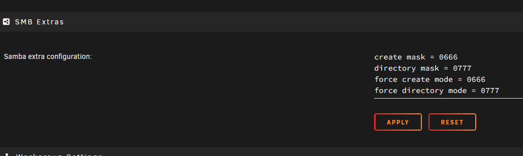

as mentioned earlier.. you need samba options:
create mask = 0666 directory mask = 0777 force create mode = 0666 force directory mode = 0777
your fighting whth touched what where and wrote as who.
smb extra options:
[data]
create mask = 0666
*this will make any file read or writen to that rwxrwxrwx...

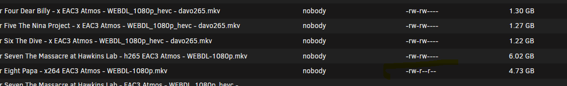

So I made the changes to the smb settings as below and restarted the array. Downloaded via sabnzbd and it unfortunately the new file still has the wrong permissions. Did I make a mistake with how I did the settings?
This is the permissions of the file one it was moved to the folder (the new file is the 4.73GB file), the others have the correct permissions:_unraid-file-permissions.thumb.png.e9851e60aa9f8ee92ab7617115627ff7.png
you still need samba info?... That may not be applying picture is not clear...
you may require:
[global]
to affect across samba
*some of those settings are share only setting
Can't be sure you set your smb permission correctly....
you may need them under the share name:
[data]
to set those permissions... as shown above... RE-read the entire post. ask question if you don't understand.

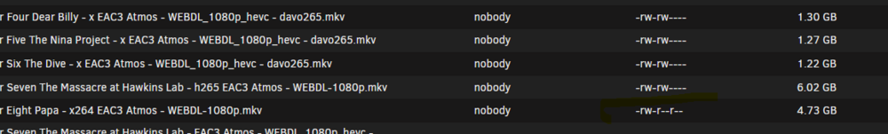

I don't believe the issue is to do with Samba. As has been mentioned, the rights are incorrect after the files were written by the arr apps/sab which wouldn't use samba.
Looking at the container setup for these apps they all run as user PUID 99 (nobody).  I've changed to PUID 1000 (remote - the user I connect from the windows pc) and potentially it's working. After downloading a file via Sonarr/Sabnzbd I have the following:
(owner) remote    (permissions)  rw-r--r--
Which I think is correct?  Certainly it appears that my mini windows pc can write to those files now.
I forced rights of rw-rw-r-- across the entire share. It probably would have made more sense to change the owner to remote and set them to rw-r--r-- I'm guessing?

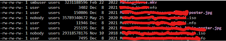

The problem is that Samba (as LimeTech has it setup) uses the group permission for most Share Access user access.  Look at what the default direct from a Windows PC is writing files to the array:
Notice that there are three different owners for this group of three videos and their files---  smbuser, user and nobody.  There is only one group--- users.  If you do some investigating, you will find that all three of the 'user names' are members of the 'users' group.  Note that the permissions are identical for both owner and group-- rx-
I can assure you that this share is Private and users 'smbuser' and 'user' have full read/write privileges to all of these files regardless of who owns them!  The only way that this can happen is because that LimeTech has set up Samba in Unraid so that it is expected that the file access will be controlled through the 'group' privileges/permissions not through the Owner's.
The same argument might be made for those connections are using the Guest access when accessing public shares.  They are using the 'other' permissions.
This is the reason that underlying Linux Permissions must 666 for files and 777 for directories.
