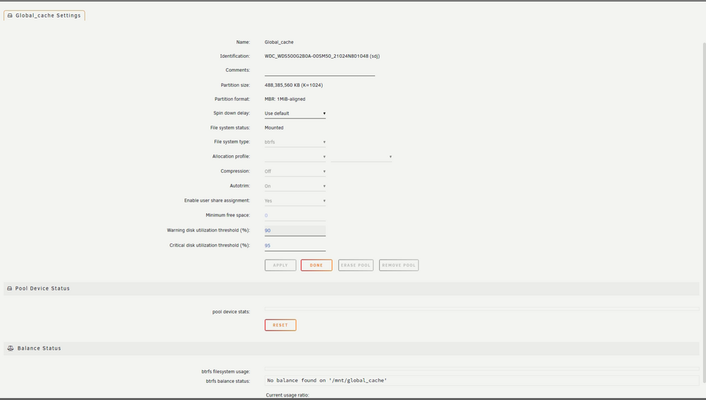

I don't see any scrub option on that screen?
Please post a diag file...

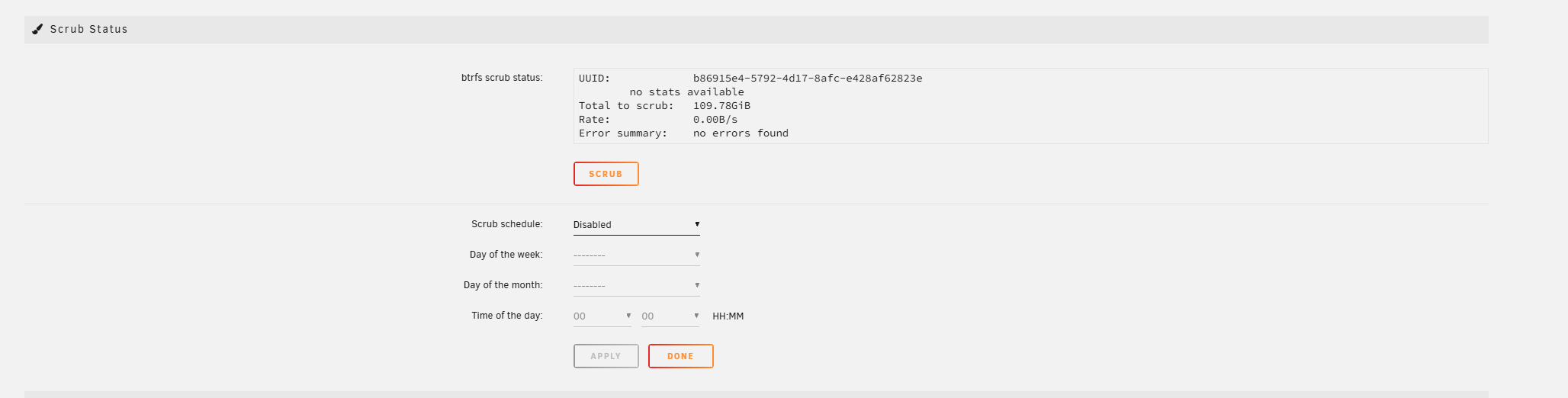

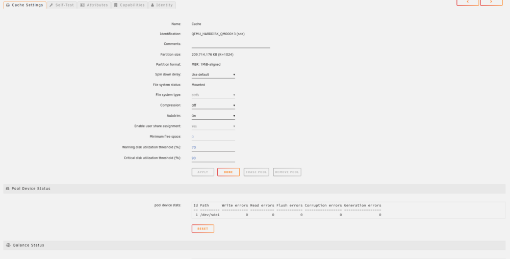

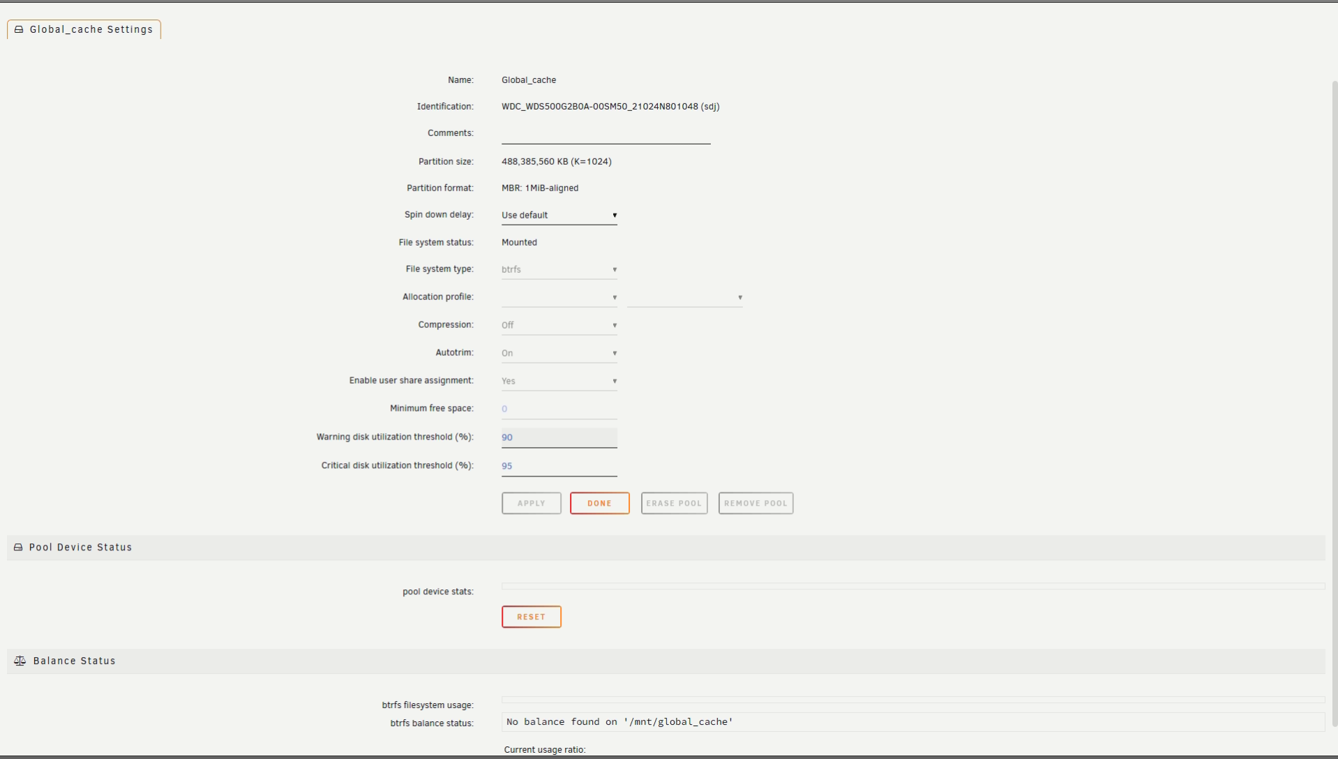

you may not be on a btrfs fomrated disk:
Main:
*Note the FS
click the name in my case its called cache:
It is under balance section...
!!!scroll down!!!!
this is the same for ZFS. otherwise you will need to run the termianl comands targeting hte disks.
