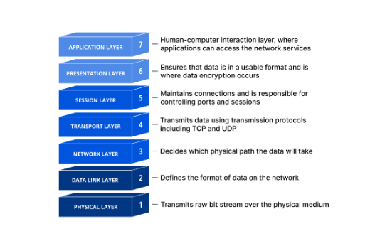

TO THE OSI MODEL!
 Ethernet is fundamentally a Layer 2 protocol. 10 Gigabit Ethernet uses the IEEE 802.3 Ethernet Media Access Control (MAC) protocol
TO the IEEE 802 stuff...
https://www.ieee802.org/3/10GBT/public/nov03/10GBASE-T_tutorial.pdf

But within the last 10yrs you may have had a chance to learn that jumbo frames are outdated and obsolete now.
The have nothing to do with 10G LAN, they were invented when 1G came up with still dumb NICs.
CPUs were hogged by the amount and speed of the incoming packets.
Jumbo Frames helped because larger frames meant less frames therefor less computations were needed (CRC checks and so on). Freeing the CPUs a bit.
But then NICs grew up and were able to handle the checks and computations now by themselfs (offloading).
CPU is not involved at all anymore, it is just informed if a readily checked packet is store savely into a buffer.
So the amount of packets does not play any role anymore, even the cheapest NIC from Realtek can do these things today.
Jumbo Frames give no benefit, maybe a small percentage in artificial benchmarks like iperf, but not in real life.
On the other hand, they only will work at all if ALL members of the Network does know about them and can handle them. Else you will always have "hickups" because a Jumbo Frame could not be stored, is rejected and then MTU is lowered and everything resend. This will make things even slower than with the standard 1500
(The lower MTUs you mention do not appear in LANs at all (unless you force them) they are only used by ISPs that use tunneling protocols and need some bytes to store the tunnel info. For instance I use 1280 for my 4to6 tunnel here)
