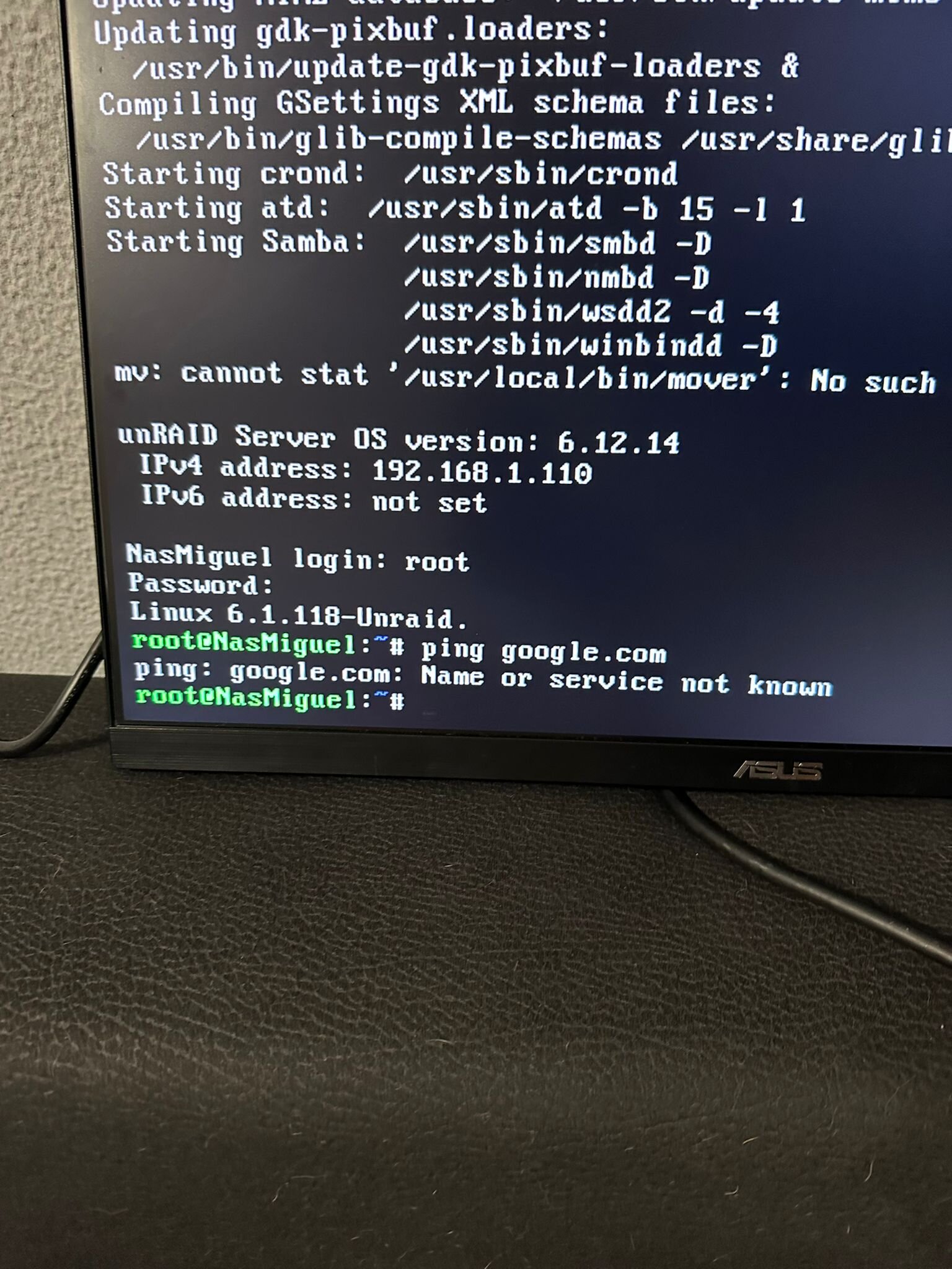

I did that, and now I have no internet access.
ImagemWhatsApp2024-12-02s20_13.06_78f6a4f7.thumb.jpg.0ec01a59f44a874c024bc7be54ad200b.jpg
you need to use another pc and go to 192.168.1.110 and set dns setting.
I don't have access to another PC.

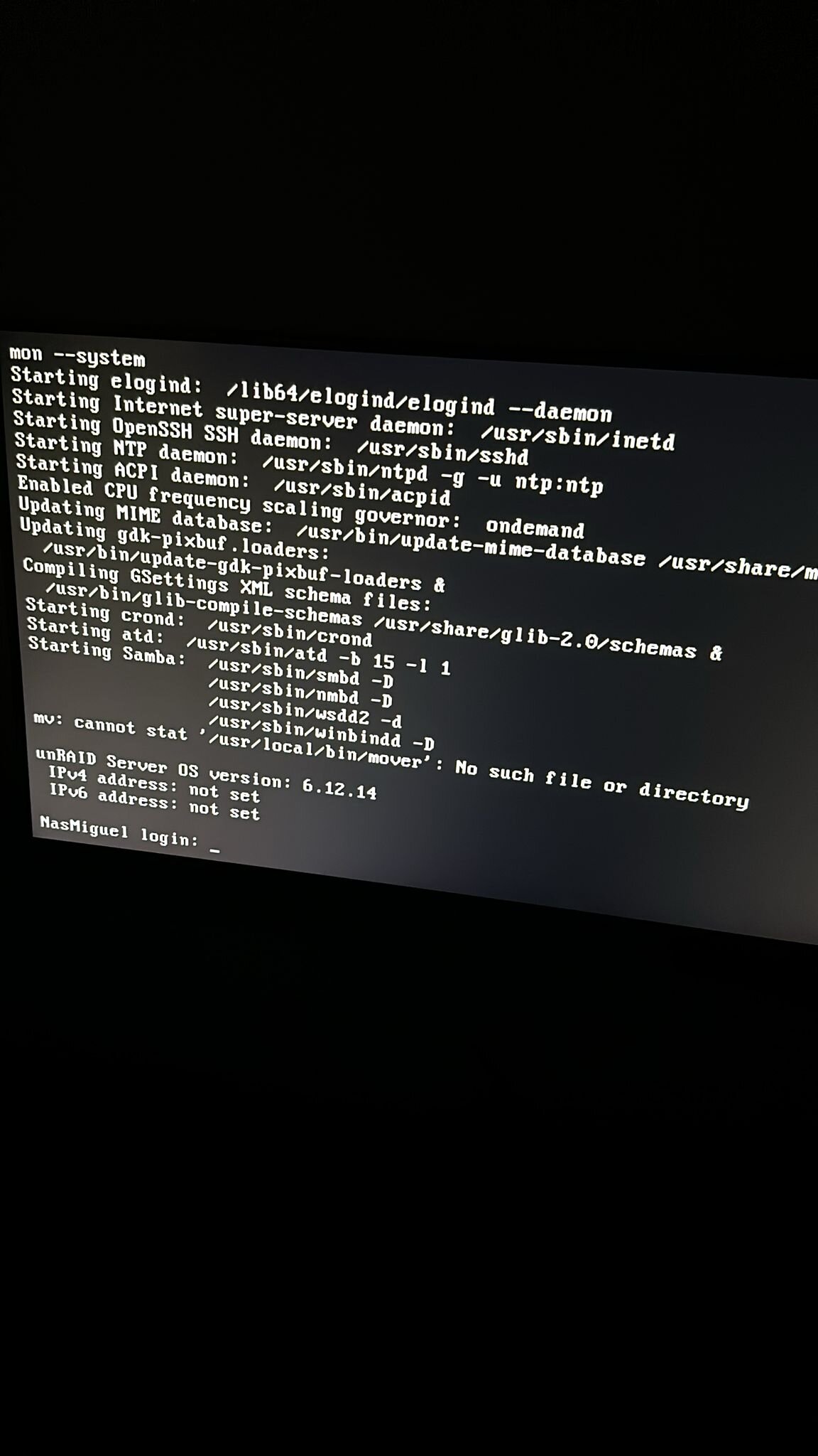

i deleted the network.cfg but doesnt have any ip now.

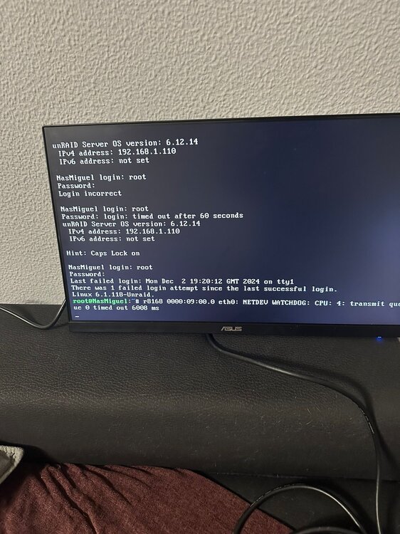

17 minutes ago, migasrt3 said:
ImagemWhatsApp2024-12-02s22_11.03_8275ee70.thumb.jpg.50b167635143e1eacd4b7fe84f19c254.jpg
then at unraid grub boot menu boot to gui mode.

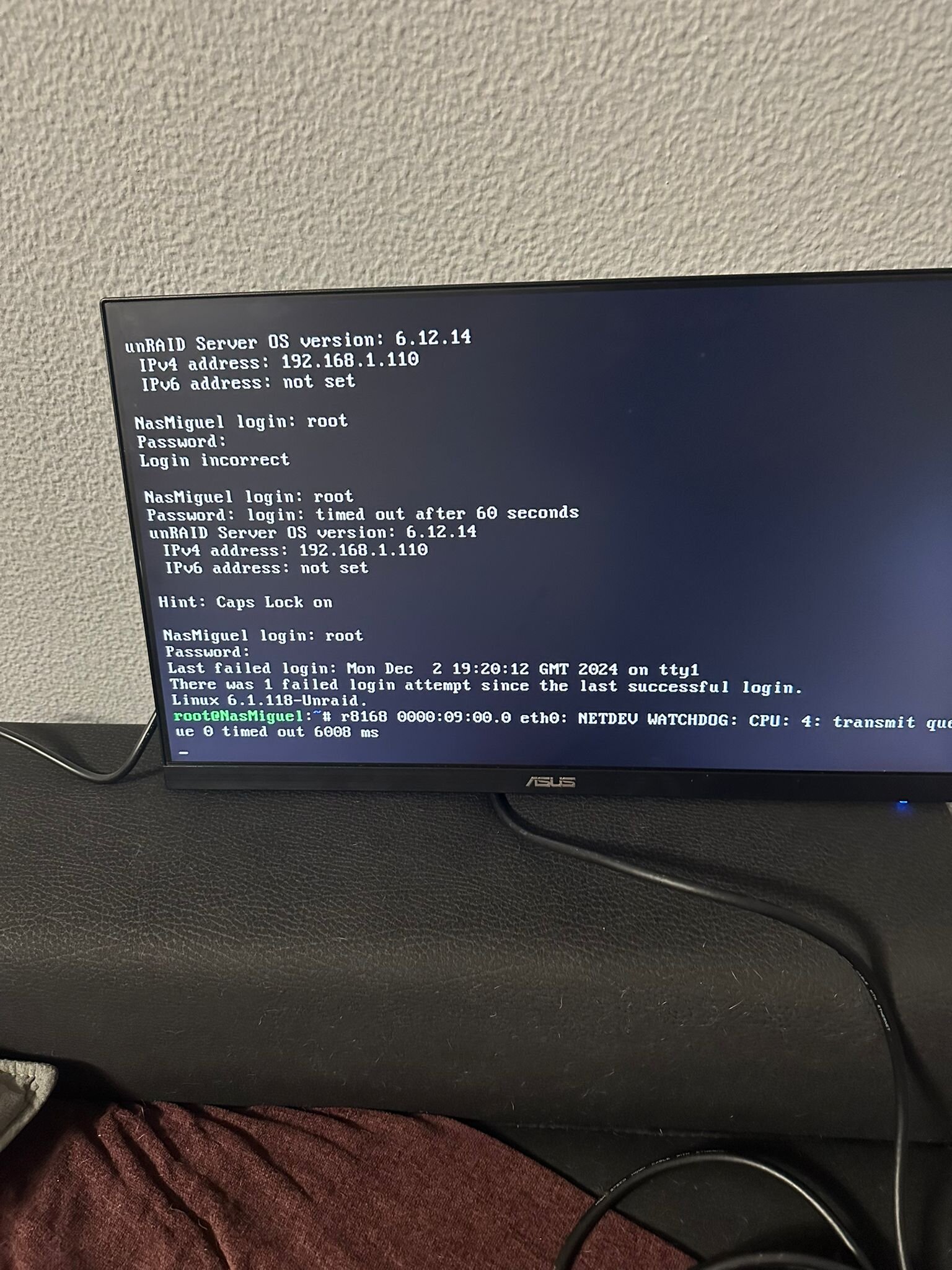

5 hours ago, migasrt3 said:
@foo98
I have the same problem. How did you manage to uninstall the plugin?
I used another computer to download 6.12.13 from the website. Then I deleted everything from the usb except the config directory. Then I copied all the contents of the downloaded 6.12.13 except the config directory onto the usb. It rebooted back into 6.12.13 with my all my settings intact.  Then when it was running, I removed the network driver plugin, updated, and it worked out.
