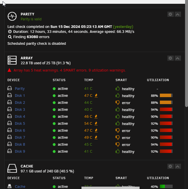

December 25, 20241 yr Author Merry Christmas to you. So disk 6 is all rebuilt and up and running, do i need to change ALL the disks showing error ? i think a couple are heat errors which i will be resolving when i get a variable potentiometer to briing the fan bank voltage down. Disk2 was needing replacing and then i ran into to problems with disk 6, so should i go ahead with replacing disk2 ? warptower-diagnostics-20241225-1203.zip
December 25, 20241 yr 59 minutes ago, loady said: should i go ahead with replacing disk2 ? Yep, since that one is clearly failing, disks 7 and 8 are showing some issues, but there weren't any read errors during disk's 6 rebuild, so they are OK for now.
