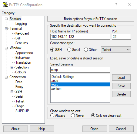

  11. Looking good, zero errors...problem now is if i start the docker service the drives are going crazy and its just locking up, i also want to add the two 12TB drives i got for dual parity Doesnt seem to want to shut down now with power button, even after an hour, i dont really want to cold shut down it, are these SSH settings correct ?
