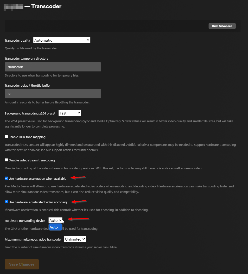

I think the issue is 'Hardware transcoding device' does not show the GPU it only shows 'Auto' and my guess it round robins. However I can not figure out why the GPU is not showing in the drop down.

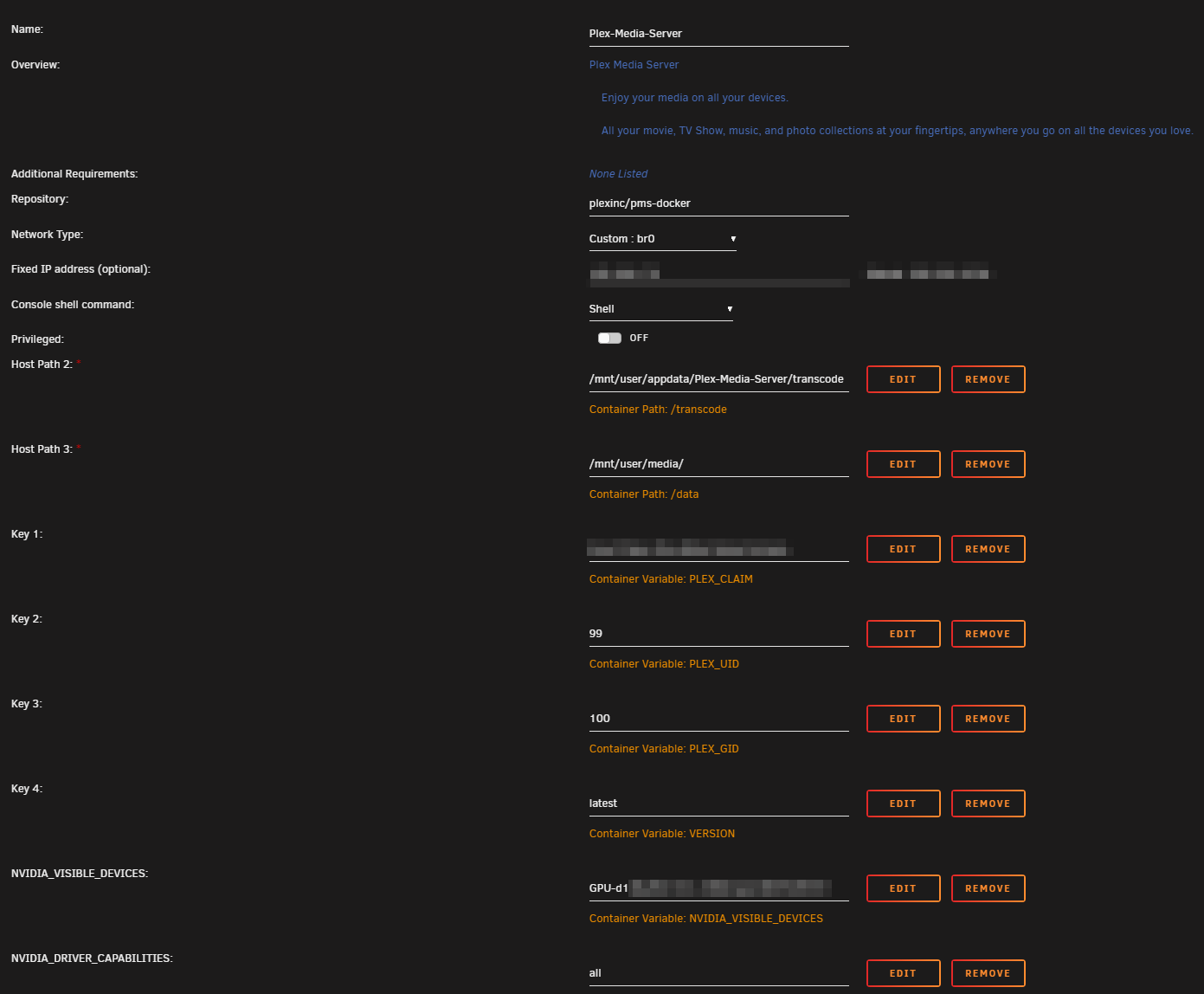

My setup:

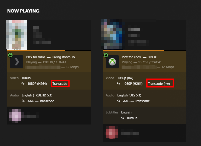

Example of what I am seeing:

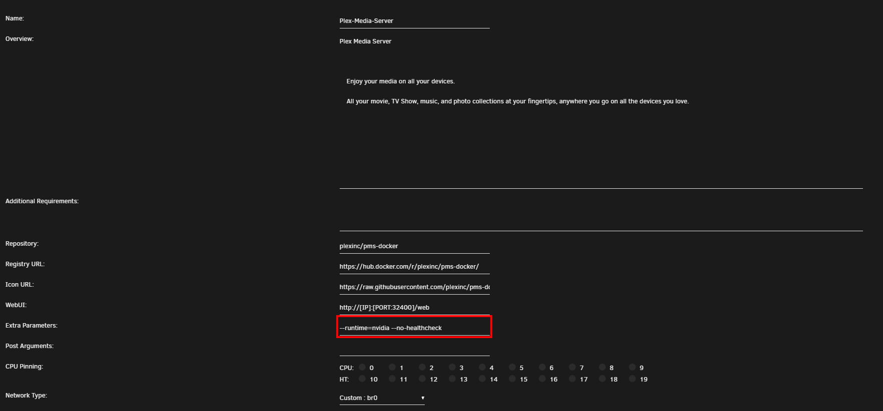

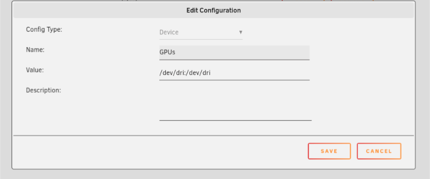

I'm having a similar issue, but I have a few things to add that might improve your situation.
There is a separate docker image for plex pass:
plexinc/pms-docker:plexpass
Also I have added a device to the configuration, which allows me to pick my GPU:
Again I'm having the same issue, except for me sometimes I'll open up a movie and it will work my CPU pretty hard without hw encoding, so I'll close it and open it again, and it will run just fine hw encoding (at least what I observe, it isn't hitting the CPU hard).

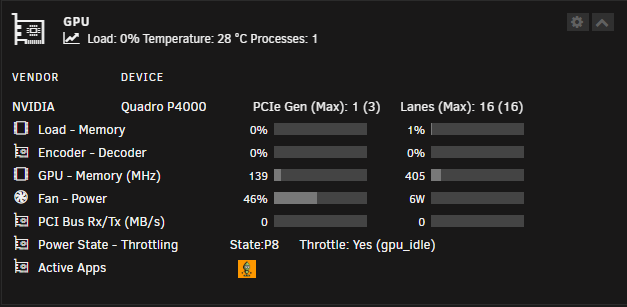

This is happening to me right now, but when something transcodes, I see that plex is still using the gpu with the GPU Statistics plugin.
Gpu in question is an rtx 4000 ada sff
