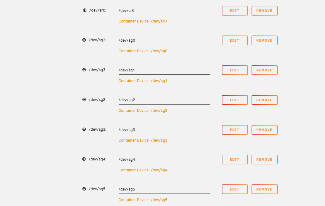

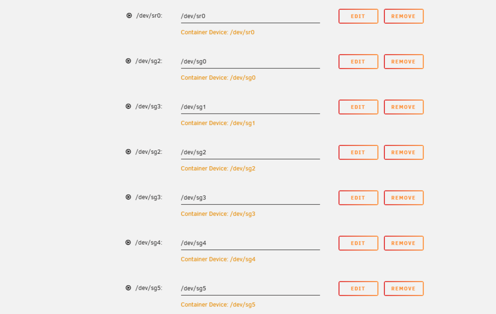

For whatever reason a full restart of unraid is going to resolve this issue. The rebuild is only 80% done though so I have time to try some other things if anyone has any ideas.
You may not be passing the disk drive properly to the docker... exmpale makmkv:
It's being passed as a device/properly (but only sr0, no other devices).
I can reproduce this in unraid managed containers, or just in compose (If I come across more examples of discussions of this (a restart making the disk drive work again) online I will edit the initial post).
Usually you need /dev/sr0 and /dev/sg1
this sounds like the loppback on how linux handles dvd/blueray burner is usd at first read in /dev/sg0 and after it loop backs to the next /dev/sg1 etc...
It why I shared the
ls /dev/{cdrom,sr*,sg*}
lshw -C disk
you would need to pass more for that device its like passing a prt of the disk drive not the entire disk drive...
also the echo command should be a 1 or 2 in the unbind folder and 1 or 2 in the bind folder. the tee comand is to view the value set.
@bmartino1 Well you helped me get to the root(s) of the issue!
#1 I had an expired key for MakeMKV. I resolved that.
#2 The disk I have been testing is not detected on my other players. I should have tested the disk to start with.
It could be the unmount would resolve this (The issue I thought I was having) issue. I will await the next time AMD has an issue with my reader, and test that method again.
That's good to know, I will make sure both are passed through, I don't believe I have both passed through currently.
Edited by paperblankets
