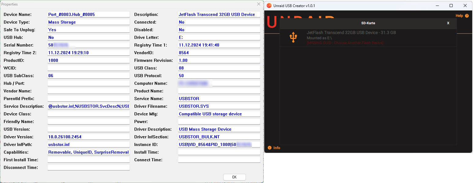

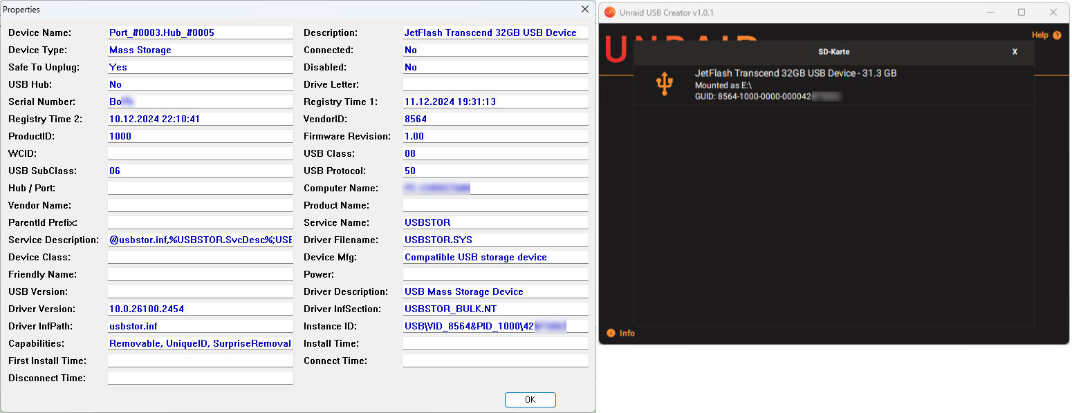

Now I checked all three sticks with the Unraid USB-Creator if the sticks have an unique GUID.
Unraid USB-Creator has accepted two of the sticks, but for the third stick there wasn't shown an GUID.
Now I've read out the data of each stick via USB-View and compared them. Every stick has a proper
deposited Instance ID, which seems to be responsible for the GUID.
Here I can't see any reasons, why the GUID from the third stick isn't shown by the Unraid USB-Creator.
Please see the attached screenshots. (Compare Stick No1 / No2 with Stick No3)
Is there possibly a bug in the Unraid USB-Creator-Software? (Version 1.0.1)

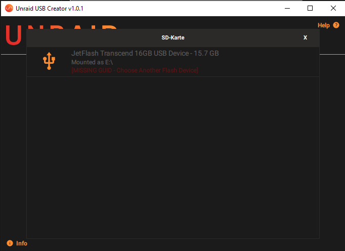

I also bought a Transcent USB-stick recently and it doesnt show me a GUID (JetFlash 600 16 GB; TS16GJF600). According to device properties there should be one. Do you have a solution for your USB-stick or did you return it?
Thanks, I tried and it worked. Is there an issue with the USB-creator or is it a problem of the stick?
