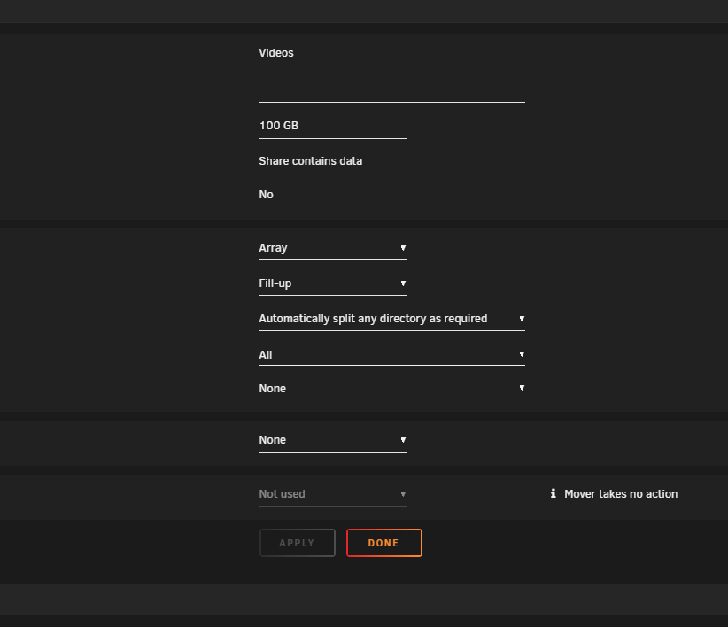

What is the split level set to? What happens with rsync is that it creates all the directories first before transferring any files. So if you have anything other then "Automatically split any dictreory as required" as split level, it will try to keep files together until it runs out of space as split level trumps allocation method.
its set to the default  automaticlly  split any directory as required...
doesnt the --delete option on the rsync  also fix that so it can delete files and move them too
so i should set it to automatically split any directory as required....  i never know the right option for these so ive always left them at default
Do you have cache setup as the primary storage on the remote machine? Do you have any disks in the included/excluded setting and if yes what are those? If split level and the included/excludes settings are set correctly it should hop to the next drive when the minimum space is reached. Maybe post your diagnostics?
