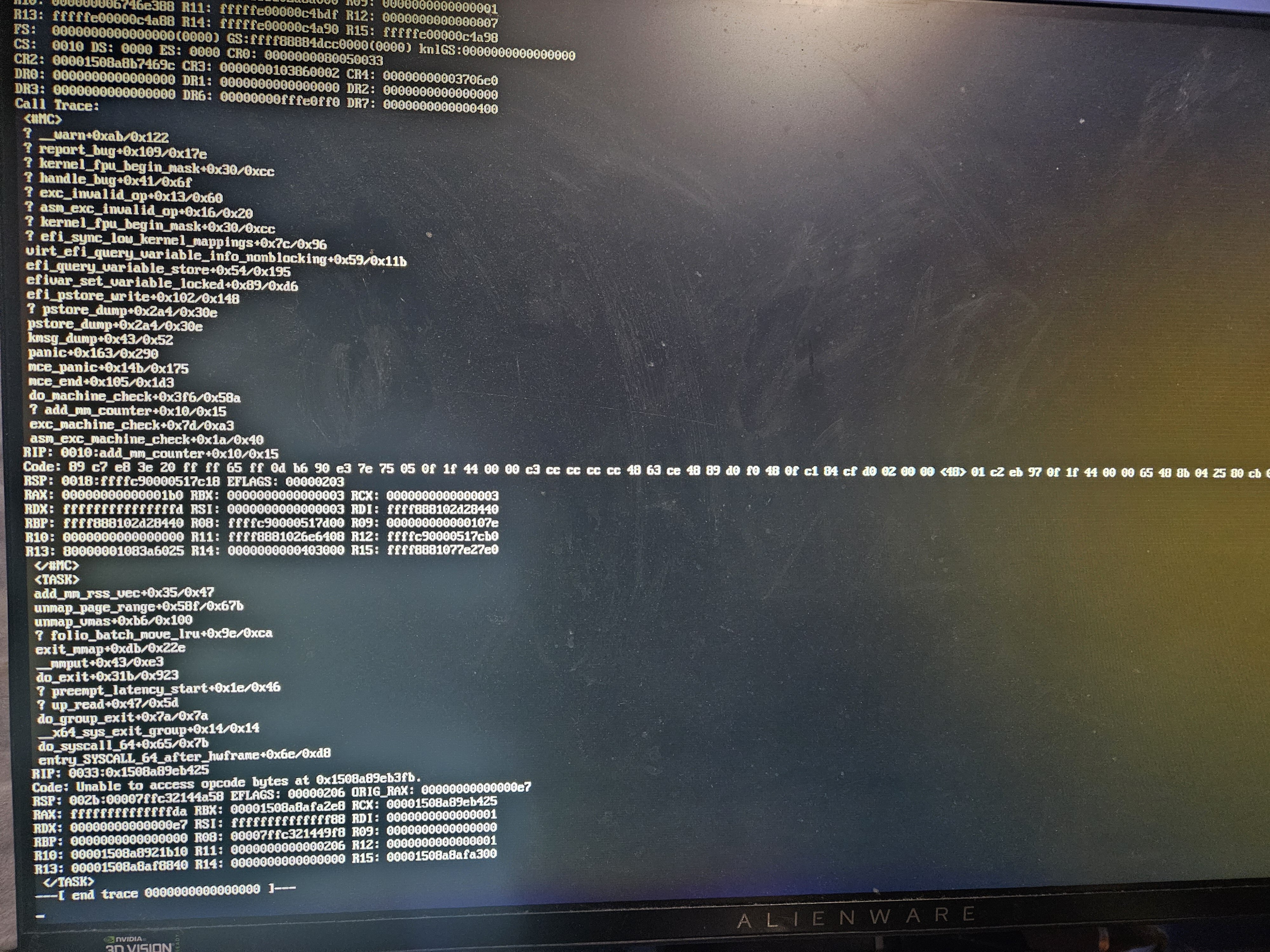

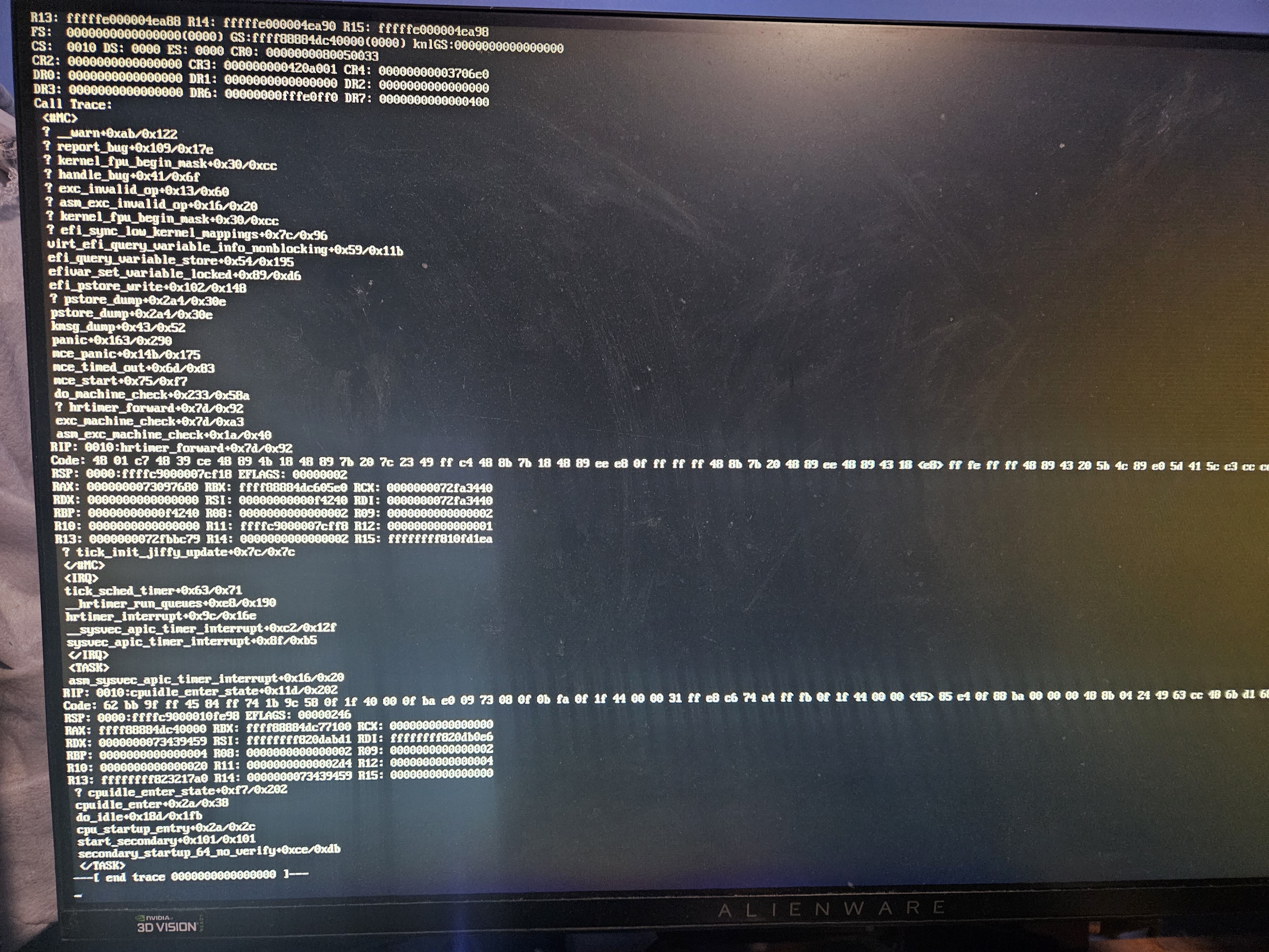

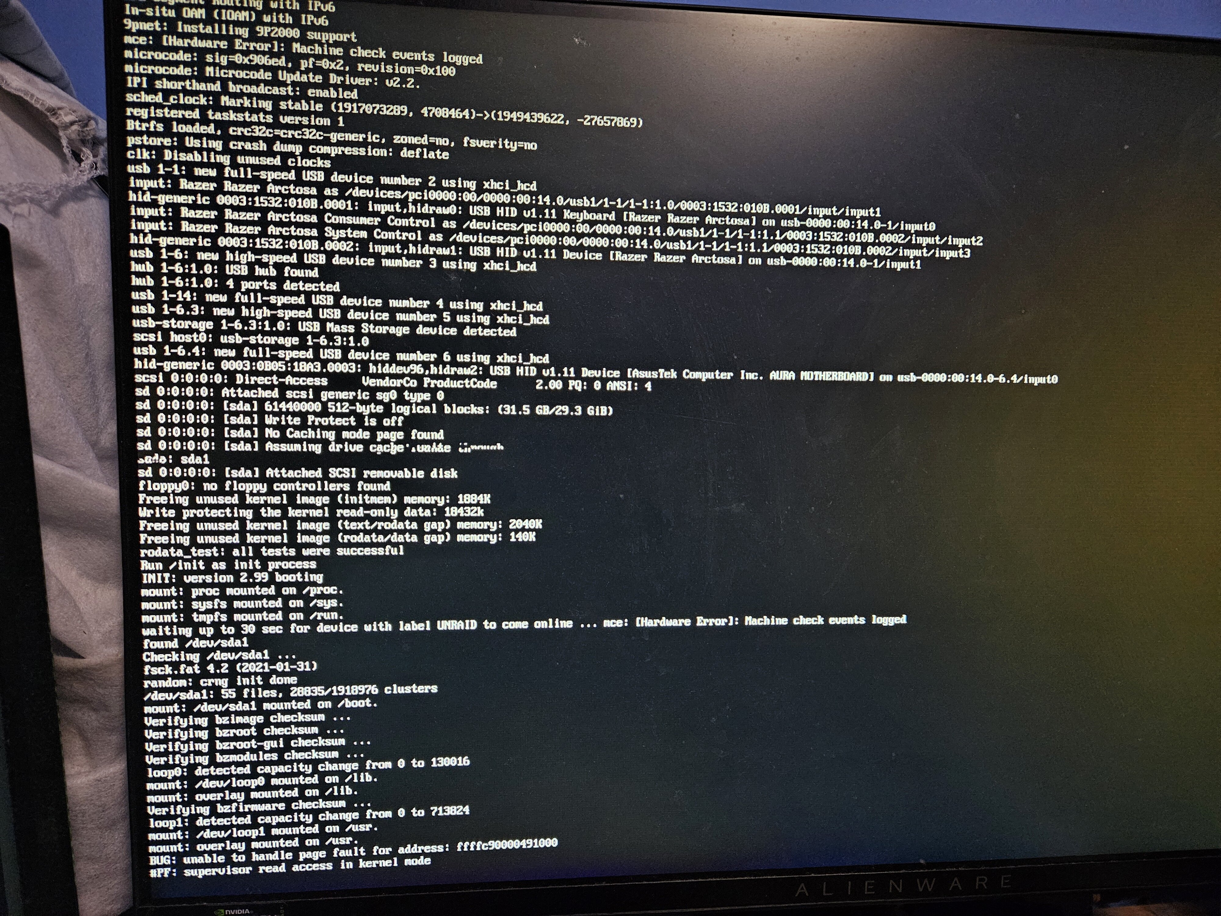

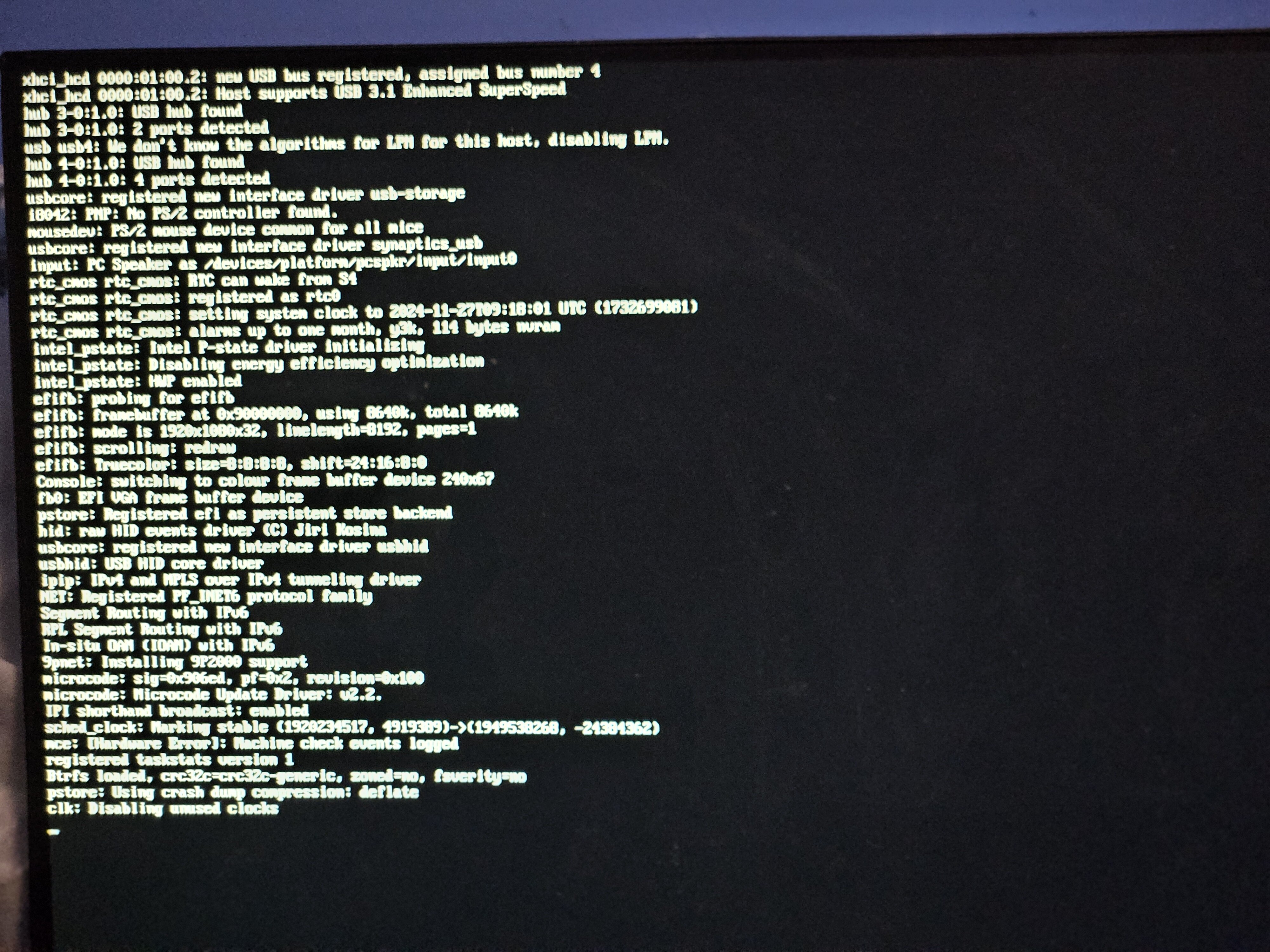

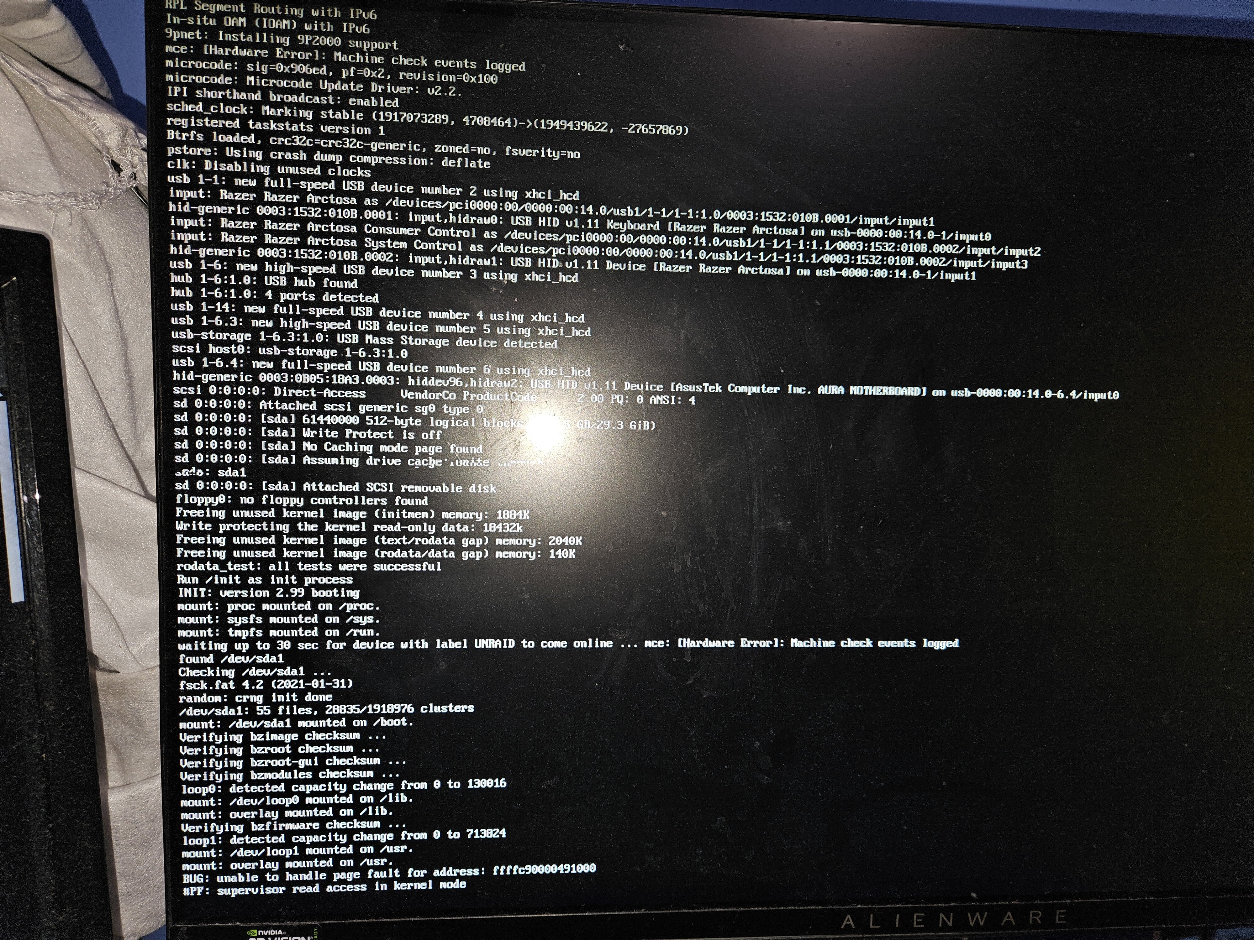

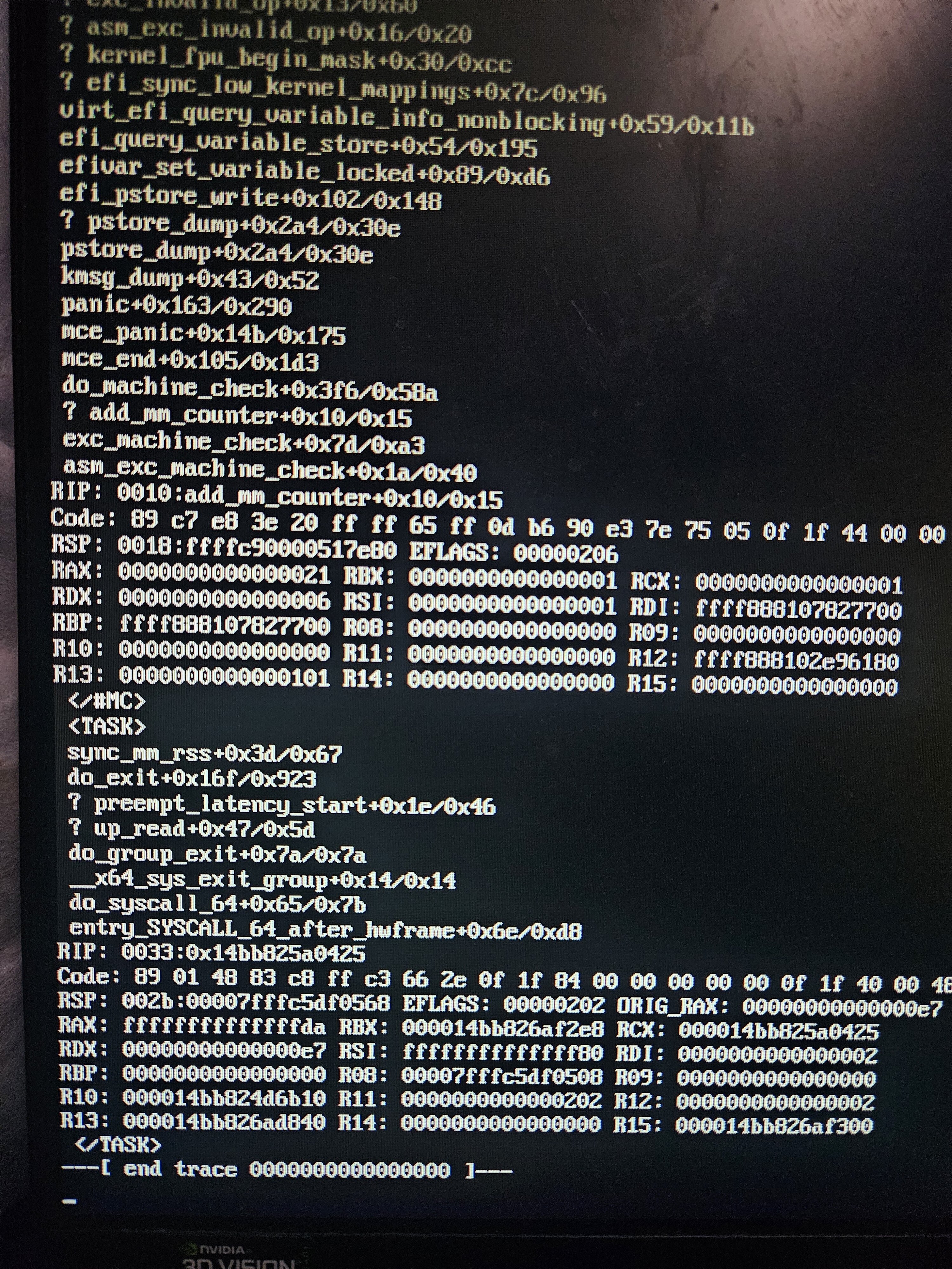

Unraid has been working fine for years. But it now will not start. It will boot to bios and then appear as if it is starting but will either get stuck in the starting process or get to a particular section and then restart in a loop forever.
I have changed multiple settings in BIOS (Secure boot, Fast boot, CSM) which have not helped.
I have also tried using a fresh USB. I have completed fresh installs both with and without the previous config folder. Nothing is working.
I have completed Memtest86+ and this Passes fine.
I have attached some pictures of where it is getting stuck in the boot process.

If a flash drive with a stock install also doesn't work, it suggests a hardware issue.
Have you tried booting from a different USB port? USB2 port is more reliable for this.
