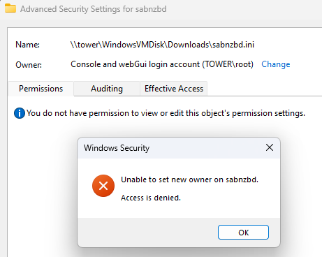

Locally on my windows PC. - Previously I was able to..  but like i said, the main thing was all kinds of weird permission issues with Sabnzb that got my attention..   I was going to just copy the appdata config for it and then remove it and reinstall it and have all the settings to check in the config but not able to open/copy it.
You gave me an idea to try to do it from Shares Tab and I did Copy, but when I went to open the file, it's the same thing.  I tried to change permissions but it still won't allow me.    Even tried to use root but nothing worked.

appdata permissions are not necessarily conducive to sharing / editing over a network.  You can always use dynamix file manager to edit any given file

Like mentioned by Squid, you should not try to access apddata over SMB because they can have specif permissions, it should be done locally.
