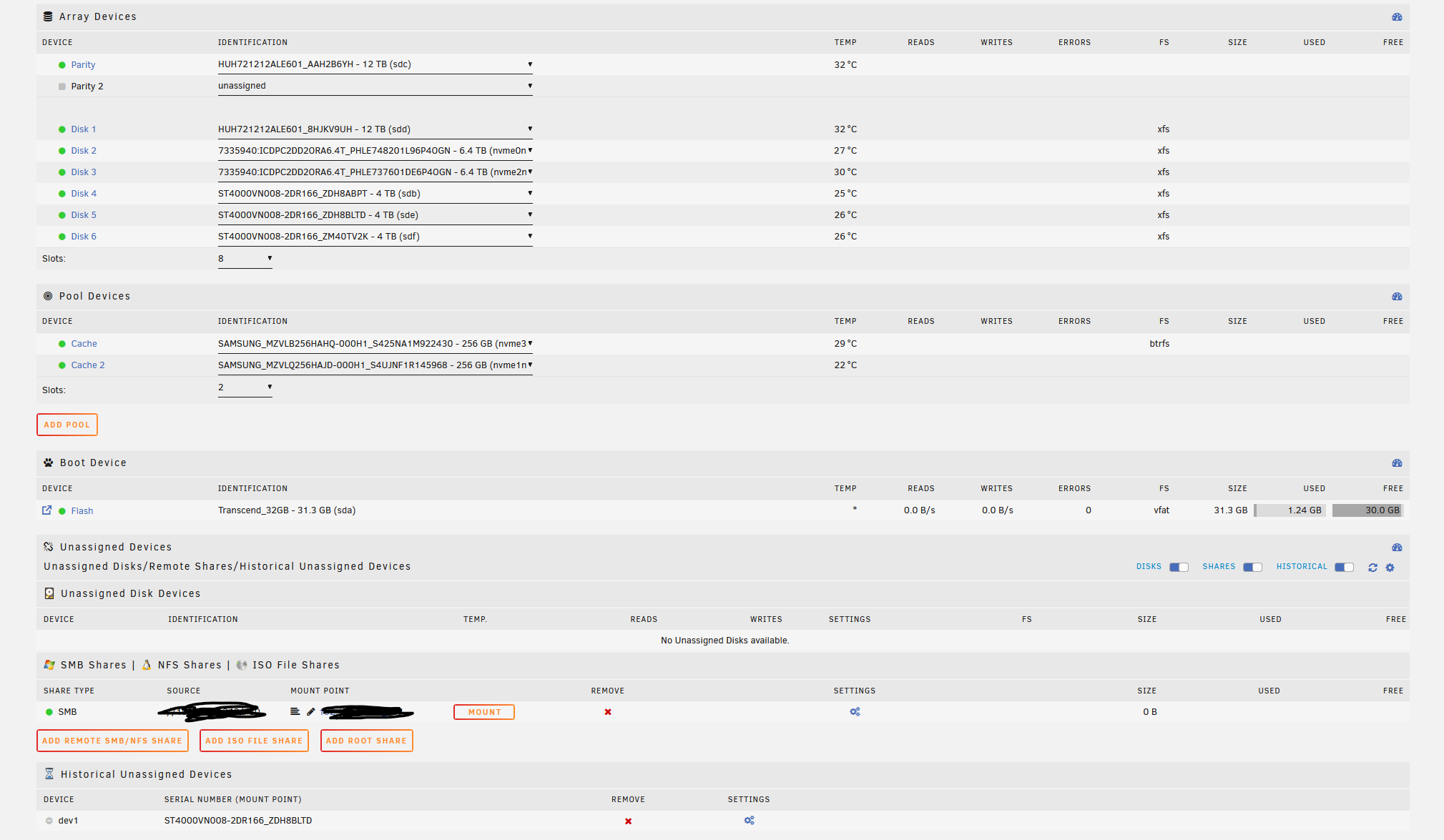

i have the same error, i have no "remove pool" button

8 minutes ago, neo404 said:
i have the same error but im not sure if we are facing the same issue,
If it's the same error you can do that, should resolve the issue, and if it doesn't, it won't do any damage.
If it doesn't work, then post the diagnostics.
31 minutes ago, neo404 said:
attached is my diagnostics log
Looks like the same issues, do the steps above, it should resolve it.
