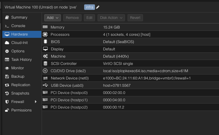

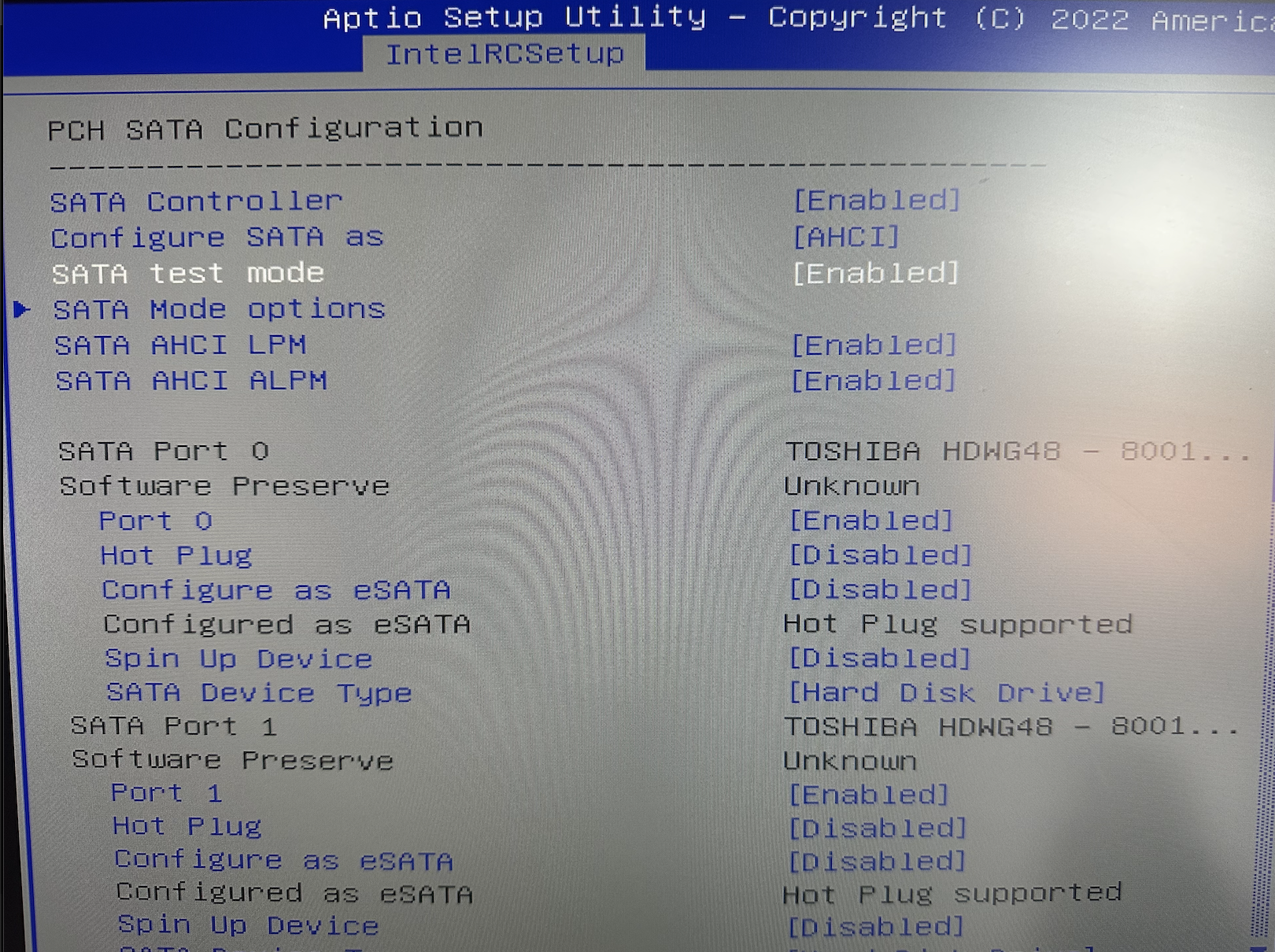

  3. It was already set as AHCI. Maybe something wrong in proxmox config?
  4. I thought I had passtrhu the devices correctly? What should I do? Is it safe do reboot unraid and try to start the array again? 02:00.0 and 04:00.0 are my NVMES used in cache. 1f.2 is my entire sata controller from motherboard

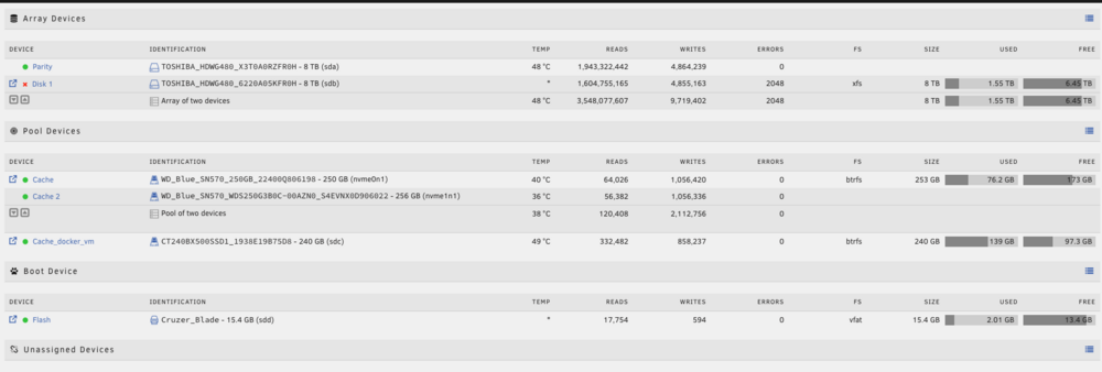

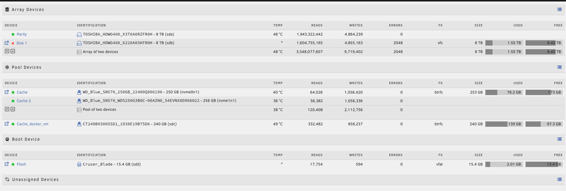

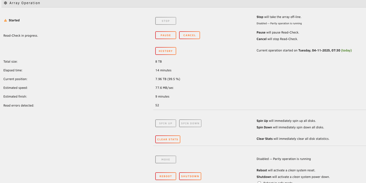

  6. I was running a parity check and I got some read errors. After a while, my disk went offline. Parity is almost finishing but I'm not sure what I should do next to keep my files safe. Has my HD gone bad? What steps should I take to make my array protected again? I'm attaching diagnostics and some screenshots. I'm running Unraid on Proxmox. magonhacloud-diagnostics-20251104-0741.zip
