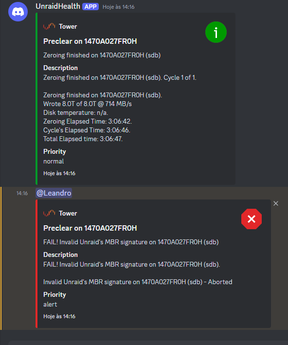

Reallocated sector count on new parity drive
So it became faster after a while and it just finished with this error (discord notification): Despite the error, would you say its erased?
