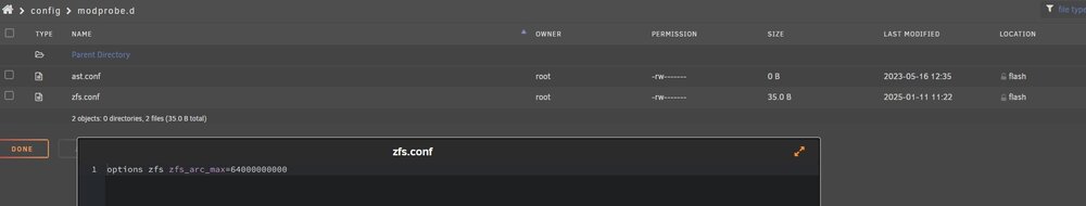

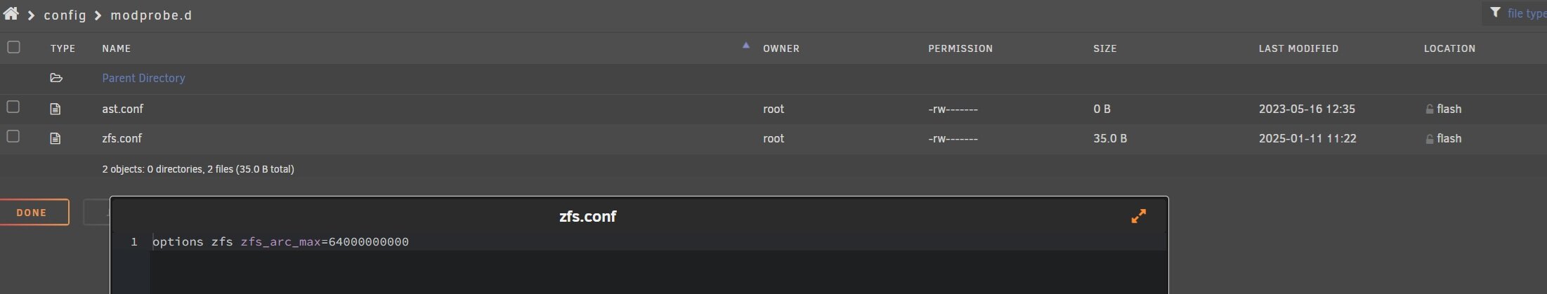

Hey peeps. I've tried for months now to increase my ZFS cache memory usage but it's stuck at 32gb. I have 128gb in my server and want to take the cache up to atleast 64gb. I originally created the zfs.conf file manually, tweaked and messed with the file and syntax but no change. I've recently used the gui option in system drivers and no change. I've deleted the file and recreated using just the gui as one post suggested, checked for spaces etc but still no luck.
Flash drive:
config/modprobe.d/zfs.conf  options zfs zfs_arc_max=64000000000

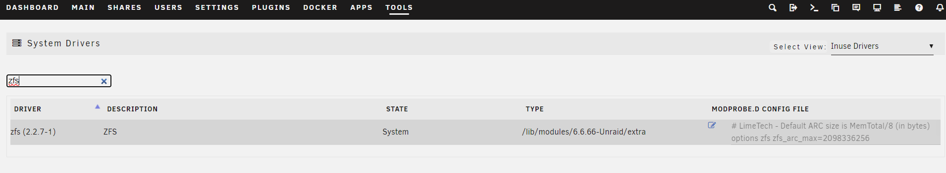

GUI: Tools/system drivers
zfs (2.2.7-1)  ZFS  Custom  /lib/modules/6.6.68-Unraid/extra  options zfs zfs_arc_max=64000000000

I've done that (I think). It also gets saved in the same place when editing system driver.
Post a screenshot from System drivers zfs
Everything looks normal to me, not sure what it could be, try booting with a different flash drive, using a stock install, no key needed, just create the modprobe folder and copy the attached file there, rename it to zfs.conf and get the ARC stats after boot, just in case there's something else interfering.
