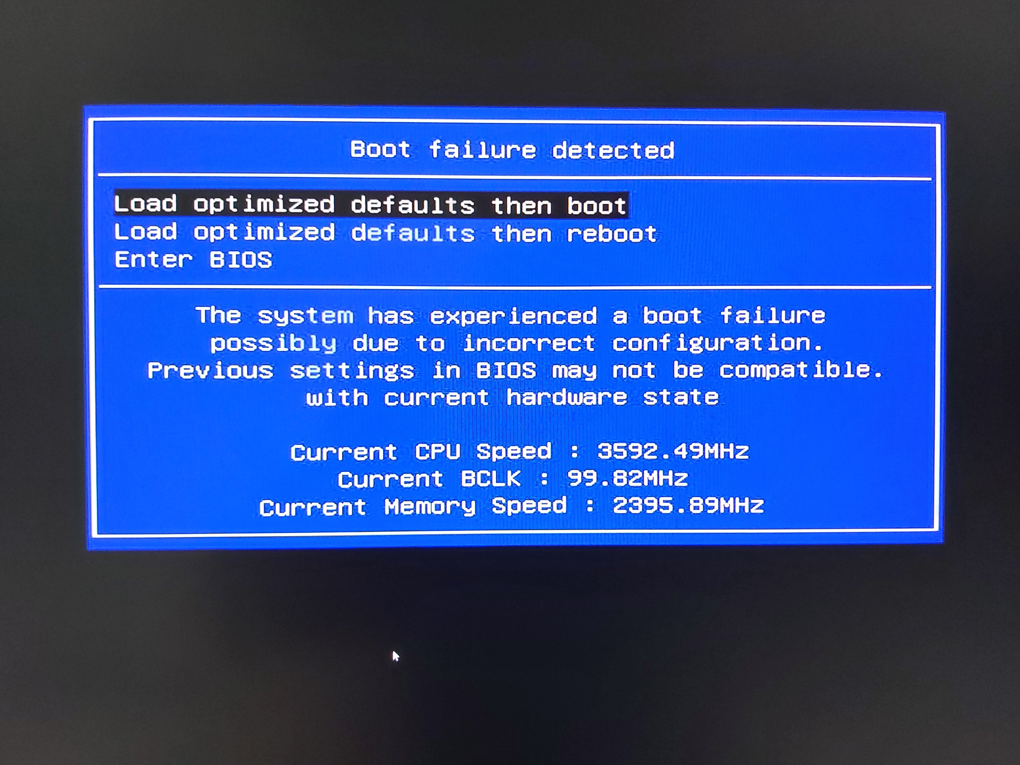

2. When I start it with the NVME connected, I get the Mainboard manufacture's logo and then the attached error (Gigabyte board).

28 minutes ago, cj_obob said:
The USB stick seems to be ok.
The USB stick is either NOT ok, or your MB is not set to boot from it.
Suggest loading up a trial USB stick and see if it fires up.
I have loaded a trial stick, but I got the same bios error. Edit: The boot order was set correctly to boot from the USB stick.
Next, I confirmed "Load optimized defaults then boot", and now it booted without issues!
Then, I tried my original stick, and it also worked, I can log in again via the Web GUI.
