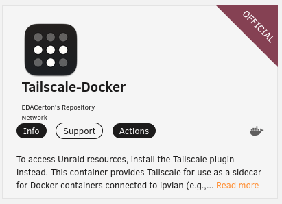

However you can always use a Tailscale sidecar container to get the container into your Tailnet or you could also share the container network with a container where the Unraid Docker Integration is working.

As mentioned above, please use the Tailscale Sidecar Docker for that container:
Is there a guide for how to configure this? I can install Tailscale-Docker but I have no idea how to set it.
