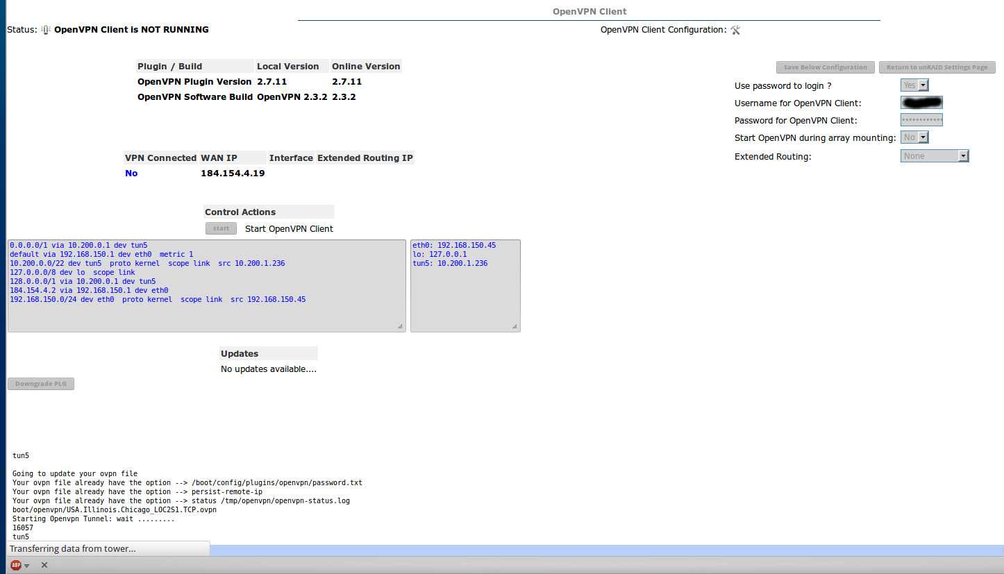

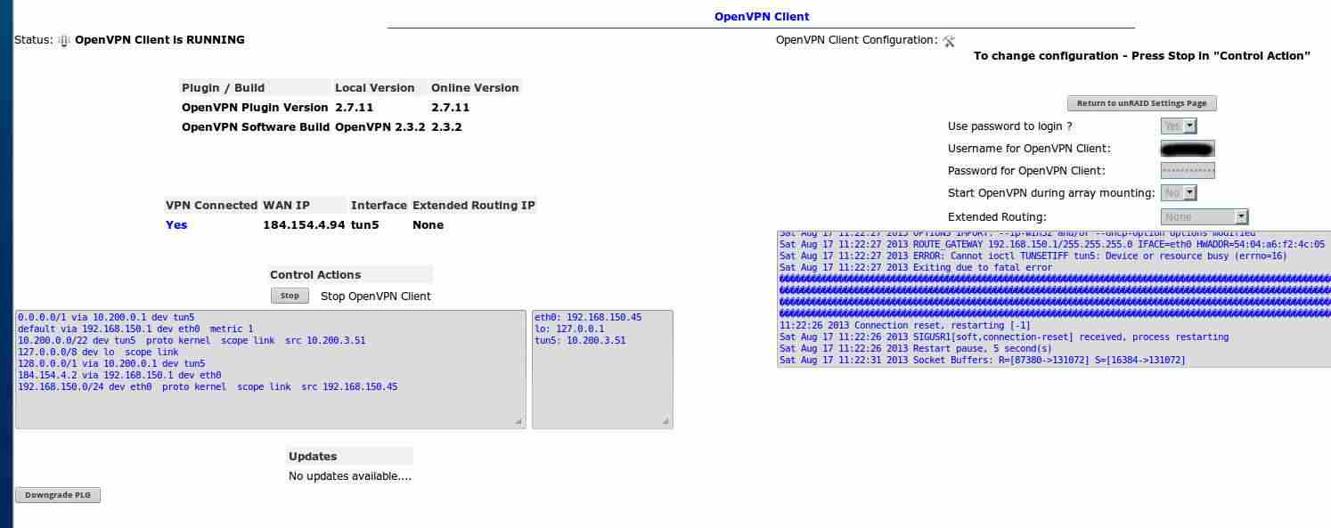

A bit long, but trying to get you the most info...

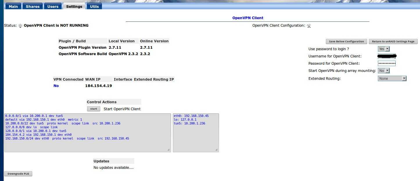

Upgraded to 2.7.11.  Clicked start and said it was connected, yet the plugin did not update status.  Attached is screenshot - OpenVpnPlugin2711.jpg.  Same behavior it had with 2.7.10 in my case.  If I click start again I go into an incredibly long wait - upwards of 5-10 minutes.  I had to hard reset last night because even a telnet powerdown would not free it up after 20+ minutes.  Below is a snippet of the syslog from 2.7.11.  Last night the line 'Aug 17 11:22:36 Tower avahi-daemon[23050]: Withdrawing workstation service for tun5.' would cycle between tun0 and tun1 for minutes on end.
Pic attachments:
OpenVPNPlugin2711.jpg: First 'start' click - assigned tun5, buy did not connect
OpenVpnPlugin2711-1.jpg: Second 'start' click - no other changes
OpenVPNPlugin2711-2.jpg: Results after waiting a few minutes

This is the openvpn log after it connected:
Sat Aug 17 11:22:22 2013 OpenVPN 2.3.2 i486-slackware-linux-gnu [sSL (OpenSSL)] [LZO] [EPOLL] [eurephia] [MH] [iPv6] built on Jun 22 2013
Sat Aug 17 11:22:22 2013 WARNING: file '/boot/config/plugins/openvpn/password.txt' is group or others accessible
Sat Aug 17 11:22:22 2013 Socket Buffers: R=[87380->131072] S=[16384->131072]
Sat Aug 17 11:22:22 2013 Attempting to establish TCP connection with [AF_INET]184.154.4.2:443 [nonblock]
Sat Aug 17 11:22:23 2013 TCP connection established with [AF_INET]184.154.4.2:443
Sat Aug 17 11:22:23 2013 TCPv4_CLIENT link local: [undef]
Sat Aug 17 11:22:23 2013 TCPv4_CLIENT link remote: [AF_INET]184.154.4.2:443
Sat Aug 17 11:22:23 2013 TLS: Initial packet from [AF_INET]184.154.4.2:443, sid=03221499 dc657805
Sat Aug 17 11:22:23 2013 WARNING: this configuration may cache passwords in memory -- use the auth-nocache option to prevent this
Sat Aug 17 11:22:23 2013 VERIFY OK: depth=1, C=UK, ST=NR, L=Attleborough, O=Hide My Ass! Pro, OU=VPN, CN=vpn.hidemyass.com, [email protected]
Sat Aug 17 11:22:23 2013 VERIFY OK: nsCertType=SERVER
Sat Aug 17 11:22:23 2013 VERIFY OK: depth=0, C=UK, ST=NR, L=Attleborough, O=Hide My Ass! Pro, OU=VPN, CN=server, [email protected]
Sat Aug 17 11:22:25 2013 Data Channel Encrypt: Cipher 'BF-CBC' initialized with 128 bit key
Sat Aug 17 11:22:25 2013 Data Channel Encrypt: Using 160 bit message hash 'SHA1' for HMAC authentication
Sat Aug 17 11:22:25 2013 Data Channel Decrypt: Cipher 'BF-CBC' initialized with 128 bit key
Sat Aug 17 11:22:25 2013 Data Channel Decrypt: Using 160 bit message hash 'SHA1' for HMAC authentication
Sat Aug 17 11:22:25 2013 Control Channel: TLSv1, cipher TLSv1/SSLv3 DHE-RSA-AES256-SHA, 1024 bit RSA
Sat Aug 17 11:22:25 2013 [server] Peer Connection Initiated with [AF_INET]184.154.4.2:443
Sat Aug 17 11:22:27 2013 SENT CONTROL [server]: 'PUSH_REQUEST' (status=1)
Sat Aug 17 11:22:27 2013 PUSH: Received control message: 'PUSH_REPLY,topology subnet,route-gateway 10.200.0.1,dhcp-option DNS 208.67.222.222,dhcp-option DNS 208.67.220.220,redirect-gateway def1,ifconfig 10.200.2.122 255.255.252.0'
Sat Aug 17 11:22:27 2013 OPTIONS IMPORT: --ifconfig/up options modified
Sat Aug 17 11:22:27 2013 OPTIONS IMPORT: route options modified
Sat Aug 17 11:22:27 2013 OPTIONS IMPORT: route-related options modified
Sat Aug 17 11:22:27 2013 OPTIONS IMPORT: --ip-win32 and/or --dhcp-option options modified
Sat Aug 17 11:22:27 2013 ROUTE_GATEWAY 192.168.150.1/255.255.255.0 IFACE=eth0 HWADDR=54:04:a6:f2:4c:05
Sat Aug 17 11:22:27 2013 ERROR: Cannot ioctl TUNSETIFF tun5: Device or resource busy (errno=16)
Sat Aug 17 11:22:27 2013 Exiting due to fatal error
??????????????????????????????????????????????????????????????????????????????????????????????????????????????????????????????????????????????????????????????????????????????????????????????????????????????????????????????????????????????????????????????????????????????Sat Aug 17 11:22:26 2013 Connection reset, restarting [-1]
Sat Aug 17 11:22:26 2013 SIGUSR1[soft,connection-reset] received, process restarting
Sat Aug 17 11:22:26 2013 Restart pause, 5 second(s)
Sat Aug 17 11:22:31 2013 Socket Buffers: R=[87380->131072] S=[16384->131072]
Sat Aug 17 11:22:31 2013 TCP/UDP: Preserving recently used remote address: [AF_INET]184.154.4.2:443
Sat Aug 17 11:22:31 2013 Attempting to establish TCP connection with [AF_INET]184.154.4.2:443 [nonblock]
Sat Aug 17 11:22:32 2013 TCP connection established with [AF_INET]184.154.4.2:443
Sat Aug 17 11:22:32 2013 TCPv4_CLIENT link local: [undef]
Sat Aug 17 11:22:32 2013 TCPv4_CLIENT link remote: [AF_INET]184.154.4.2:443
Sat Aug 17 11:22:32 2013 TLS: Initial packet from [AF_INET]184.154.4.2:443, sid=103c880c cd91ceed
Sat Aug 17 11:22:32 2013 VERIFY OK: depth=1, C=UK, ST=NR, L=Attleborough, O=Hide My Ass! Pro, OU=VPN, CN=vpn.hidemyass.com, [email protected]
Sat Aug 17 11:22:32 2013 VERIFY OK: nsCertType=SERVER
Sat Aug 17 11:22:32 2013 VERIFY OK: depth=0, C=UK, ST=NR, L=Attleborough, O=Hide My Ass! Pro, OU=VPN, CN=server, [email protected]
Sat Aug 17 11:22:34 2013 Data Channel Encrypt: Cipher 'BF-CBC' initialized with 128 bit key
Sat Aug 17 11:22:34 2013 Data Channel Encrypt: Using 160 bit message hash 'SHA1' for HMAC authentication
Sat Aug 17 11:22:34 2013 Data Channel Decrypt: Cipher 'BF-CBC' initialized with 128 bit key
Sat Aug 17 11:22:34 2013 Data Channel Decrypt: Using 160 bit message hash 'SHA1' for HMAC authentication
Sat Aug 17 11:22:34 2013 Control Channel: TLSv1, cipher TLSv1/SSLv3 DHE-RSA-AES256-SHA, 1024 bit RSA
Sat Aug 17 11:22:34 2013 [server] Peer Connection Initiated with [AF_INET]184.154.4.2:443
Sat Aug 17 11:22:36 2013 SENT CONTROL [server]: 'PUSH_REQUEST' (status=1)
Sat Aug 17 11:22:36 2013 PUSH: Received control message: 'PUSH_REPLY,topology subnet,route-gateway 10.200.0.1,dhcp-option DNS 208.67.222.222,dhcp-option DNS 208.67.220.220,redirect-gateway def1,ifconfig 10.200.3.51 255.255.252.0'
Sat Aug 17 11:22:36 2013 OPTIONS IMPORT: --ifconfig/up options modified
Sat Aug 17 11:22:36 2013 OPTIONS IMPORT: route options modified
Sat Aug 17 11:22:36 2013 OPTIONS IMPORT: route-related options modified
Sat Aug 17 11:22:36 2013 OPTIONS IMPORT: --ip-win32 and/or --dhcp-option options modified
Sat Aug 17 11:22:36 2013 Preserving previous TUN/TAP instance: tun5
Sat Aug 17 11:22:36 2013 NOTE: Pulled options changed on restart, will need to close and reopen TUN/TAP device.
Sat Aug 17 11:22:36 2013 /usr/sbin/ip route del 184.154.4.2/32
Sat Aug 17 11:22:36 2013 /usr/sbin/ip route del 0.0.0.0/1
Sat Aug 17 11:22:36 2013 /usr/sbin/ip route del 128.0.0.0/1
Sat Aug 17 11:22:36 2013 Closing TUN/TAP interface
Sat Aug 17 11:22:36 2013 /usr/sbin/ip addr del dev tun5 10.200.1.236/22
Sat Aug 17 11:22:37 2013 ROUTE_GATEWAY 192.168.150.1/255.255.255.0 IFACE=eth0 HWADDR=54:04:a6:f2:4c:05
Sat Aug 17 11:22:37 2013 TUN/TAP device tun5 opened
Sat Aug 17 11:22:37 2013 TUN/TAP TX queue length set to 100
Sat Aug 17 11:22:37 2013 do_ifconfig, tt->ipv6=0, tt->did_ifconfig_ipv6_setup=0
Sat Aug 17 11:22:37 2013 /usr/sbin/ip link set dev tun5 up mtu 1500
Sat Aug 17 11:22:37 2013 /usr/sbin/ip addr add dev tun5 10.200.3.51/22 broadcast 10.200.3.255
Sat Aug 17 11:22:37 2013 /usr/sbin/ip route add 184.154.4.2/32 via 192.168.150.1
Sat Aug 17 11:22:37 2013 /usr/sbin/ip route add 0.0.0.0/1 via 10.200.0.1
Sat Aug 17 11:22:37 2013 /usr/sbin/ip route add 128.0.0.0/1 via 10.200.0.1
Sat Aug 17 11:22:37 2013 Initialization Sequence Completed

I could not connect until I broke up the line:
remote 184.154.4.2 443auth-user-pass /boot/config/plugins/openvpn/password.txt
I rebooted the server to see how it works from clean start.  First time clicking 'start' it ran through the connection, said it was connected in the log at the bottom, but the plugin still showed not connected with option of clicking start still enabled.  Tun5 was listed in the interface list.  I clicked start again and has been sitting there for the past 3-4 minutes.  The one line that is cut off by the 'waiting for tower' is ' Logging in to VPN was successful'. (OpenVPNPlugin2711-3.jpg)

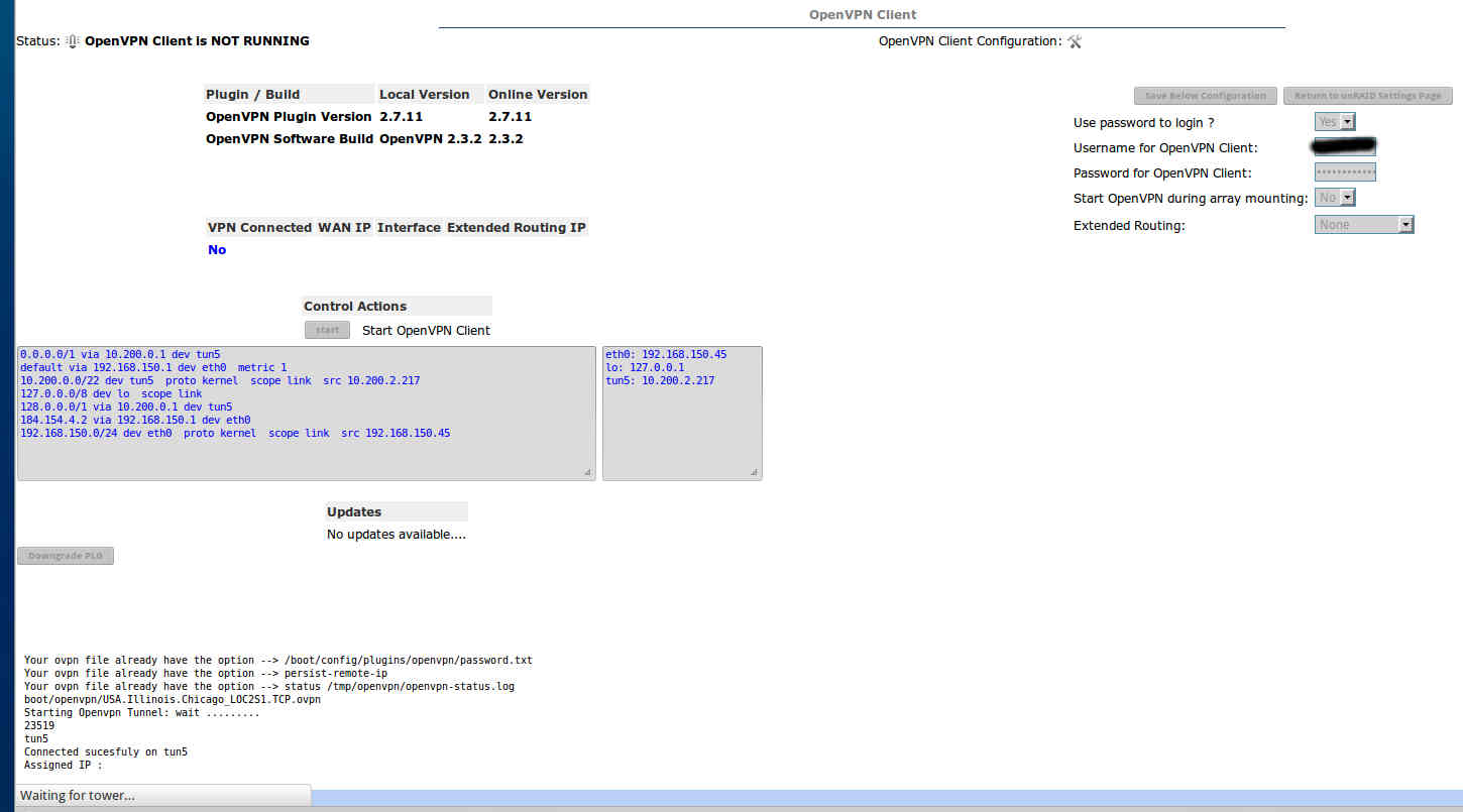

At 4-5 minutes the plugin updated.  'OpenVPNPlugin2711-4.jpg' is the result of that.
Openvpn log after second click of start and 4-5 minute delay:

At this point the VPN is connected and traffic is going in the tunnel, though the WAN IP is not listed in the plugin page as seen in the second screenshot.  Stopping and starting the plugin does not change the results (WAN IP).  Below is the last openvpn log:

Traffic is still going into the tunnel, however.
I have fixed the update of the ovpn  ;D, so the new updates going in to own line, new plugin will be uploaded later.....
going to check your other issue....

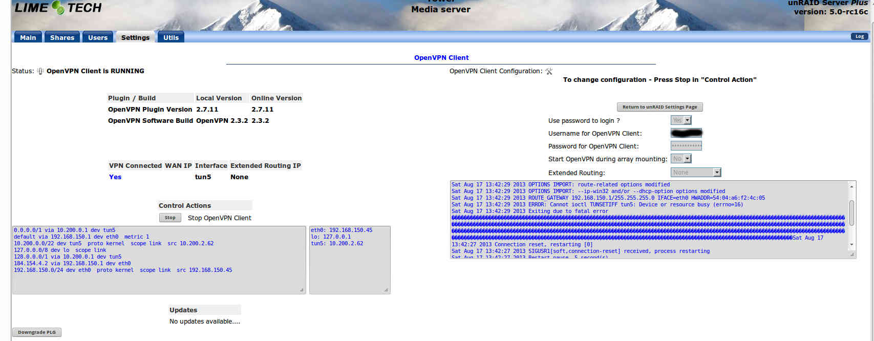

Output from plugin page when VPN connected:
0.0.0.0/1 via 10.200.0.1 dev tun5
default via 192.168.150.1 dev eth0  metric 1
10.200.0.0/22 dev tun5  proto kernel  scope link  src 10.200.2.62
127.0.0.0/8 dev lo  scope link
128.0.0.0/1 via 10.200.0.1 dev tun5
184.154.4.2 via 192.168.150.1 dev eth0
192.168.150.0/24 dev eth0  proto kernel  scope link  src 192.168.150.45
eth0: 192.168.150.45
lo: 127.0.0.1
tun5: 10.200.2.62
Sat Aug 17 13:42:24 2013 OpenVPN 2.3.2 i486-slackware-linux-gnu [sSL (OpenSSL)] [LZO] [EPOLL] [eurephia] [MH] [iPv6] built on Jun 22 2013

Sat Aug 17 13:42:29 2013 ROUTE_GATEWAY 192.168.150.1/255.255.255.0 IFACE=eth0 HWADDR=54:04:a6:f2:4c:05
Sat Aug 17 13:42:29 2013 ERROR: Cannot ioctl TUNSETIFF tun5: Device or resource busy (errno=16)
Sat Aug 17 13:42:29 2013 Exiting due to fatal error

Sat Aug 17 13:42:27 2013 SIGUSR1[soft,connection-reset] received, process restarting
Sat Aug 17 13:42:27 2013 Restart pause, 5 second(s)
Sat Aug 17 13:42:32 2013 Socket Buffers: R=[87380->131072] S=[16384->131072]
Sat Aug 17 13:42:32 2013 TCP/UDP: Preserving recently used remote address: [AF_INET]184.154.4.2:443
Sat Aug 17 13:42:32 2013 Attempting to establish TCP connection with [AF_INET]184.154.4.2:443 [nonblock]
Sat Aug 17 13:42:33 2013 TCP connection established with [AF_INET]184.154.4.2:443
Sat Aug 17 13:42:33 2013 TCPv4_CLIENT link local: [undef]
Sat Aug 17 13:42:33 2013 TCPv4_CLIENT link remote: [AF_INET]184.154.4.2:443
Sat Aug 17 13:42:33 2013 TLS: Initial packet from [AF_INET]184.154.4.2:443, sid=2a3099c8 80fe52d6
Sat Aug 17 13:42:34 2013 VERIFY OK: depth=1, C=UK, ST=NR, L=Attleborough, O=Hide My Ass! Pro, OU=VPN, CN=vpn.hidemyass.com, [email protected]
Sat Aug 17 13:42:34 2013 VERIFY OK: nsCertType=SERVER
Sat Aug 17 13:42:34 2013 VERIFY OK: depth=0, C=UK, ST=NR, L=Attleborough, O=Hide My Ass! Pro, OU=VPN, CN=server, [email protected]
Sat Aug 17 13:42:35 2013 Data Channel Encrypt: Cipher 'BF-CBC' initialized with 128 bit key
Sat Aug 17 13:42:35 2013 Data Channel Encrypt: Using 160 bit message hash 'SHA1' for HMAC authentication
Sat Aug 17 13:42:35 2013 Data Channel Decrypt: Cipher 'BF-CBC' initialized with 128 bit key
Sat Aug 17 13:42:35 2013 Data Channel Decrypt: Using 160 bit message hash 'SHA1' for HMAC authentication
Sat Aug 17 13:42:35 2013 Control Channel: TLSv1, cipher TLSv1/SSLv3 DHE-RSA-AES256-SHA, 1024 bit RSA
Sat Aug 17 13:42:35 2013 [server] Peer Connection Initiated with [AF_INET]184.154.4.2:443
Sat Aug 17 13:42:37 2013 SENT CONTROL [server]: 'PUSH_REQUEST' (status=1)
Sat Aug 17 13:42:37 2013 PUSH: Received control message: 'PUSH_REPLY,topology subnet,route-gateway 10.200.0.1,dhcp-option DNS 208.67.222.222,dhcp-option DNS 208.67.220.220,redirect-gateway def1,ifconfig 10.200.2.62 255.255.252.0'
Sat Aug 17 13:42:37 2013 OPTIONS IMPORT: --ifconfig/up options modified
Sat Aug 17 13:42:37 2013 OPTIONS IMPORT: route options modified
Sat Aug 17 13:42:37 2013 OPTIONS IMPORT: route-related options modified
Sat Aug 17 13:42:37 2013 OPTIONS IMPORT: --ip-win32 and/or --dhcp-option options modified
Sat Aug 17 13:42:37 2013 Preserving previous TUN/TAP instance: tun5
Sat Aug 17 13:42:37 2013 NOTE: Pulled options changed on restart, will need to close and reopen TUN/TAP device.
Sat Aug 17 13:42:37 2013 /usr/sbin/ip route del 184.154.4.2/32
Sat Aug 17 13:42:37 2013 /usr/sbin/ip route del 0.0.0.0/1
Sat Aug 17 13:42:37 2013 /usr/sbin/ip route del 128.0.0.0/1
Sat Aug 17 13:42:37 2013 Closing TUN/TAP interface
Sat Aug 17 13:42:37 2013 /usr/sbin/ip addr del dev tun5 10.200.1.188/22
Sat Aug 17 13:42:38 2013 ROUTE_GATEWAY 192.168.150.1/255.255.255.0 IFACE=eth0 HWADDR=54:04:a6:f2:4c:05
Sat Aug 17 13:42:38 2013 TUN/TAP device tun5 opened
Sat Aug 17 13:42:38 2013 TUN/TAP TX queue length set to 100
Sat Aug 17 13:42:38 2013 do_ifconfig, tt->ipv6=0, tt->did_ifconfig_ipv6_setup=0
Sat Aug 17 13:42:38 2013 /usr/sbin/ip link set dev tun5 up mtu 1500
Sat Aug 17 13:42:38 2013 /usr/sbin/ip addr add dev tun5 10.200.2.62/22 broadcast 10.200.3.255
Sat Aug 17 13:42:38 2013 /usr/sbin/ip route add 184.154.4.2/32 via 192.168.150.1
Sat Aug 17 13:42:38 2013 /usr/sbin/ip route add 0.0.0.0/1 via 10.200.0.1
Sat Aug 17 13:42:38 2013 /usr/sbin/ip route add 128.0.0.0/1 via 10.200.0.1
Sat Aug 17 13:42:38 2013 Initialization Sequence Completed

After a reboot, I have to click 'start' two times to get a connection.  The first time through I get 'tun5' to appear, but no connection and the second time around I get a connection but no WAN IP reported.  VPN is up, however.  Screenshot attached.

Yep, I disabled the silent switch and saw that I had to use the '-k' switch because curl reports the certificate for that site being invalid or something to that effect.  I changed it in the plugin to:
curl -s http://geoip.hidemyass.com/ip/
Seems to work on reporting WAN IP.  Still trying to figure out why it always takes two attempts to start up the VPN and why the stop does not always kill the openvpn process.  Also fixed the problem with writing the auth-user... thing where it writes it to the end of an existing line.  The '\n' was at the end of the line instead of the beginning:
echo -e "\nauth-user-pass /boot/config/plugins/openvpn/password.txt" >> /boot/openvpn/$ovpn

The reason I could not stop the VPN (plugin reports it stopped, but VPN was still active) was because the PID changed from the time the plugin wrote the pid file to the time it was called to kill it by reading the pid file.  I changed the plugin kill command to this:
killall -HUP openvpn
Seems to work every time.  Still trying to figure out why it takes two attempts to start the VPN.

Tried 2.7.12:
* WAN IP works because it is not using that https://privateinternet whatever address that curl reports as having invalid certificate.
* writing the auth-user... line to the ovpn file works because you have the extra echo line to add \n.  Look at previous post to use only one echo to correct (move the \n to the begining of string instead of the end, same for both writes).
See new version (2.7.13) , it shall be OK to connect the first time after a reboot.

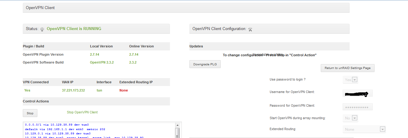

peter_sm:
As I mentioned in my PM, I'd like you to take a look at the attached plugin-in.  Some screen shots are attached.  Fixed the stuff that we have been exchanging posts on for the past couple days and added another feature to show current host and location.  I don't use the extended routing or simple features so those hooks are not tested.  Fixed the writing of the ovpn file by relocating the '\n', fixed the connection issues requiring two clicks to start it by incorporating the longer sleep times you implemented and also did some reordering in the connection process, and fixed the stop issue by ignoring the pid file captured at start and going more direct since openvpn can restart on it's own and change pid.
  • The left picture is disconnected status showing the host is my local Internet provider.
  • The center picture is connected to a Chicago VPN server  (no errors in the openVPN log)
  • The right picture is connected to a Belgium VPM server.
I really like the addition of the Current Host and location that you made. Very helpful. When you are changing your Hosts and locations are you just putting a different .ovpn file in you openvpn folder?

Correct - just a different ovpn file for a different VPN server available from my VPN provider.  The host location and flag display is determined through a curl http query that way you know for sure if the VPN is connected or not and who you are connected to.
Thats perfect. It would be great if there was a drop down that had all of the ovpn files an we could just select one from the UI.
